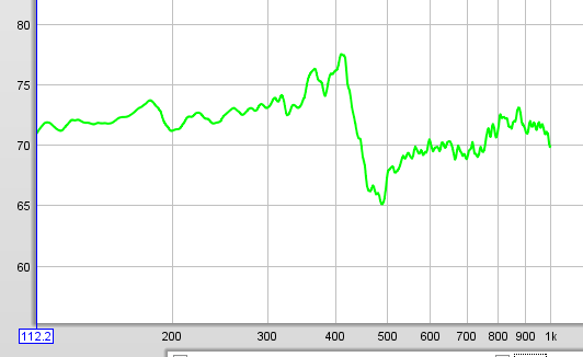

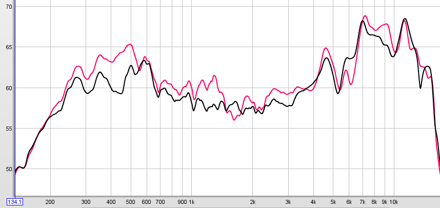

Just quickly, here is that peak-dip feature I was talking about that also shows up in my martin logan woofer. (green curve) It's just asking to be fixed with a high-q high-shelf filter 🙂 I'm thinking this must be something intrinsic to cone drivers, but I haven't looked into it. Maybe some kind of resonance or mechanical mode.
Red curve is on a 18"x24" open baffle. The dip is not that bad.
I forgot to mention that I can affect this feature by selectively putting blobs of clay on the cone. (black) It can flatten that dip right out.
Do you have a closer than 1m measurement of this driver on an open baffle? I noticed that both the dip and the HF spray are worse when the mic is closer.
Thanks. Try 15cm, 1/48th octave smoothing. Also please try measuring the BACK of the driver, near the vent holes of the spider (if the speaker is mounted on an open baffle, otherwise, never mind).

The green curve looks more like reversed polarity is the problem.
Why would reverse polarity cause a dip in the freq response? I know it can flip the sense of the impulse response.
That's a single driver measurement.
I use a similar thing on my Eminence 12Lta's - I read BudP's 'EnAble' thread and papers, failed at the tap test.....
He says that the further out the cone diameter you enable the more it affects the 'Highs'.

At what mic distance is this, baffle size? Can you post the phase, GD and impulse?

Yes, that green curve with the peak-dip at 400Hz IS the martin logan.
As to your questions, are you referring to the martin logan, my speaker in an open baffle, or in the spiral box?
