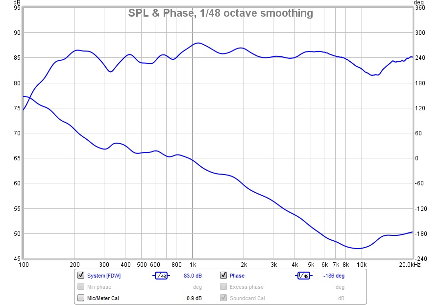

What causes this peak-dip in frequency response?

That dip in measurement is probably artifact of mic being too close. Measure at 1/2m or more and it will be fine.

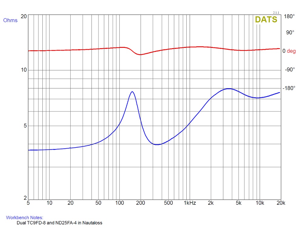

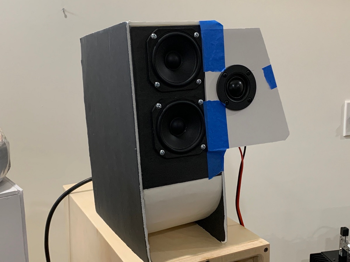

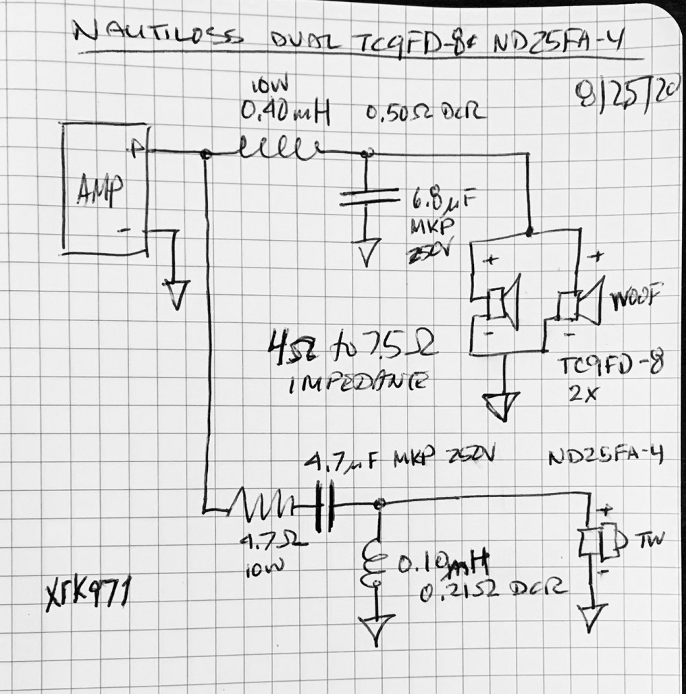

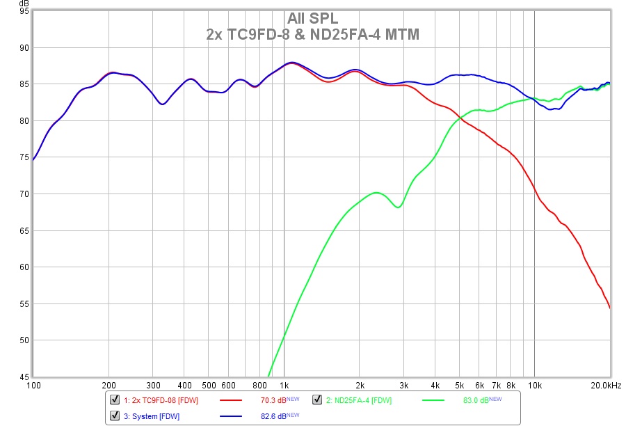

Nautaloss MTM mod
I made an MTM out of this speaker with a simple XO and inexpensive Dayton ND25FA-4 dome tweeter. More about it here:
MTM with TC9fd
impedance is 3.5ohms to 7.5ohms:
MTM with TC9fd

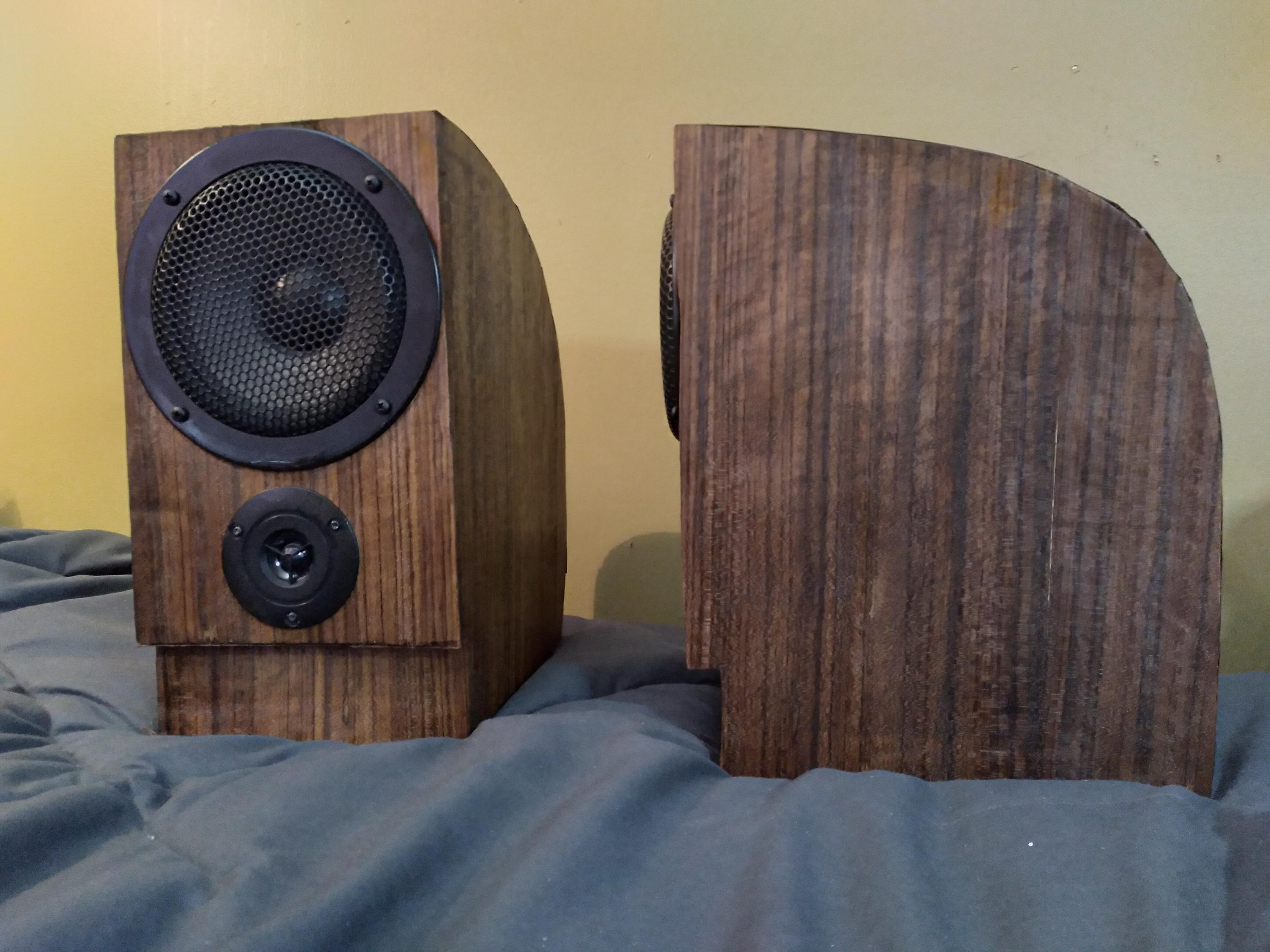

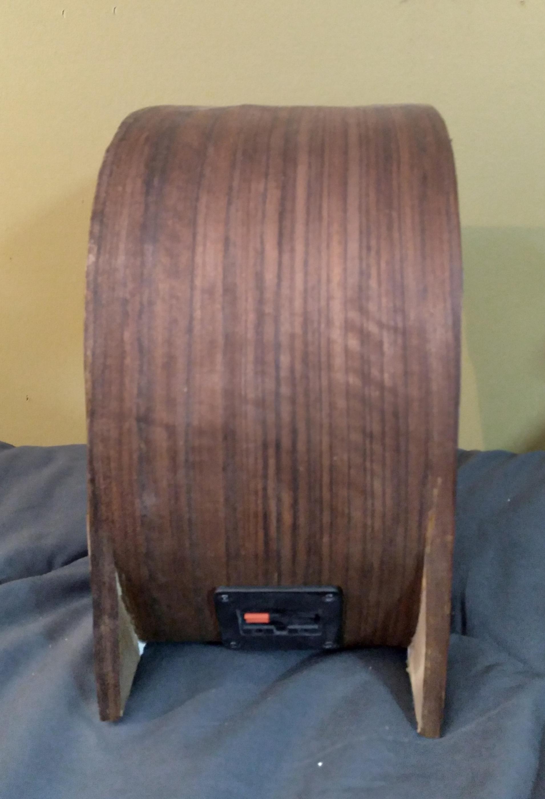

Xrk, you mentioned in the mini-karlsonator thread that it would be nice for someone to veneer a foamcore speaker. Well, here's my Nautaloss I. I used the 6.5" buyout speaker from PE and a small tweeter, and the veneer is Mozambique I stained walnut. The bass is outstanding, and these are my main speakers now. I use mini-karlsonators as side speakers. I'm a 75-year-old ex-F-15 mechanic who has loud tinnitus at about 8kHz, as a result of being unable to put on my ear protectors in time when an F-15 would be run up to high idle next to me, so the 8kHz is my upper limit of hearing now. Oh, well. I hope you like them.
Jaxboy,
Wow! Those look great. The 6.5in PE polycone woofer is an excellent sound driver. With sufficient volume in the rear chamber it gets 50Hz and is sealed for a tight defined bass. Sorry to hear about your tonight from job related injury. F15 mechanics are way cool. There is so much technology there and you got to fix or rebuild $30M jets. Very cool.
