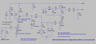

I implemented a variant of the first circuit shown a couple of posts back, the only difference of note is that I used a 0.22uF capacitor rather than the 0.1uF capacitor I specified, this pushes the -3dB point down to 0.7Hz which means that there should be no phase shift of note within the audio passband due to the addition of this change.
Predictably I am going to tell you that the quality of this capacitor is as important as any to the overall performance of the phono stage, the saving grace is that you can use a 100V part here if you can find one.
Note that I changed the value for C1 to 0.33uF as this will further flatten the LF response, however the original 0.22uF will provide adequate performance as noted earlier in the thread. (Large film caps are expensive)

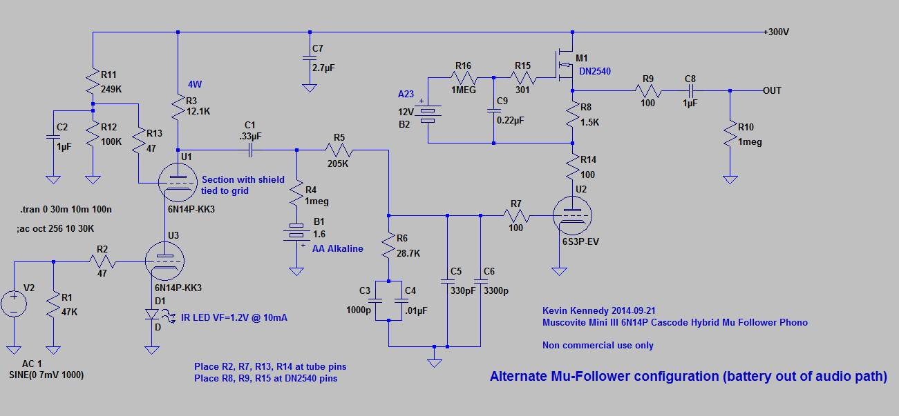

See information on the cascode front end. Note that there are a number of good operating points, I chose this one to take advantage of the IR LEDs on hand. Good operating points can be selected with effective input tube biasing in the range of -1 to -2V, as bias voltage goes up plate current and transconductance both drop for a given plate voltage as you'd expect.
Hey Kevin, I was breadboarding the 6J9P version but since a dozen 6n14p tubes arrived today I'm thinking about just shifting to that (this!) version. But I'd hoped for more like 48-50 dB or so from this amp. You mention in the image attached to this post (post 11) that increasing B+ and the load resistor will increase dB (from the increased voltage swing I assume). How do I calculate the dB increase from any change in B+ and the load resistor so that I can adjust to that overall gain?
Edit: just did some more thinking about this and I'm backtracking and thinking 45-46dB would probably be fine. Still, as an exercise, I'd be interested in learning about how this works.

Given how you are powering the unit you are not going to have the voltage headroom required to increase the gain to the levels you suggest you need with the 6N14P which require a doubling of the plate load resistors in the first stage.
Using the output stage follower version that I came up with will net you several additional dB of gain and significantly close the gap. You already have those details. (See post 81)

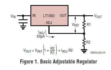

I've built the LT1084-based heater circuit and tested it. I'm getting about 6.47v out of it. Three questions. First, what is the target voltage of the circuit? I'd expect 6.3v for the tubes but based on the data sheet it looks more like 5.3v (from R = R2/R1 x 1.25 - note R2 is actually R1 in your circuit and R1 is your R2). Are you running the tubes a little starved or is something else going on with the diode present? I measure the resistance between the output and adjust pins at the moment at just about 100R, which makes puts formula at 6.375v.
Second, I know too much voltage can reduce tube life, so is my voltage likely to be a problem? The 6S3P says max heater voltage of 6.6v and the 6N14P says 6.9v, so I'd think it would be fine, but my experience is pretty limited. Note line voltages don't appear to vary very much at my house.
Second, it seems like as R1 in Kevin's schematic (R2 in the generic LT1084 schematic) decreases, the output voltage should also decrease (it's the numerator). Kevin calls for a 510R resistor in that position. I measured mine at 503R or so, so I expected my output to be lower than the target. As it happens, this lower value is still putting my voltage considerably higher than the math would suggest. Any thoughts on why that would happen.

Target voltage is 6.3V. Correct equation is Vout = (R2/R1 + 1) x 1.25 which with the given component values results in a calculated output voltage of 6.39V. Using 1% tolerance resistors and assuming a ref voltage tolerance of 1% an RSS of these values gives +/- 1.7% tolerance on the output voltage or 6.28V - 6.49V, well within the acceptable range. The ignored Iadj will scew it in the direction of slightly higher voltage. (Did not calculate)
Note that I ignore Iadj at these current levels as it represents an error of <0.5%.. See below for full equation from the current LT data sheet.
