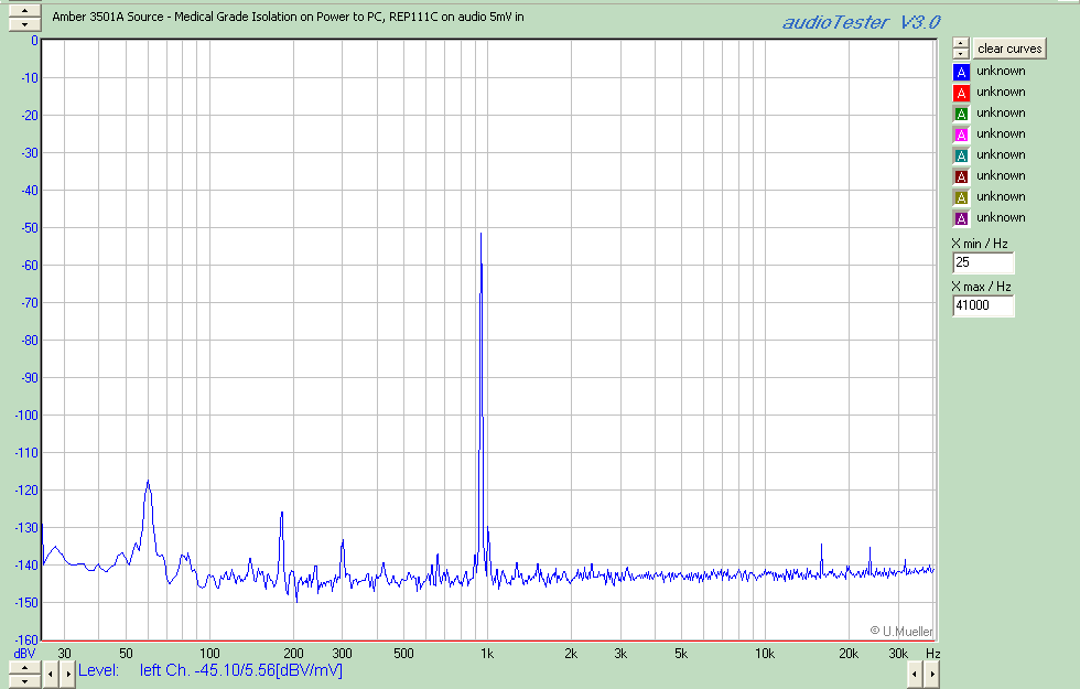

I've been working on further improvements to my PC sound card based audio measurement system and am making some progress with conducted noise, ground loops, and radiated RF which was present even with the PC shut off. The system is based on a Win XP box (mostly not connected to the internet) with an M-Audio 24192 sound card connected via Western Electric REP-111C repeater coils (telco talk for broadcast quality 1:1 isolation transformers) and tonight I decided that the whole thing should be powered off of a medical grade isolation transformer. (Everything remains safety grounded) The Pete Millet Sound Card Interface is modified to in order to fix so low frequency CMRR issues, is electro-statically shielded and fitted with selected line driver and receivers.
All of this is so that I can more accurately (and less embarrassingly) measure my designs and share the results.
See below.. The source is my Amber 3501A, grounding is external through the Amber, the signal level is 5.56mV at just under 1kHz. (I should have adjusted it, but not critical for these purposes.) Units are dBV.. There appears to be a 6dB amplitude offset error between the FFT and the amplitude measurement which I need to investigate - probably a configuration error I made in the software.

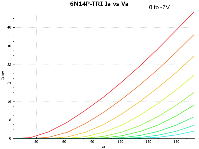

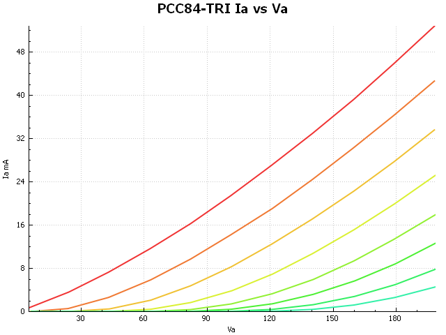

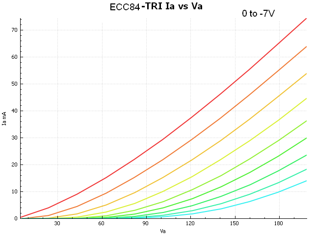

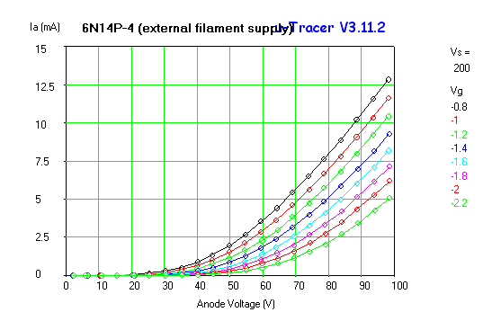

Some preliminary curves and tube models for the 6N14P and ECC84. The models and curves were generated in uTgui and represent the performance of a single section each of an unselected bogey device. I will post additional models when I have sense of what a representative device looks like parametrically.
These were unselected devices and I already know there is fair amount of variability of transconductance from sample to sample. (This is true of any unselected tube)
Note that I am running them with a bias of -1.2V effectively which seems to be a good place to operate them based on the curves. I believe that 2V may also be a good operating point, but anything much above this seems to be heading towards variable mu operation. Unfortunately I suspect this might not make such a good line stage tube...
It also appears that the ECC84 in cascode might realize a couple more dB of gain which is what the Philips data book based model I grabbed from somewhere on the net also predicts.
Interestingly the PCC84 performance aligns pretty closely with the particular pair of 6N14P currently installed in my phono stage. This might be the closest device of the lot I have measured so far. (Note I reduced the number of traces to 8, and the range is 0 to -7Vg)

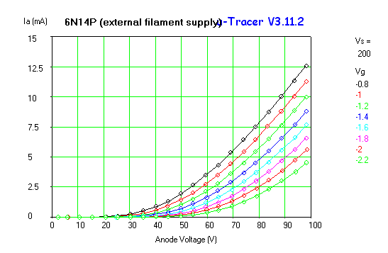

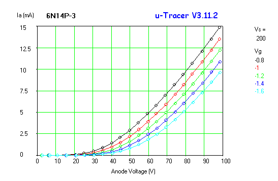

Kevin, maybe it's my eyes or the scaling, but your measured traces seem to highlight the variable mu character more than the Soviet datasheets do. An interesting question perhaps: what parameters make for good performance in a cascode circuit and are they any different from what is required for good linearity in a grounded cathode stage? If the upper cathode were fixed it would have to be constant gm for a fixed anode voltage but the upper cathode is not tightly constrained. Your actual distortion measurements show that 6n14p makes an excellent cascode. I wonder how ecc89 and other undesirables might perform.
Hi Nicholas,
I have some better curves not taken with uTgui which is what I use to generate models, the Vg range is pretty wide, and given some software and hardware quirks in conjunction with the fairly steep transconductance characteristic of these tubes, small errors in grid voltage will scew the graphs making things look worse than they are. (This does not affect the models since all the variables measured are directly used to generate the model. There are other issues with the models lol) Note that at higher bias voltage values they do really appear to be variable mu, but given the signal levels present at the input, and the operating point chosen, they will never operate outside of their linear range. (This is sort of why I chose to use a 1.2V IR led for biasing)
I am running them over a very narrow range where there is no variable mu tendency at all (-2V and below), linearity measured quite well and the composite curves look pretty good in the data sheet.. I could actually do a composite measurement at some point.

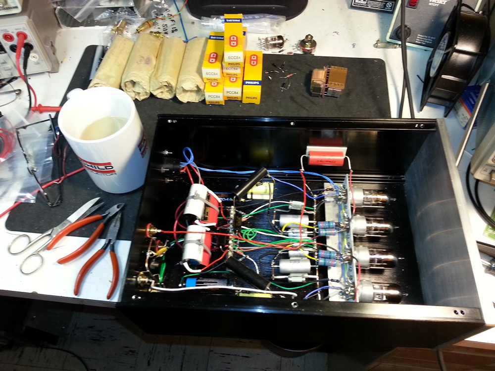

This morning while imbibing a nice hot cup of tea I installed a set of Mills MR-200 12.1K non-inductive wirewound resistors in place of the series string of 4.02K Roederstein MK-8 load resistors on the cascode, I expected at worst to be ripping them out shortly after listening to them, and at best concluding I wasted my money. In a perverse twist of fate neither of the above conclusions turned out to be true.
I'm am not sure why exactly, but they were a pretty audible improvement over the MK-8, the highs are considerably cleaner sounding. Given the comparable cost (fairly cheap actually for the level of precision) I guess I will just go with them..
Since this design uses absolutely no feedback it comes to me as no surprise that passive components are audible to some extent in some locations in this design. Things like voltage coefficient, excess noise, and nonlinear termination behavior are all relevant and measurable at least under some circumstances.
Next up is to evaluate the ECC84 MKC sent me recently. I suspect the gain will increase a couple of dB, otherwise performance should be similar. (good for this application)
Anyway here are some more pix..
I should mention that eating and soldering is a NO NO.. Drinking tea is frankly questionable, but I'm not putting my lead covered fingers in the cup or my mouth so..
I just switched to Cardas silver solder, happy to report the flux is much less smoky that either Kester or Wonder.

If you like smoke and fumes, try Cardas rosin flux paste.😀
jeff
Hey Jeff,
I have a vague recollection of having used some a while ago, very acrid smoke. Rosin in general is pretty obnoxious whether in paste or liquid form, both before and during soldering, and boy is it sticky if you get it on hands or clothes. Fluxed solder must have been quite an innovation when it arrived on the scene long ago. 😀

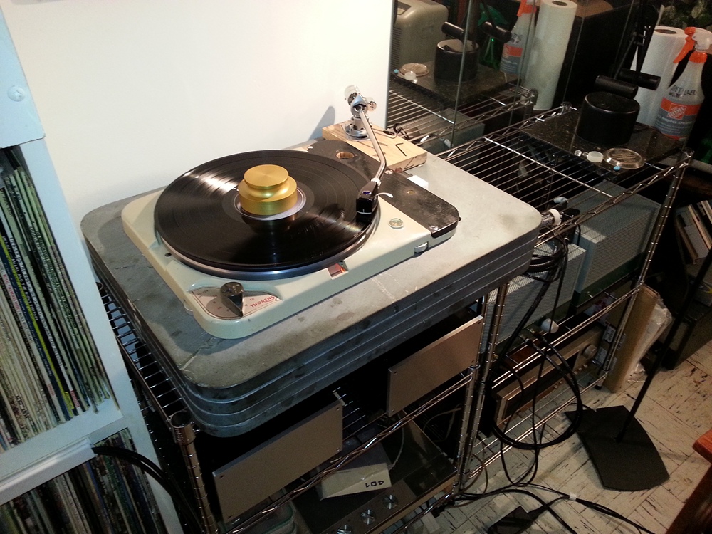

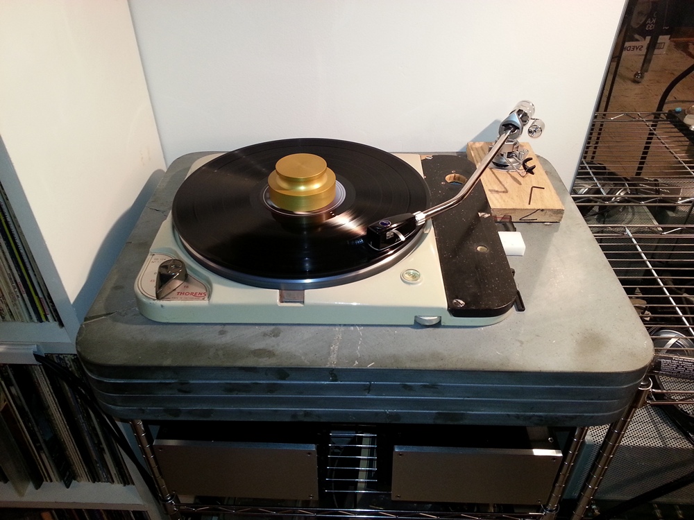

I made some changes to the TT late yesterday - kludged my clone 3012 onto a plinth not intended to take it. I'm not sure all is well and will be taking things apart shortly to have a look.
Since we have been talking about some apparent variable mu behavior observed in the uTgui curves (could be other issues since this is beta software) I have some additional curves taken using the uTracer software and on several different 6N14P over a range of grid bias voltages which I think are within the useful range. These all look quite well behaved.
Fixed the arm mounting issue and was able to tweak things to the point where the protractor is almost happy. A whole lot better than before..
The first two are the table that the Muscovite Mini II is connected to (you can see it), and the third is the reference table which is connected to the Muscovite. SPUs on both tables, the Royal N is on an AT Technihard head shell.
