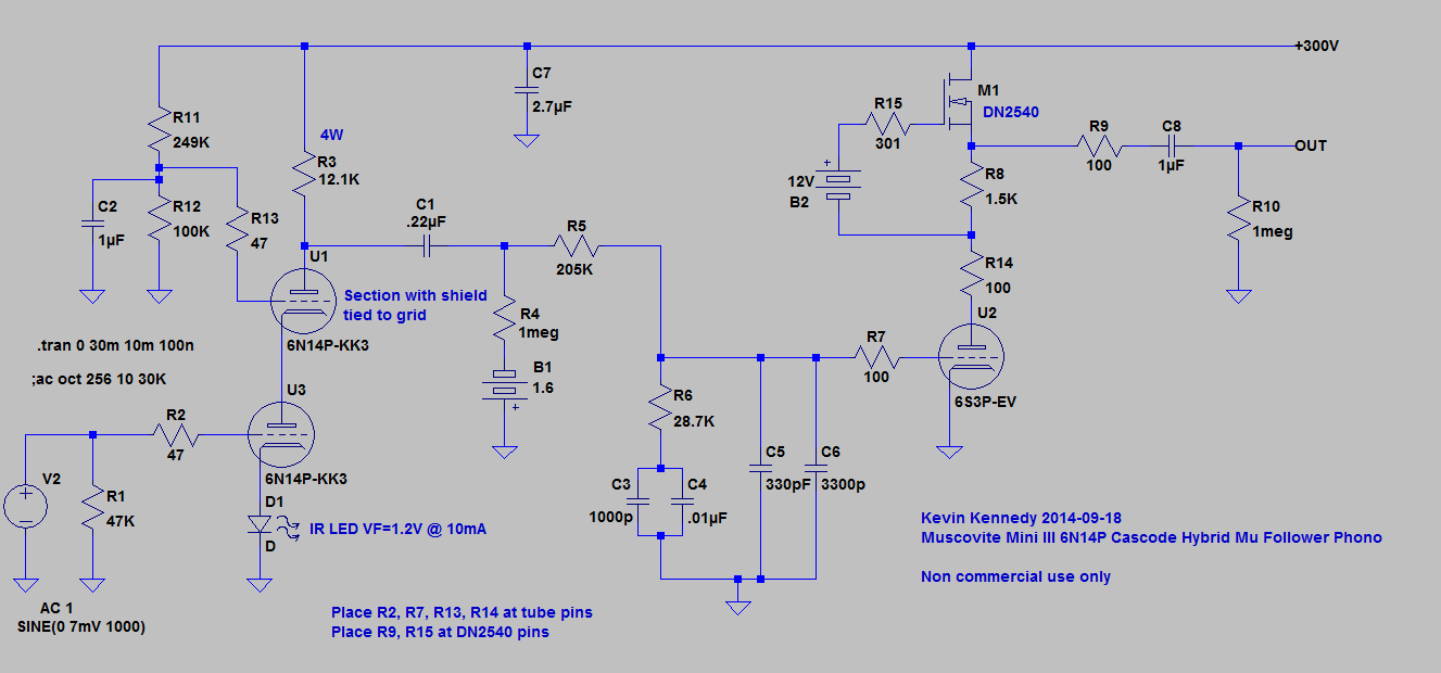

Hybrid Mu-Follower Output Stage
I decided after living with this phono pre for something close to four months without significant changes that if anything I wanted to further close the gap in performance I perceived between this design and the Muscovite.
One thing that has always bothered me is the resistively loaded common cathode output stage which does not have particularly low output impedance, close to 4K in fact.. Not much margin for driving cable capacitance.
No room or budget for an additional tube per channel given the intended audience, however the Supertex DN2540 is not expensive (1.56 each two days ago) and while its gate capacitance is high, it is a great deal less than the cable capacitance this pre-amp has to drive.
Since I have penchant for weird circuit design I came up with a battery biased mu-follower, which upon first inspection looks more or less like an SRPP. (It's not and the key is the battery and source resistor..) Operating current is about 9mA - 10mA dependent on the individual fets used. (Not critical)
Output impedance drops from almost 4K to less than 150 ohms so design goal is met. Gain increases by approximately 2dB which is welcome.
Somewhat drier presentation, slight increase in low level detail. I have not done any distortion measurements, but I would not expect very significant changes.
Note mosfets are very prone to oscillation, note the gate stopper, source resistors, and locations, note added resistor on plate of 6SP3.
Edit: Added bias battery is an A23 12V alkaline.

Yeah, a hybrid mu-follower is a bit of a departure for me. I'm not entirely comfortable with it, the performance is promising, but as always there may be issues I will identify in the coming days. I think the turntable itself (my second TD-124) and clone SME arm may be having a bit of an issue. Not yet sure what is going on, but I was hearing a bit more sibilance than I am used to out of that set up, of course my point of reference changed. The A95 on the other table is pretty much unfazed by anything compared to the Meister Silver or Royal N so that could be it.
I've used SRPP in the past, but now tend to avoid them as they are not the most linear choice.
The additional gain that a 6S3P provides in the second position is much needed otherwise I could have considered a 6DJ8/ECC88 or similar - that tube might make more sense in the first position and would provide a significant boost in gain.
Unfortunately due to the nature of my room, the Mini must drive a minimum of 3m of interconnect cable, and currently is driving about 3.5 meters of cable - there is no solution to this. Worse many years ago I designed a budget phono stage which performed very well until I started to show it around and the testers ignored my admonitions to use low capacitance and short interconnects - the consequence was disaster. Now I try to design stuff that will drive a lot of capacitance, but the simplistic common cathode stage in this design was not cutting it on this parameter, unlike the low rp of the somewhat similar 5842 the 6S3P is around 5K.

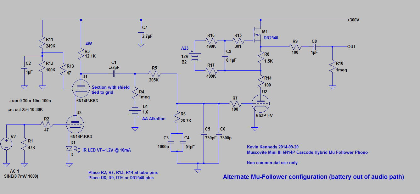

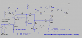

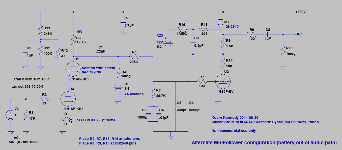

Revision to remove mu-follower battery from circuit path.
Provided for those who might object to signal current following through the bias battery. I am not sure at this point whether or not this is a worthwhile change - have yet to evaluate it, but it strikes me that a good quality film cap may be better than a battery in terms of interacting with the signal.
Version 2 isolates the battery and its capacitive coupling to surrounding chassis, etc., from the audio path while providing the required DC bias for the follower.
A fiver says the cap wins.

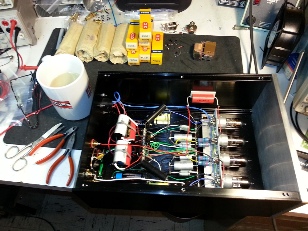

Pictures, please.
See posts # 17, 28 etc.
Which incidentally made me relook at some pics just to spot this:
Note how Kevin turned the mug so it's hard to spot it was offered to him by Fairchild.
And that whilst soldering a tube circuit....No wonder then he finally succumbed to using a solid state CCS......
Drinking tea is frankly questionable, but I'm not putting my lead covered fingers in the cup or my mouth so..
