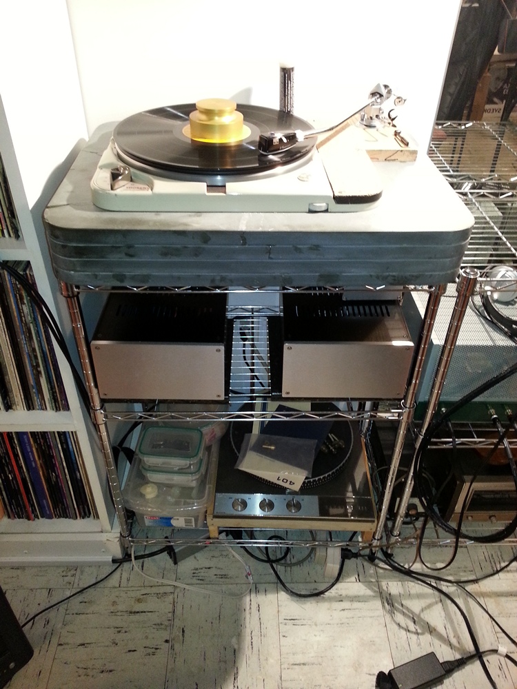

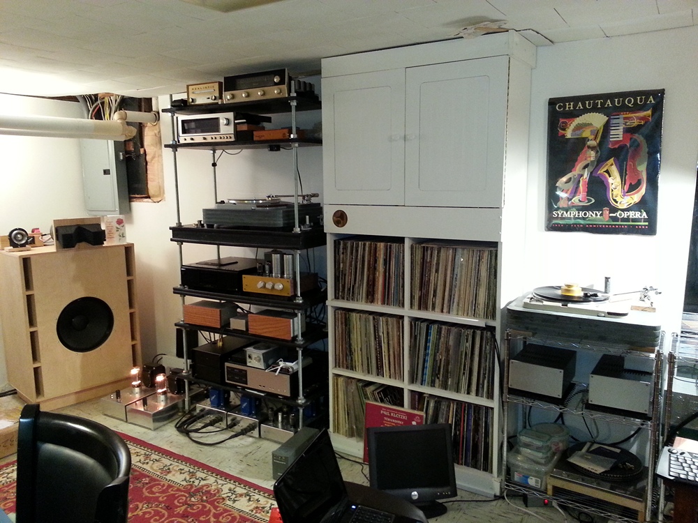

Piano3, yes both of my plinths are slate, complete with turntable and arm weigh about 100lbs or 45kgs.. There are 4 layers of 2cm each, the two top cut outs are the standard TD-124 pattern while the lower two have more material left in place to increase mass. I run them layer on layer, but I could at some point go to a constrained layer setup with bamboo, cork, hard rubber or sealed lead. The plinths sit on large hard rubber corks which work quite well as feet for a fraction of the cost for anything intended for the duty. 😀

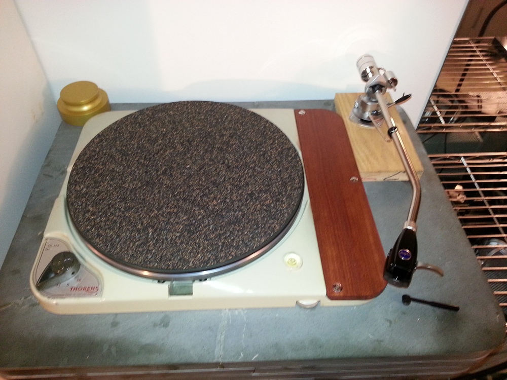

I have complicated matters by changing arms although I have never made more than one change at a time. I have had some difficulty dialing in the new clone 3012**. I think overall things are improving, but there are a few warts here and there that I can hear - slowly knocking them down, so far nothing demonstrably related to the phono stage design, but you never know. There is some HF hash I am trying to figure out - think it is worse since I changed the arm. Geometry looks pretty close to spot on at this point. I will say there is a good deal more detail, and that while this set up still lags behind the other table and the Muscovite, the gap is smaller now.
(**Issues with VTA, azimuth, geometry.. Pretty much anything worth thinking about. Things are looking closer to optimum and of course the improvements are audible. This is the first arm I have built so I am learning to take nothing for granted. Even had problems with the interconnects from the arm to transformers - 4th iteration is sounding about right. I guess it would not hurt to mention how tough that SPU is, I'm having a lot of klutz moments which if I did not know the cause would be worrisome.)

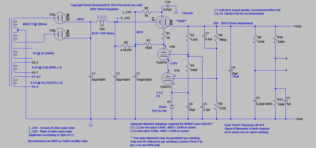

For those who don't know it the power supply and filament supply for the Muscovite Mini II are exactly the same as I used in the Muscovite Mini. I recommend a stereo supply as I implemented.
Here is a revised schematic showing what I did in this supply with the exception that I have two separate filament windings for the 6W6GT pass tubes.
Note that only a single power transformer and rectifier is required and two is probably beyond the realm of reason for this design.
The filament regulator is one of the dc regulators advertised on eBay as having a 40uV output noise performance. Probably not that good, but it is good - well under 1mV - I measured 200uVpp on one of mine. This is quiet enough I think. I used a 50VA 9V toroid and a conventional bridge rectifier into a 22000uF 25V electrolytic and directly into the regulator. The supply is floating, but not elevated. There is a pair of 330 ohm 1/2W resistors to audio ground (potential divider).

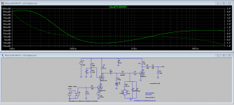

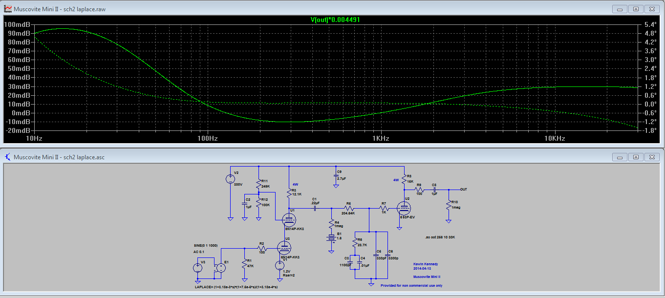

My dabbling with Mills MR200 is at an end, I have endured several weeks of some fairly nasty sound which was strongly confirmed to be phono pre dependent tonight when I swapped the Mini II for the Muscovite with the better TT and ended up hearing pretty much what I was hearing in the other set up. I would describe this as hard, nasal, fuzzy and murky sounding all at the same time - sorry for the subjectivity here, but that is the best I can come up with. (I was wondering if I had somehow damaged my Meister Silver cartridge or was having an arm problem - hence the swap out. Happy to report the pre is completely to blame.)
For the moment the Russian Micas and Teflon EQ caps shall remain, but I am thinking that conventional polystyrene or polypropylene may prove to be a better combination and will try some soon. I'm not finding most Russian parts to be my cup of tea, this seems to mostly not apply to the tubes however.
I am now using 40yr old 13K 1% 2W TRW glazed metal film milspec RN75 resistors in place of the Mills and the things sound a lot more right. I've lugged piles of these TRW resistors from place to place for 30yrs now, guess I will never run out.. lol
Compared to the Muscovite this design is quite a bit less dynamic in a direct comparison.
I removed the 1000pF micas across the 0.01uF and replaced them with a series pair of 2200pF 5% teflons. This resulted in a significant improvement in sound quality and the RIAA EQ looks pretty good with selected parts.
You can change R3 from 12.1K to 13.0K with a very slight increase in gain, if you do so R6 should be 200K + 3.01K - 3.32K in series. This could net you better than +/- 0.1dB RIAA with very carefully selected parts.
Shouldn't that be 20K instead of 200K?

200K plus a small trim resistance is the correct value for the network as implemented. The reason I went with a relatively high network impedance is that the load impedance reflected back to the first stage is frequency dependent, and given the high source impedance particularly with the original pentode based front end measurable gain modulation occurs in the first stage, which just serves to make the EQ a little less accurate. The noise hit of a couple of dB is not the limiting factor in circuit performance. This is actually a very quiet pre-amp. (measured and subjectively)

First I just wanted to report that I replaced the remaining pair of Russian Micas (330pF) with a pair of Siemens 2% 330pF 160V polystyrenes with a pretty significant improvement. Overall cleaner presentation...
In terms of how I do my equalization I do try to take into account all of the possible interactions both with the driving stage and the succeeding stage. Since I don't intend these designs to be one offs (what I intend and reality may not match.. 😛 ) I try to design things so that parametric variations tube to tube and over tube life have minimal effect on the accuracy of the RIAA, not to say that there is no effect of course.
Interesting and unfortunate that you run into that attitude, I've been fortunate not to have really encountered that level of cluelessness - as you know designing really good phono stages is the culmination of a great deal of understanding and experience. I was designing good power amps long before I designed my first good phono stage. Always something new to learn which is why I have tried so many new things lately.
Not to be snarky or anything but I have heard so much bad sound (most especially at high end shows) in recent years that I am not surprised that there is little appreciation of the effort required to design a good phono stage let alone anything else. Stratospheric prices for things designed by people who can't engineer their way out of a paper bag, of coarse this is not even the whole story since we are interfacing with human senses. The lack of respect for science and engineering, and a certain arrogant self-assurance these days seems to play a large role in this. There must be a reason why many of my friends are engineers, scientists or makers.. (Not to mention the fact that no one else seems to have a clue about what I am chattering about a lot of the time..)
It's been a while since I looked at this thread..
