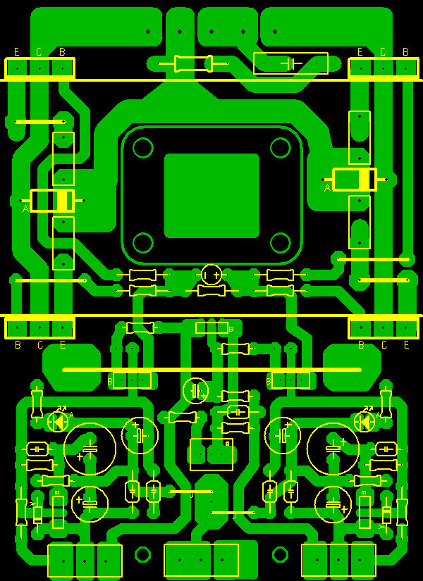

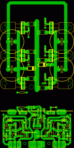

At the initial startup , all OP's were at 15mV (65ma) , after heating... front went up to a full 100ma, back to 50ma (2 to 1 almost). I am not biasing the drivers hard (150Re) , but they are quite likely the contributing factor. Nikko had the drivers on (smallish C shaped - tiny) separate heatsinks. Just the Vbe on the front heatsink only.
Luckily , I am real good at PCB work... 2-3 hours to correct this little issue.
(new board below) It is worth it , I love the sound of this amp.

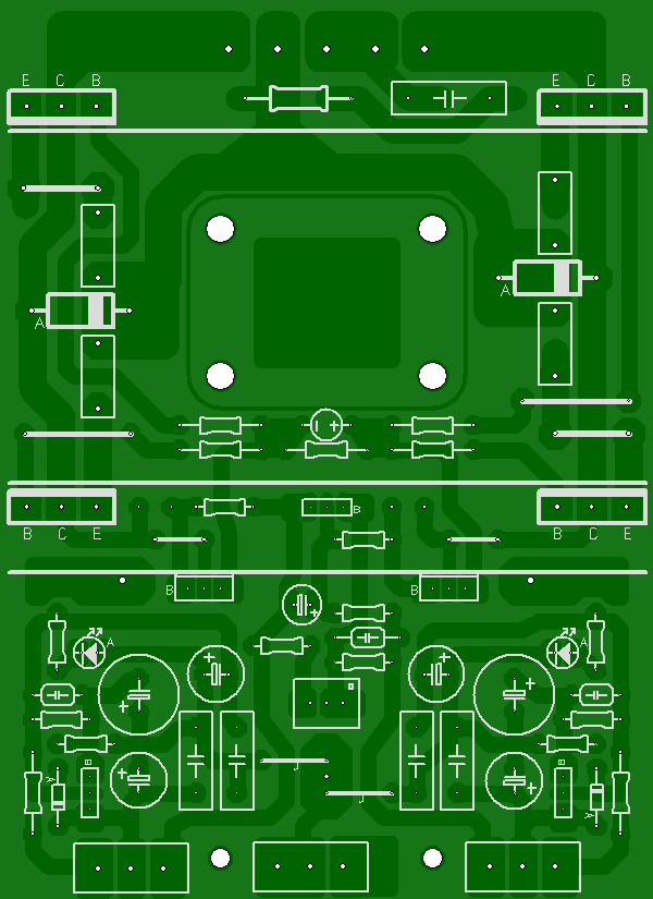

ONE FATAL FLAW 😱 🙁🙁 having the drivers on just one of the heatsinks makes the front heatsink bias harder than the back one (the one without the drivers). I will etch 2 more boards with the drivers on a brass plate in front of the outputs.
Amp will thermally stabilize , but with the front OP's biased twice the rears 😱 . Drivers are adding to the Vbe.
The boards are almost redesigned (below 1) same circuit (IT'S PERFECT) ,just an anal "thermal issue". Another chapter in R/D. 😱

I have researched the thermal requirements of the drivers and found that at 220Re (6.5ma idle) the heatsink can be quite small . look at the Leach amp (220Re) with its real small 16C/w HS's. the nikko was no different with
6-8 sq. cm "U" shaped OEM cheeepo's. 🙁 ASKA 100's use 40 X 40 mm copper squares and a lot of HT OEM's use NOTHING. My 150Re idles at 10mA and will have to pass 200ma on transient loads. My guess is that 4-5 C/W for both (a 25 X 100mm aluminum strip) will be more than adequate.
I did use 2- 12C/w's for the drivers on my "supersym" , they became slightly hot (40C+) with 4 pair OP and heavy load.

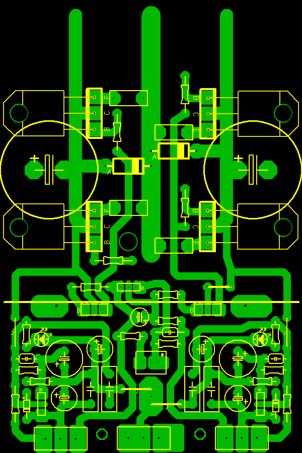

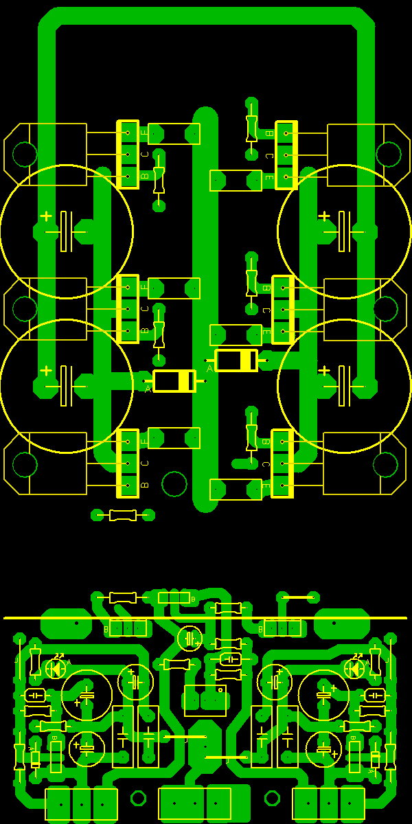

We need a good power board to go with them (below 1) is mine and (below 2) is everyone elses (NEW pb120). Same cap MUX's , more room for bigger caps , "compact MUX" (1 sq. inch per mux) I almost have" below 2" done. Size wise , I really don't think 4" X6" (100 X 150mm) is too big. Too many boards at DIYA have too many OP devices.. too close together 🙁. In the real world this is not ideal. I am going to pack this board with 4 -32mm power supply caps so all one would need is a bridge and trafo 🙂 .
I also will do a PB300 SUBWOOFER board (still 100 X 150mm) , no cap MUX ... but Locanthi triple with mje340/350 - njw0281/0302 (the drivers) - njw21193/94 X 3 pair OP(PB150sub). This will be the next new board I etch.
PS - modules will attach at 90 degree angle and be not much higher than the big supply caps. In total, much less space than standard separate PS/amp (100 X 150 X 100mm square)
OS

On board #2, I see power for all six output devices that are used for one channel; but, where are the other three output devices?

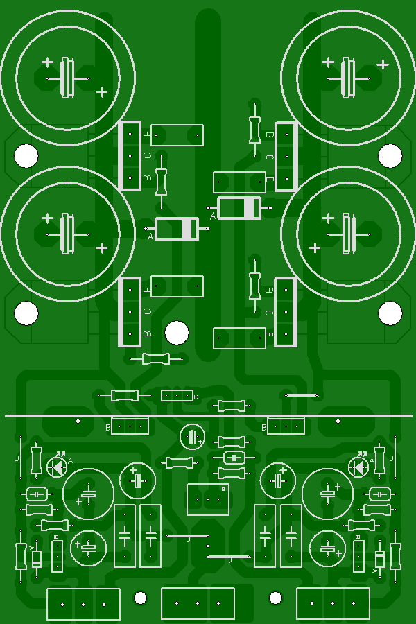

Board 2 only has 4 OP's , same as my nikko. the 6 OP sub amp is not shown (I have not done it yet. The power on board 2 can be either single supply (55-0-55) or dual supply (55-0-55V and 65-0-65V). The jumpers on the cap MUX's let you tie into the OP rails. Universal for those with just 1 supply. (Below 1 and 2)
are the new PB120 & 150. The 150 will be triple and just might be a 200 8R/400 4R amp. The 120 will have 2 -30mm 10,000uf caps and the 150 will have 4- 32mm 10kuf caps .
OS

Oh, I feel blind!!! The 120 is flat mount with 4 op?
Okay, but flat mount will need some air holes. 🙂
What's the recommendable voltage for the 120 with a 4 ohm load? I've actually no intentions for a 4 ohm speaker on this amp, but I'd like to know an "everything works" voltage figure. 🙂
120W "flat mount" does not need "air holes". 😕 OP device die heat-spreaders lie flat on mica/heatsink. All you need do is drill 5 holes ( 1 for Vbe and 4 for the OP's) screw in with self tapping screws. 50-0-50V with 2 - 10 or 12.6kuF @63V caps will work fine for 4R and 8R. For just 8R, 60V+ with 2-30mm 80V - 8200uf caps (better transients/peaks).
The 150 will be a "work of art". 4 big caps right at the OP's (mjl21193/4) , triple op ... the ultimate "blameless". 🙂
