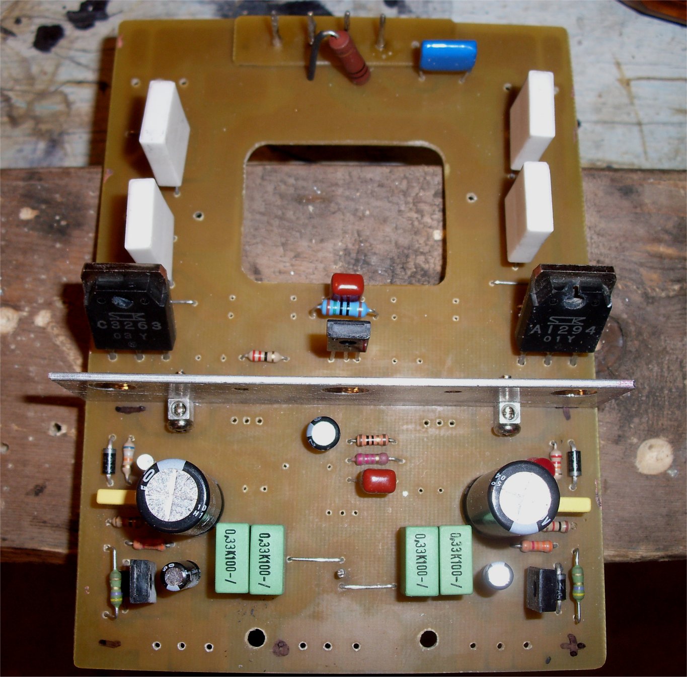

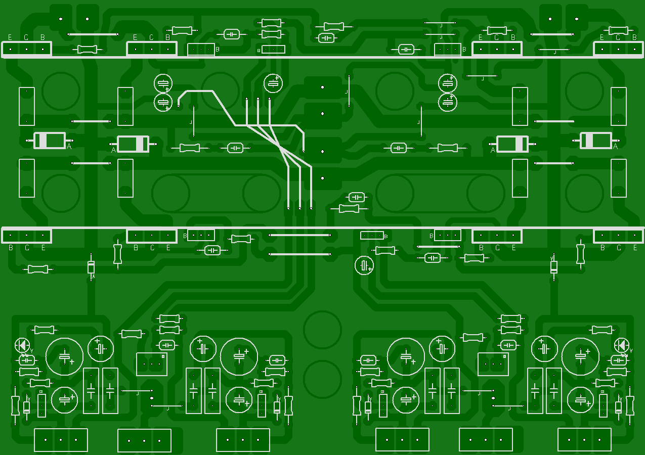

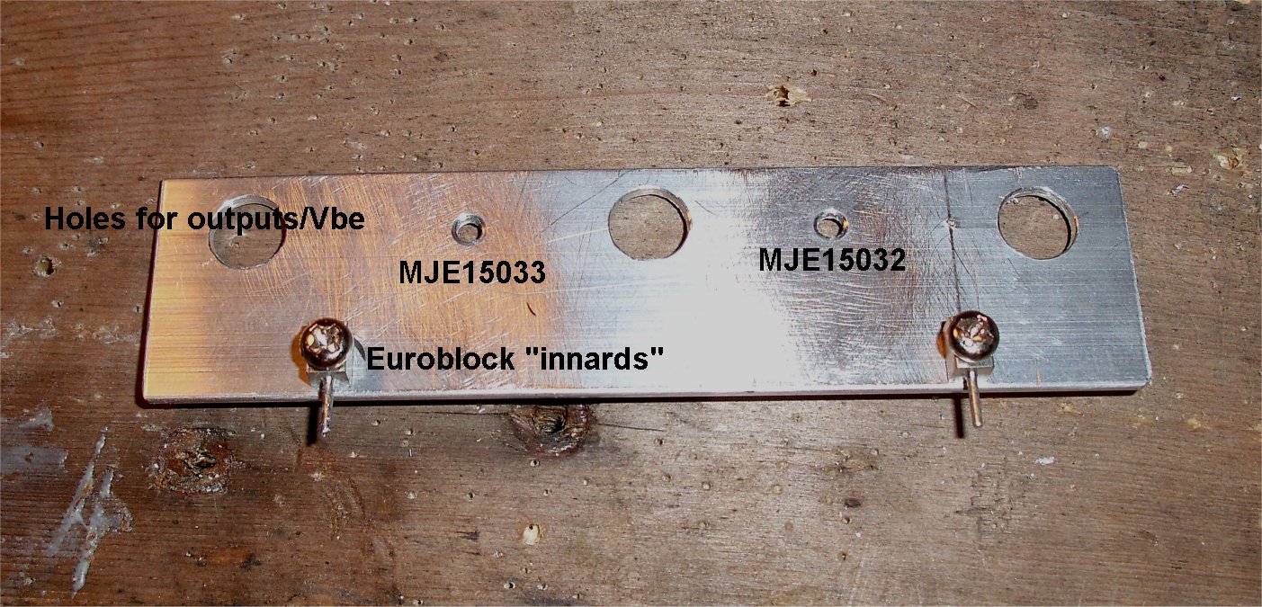

The sprint layout(below 5) fixed "fucup" amp board is done. (below 1) . The driver HS and layout had to take into count the 5 screws (Vbe , drivers , and front outputs. No cap could be in the way , either. Custom driver HS using Euro-terminal "guts" to make it PCB mountable(below 2). The family likes to abuse the "broken" 😀 amp so much they ask me to swap the boards out while they sleep.
Wow .. wow , Classical really "rocks" on this AX ... had to FLAC some new stuff (below 3). I can go right to the rails (240+ W peaks) no issues , even "broken".
Drivers will still be 150/Re (8.5ma) , nikko had 220/Re(6.5mA). Pix 2 heatsink is double area of both nikko HS's combined.

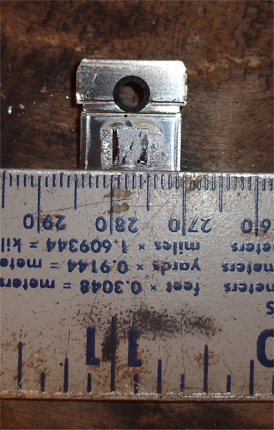

Broke one of the Sanken outputs open (another booboo) , was not a fake (below 4- a 5mm Die). I still have 3 pairs for my triple sub amp , they should do. The ON's are a bigger 6mm+ , that why I am using them for this amp. 🙂

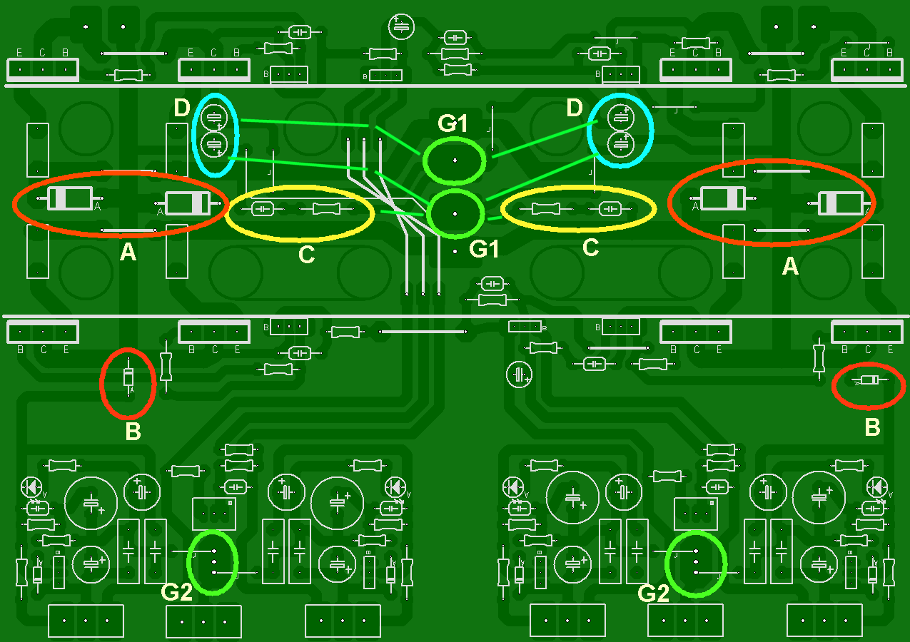

Just as a example of Andrew's statement AND a lot of hair pulling with my Nikko thermal problem ... I will show ideal decoupling / zobel / dual ground returns. (below 1). here I am doing it with 2 complete amps (2 -G1's - dirty earth / 2 G2's - clean earth). The local decoupling can be just 2 10-22uF derated high quality caps if the main rails are short and hefty. 🙂
Below:
A= Flyback diode protection - these DO shunt to the rails. 😀
B= HV supply failure protect - 2 diodes will feed the voltage stage from the main rails in the event of HV shutdown.
C= are the zobel's - fed right to the main speaker/HF "dirty" ground.
D= the 10-22uF local decoupling - each cap must go to the correct amp's G1.
AND there is the separate "G1/G2" grounding scheme.
This amp is down below 125db noise right now - with THIS exact scheme .... it really works. BTW , all 4 G1/G2's go back to a main star. The power rails of both channels are separate and starred back to a "star rail". The other 2 main star connections are from the 68-0-68V supply star and the chassis. Trafo CT goes right to the middle of the main star.

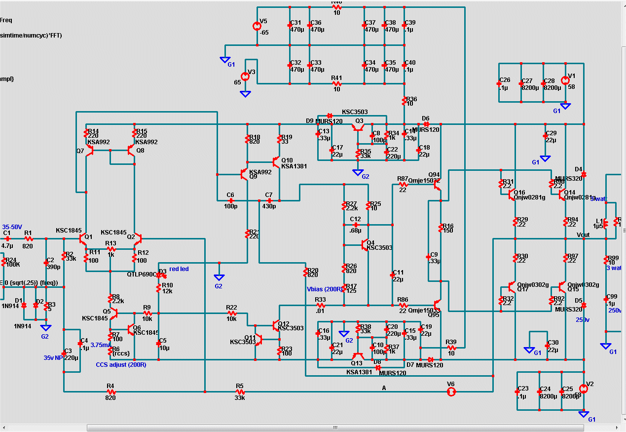

Final schema of the "Big Board" (below 2) A lot of parts on that board. 😀
PS - DWB .... this zobel (10R/.1uF) starts to really attenuate at 800k+ (leaves the audio band alone). 🙂 As far as coupling the Zobel to a rail , consider what would happen during real oscillation ????

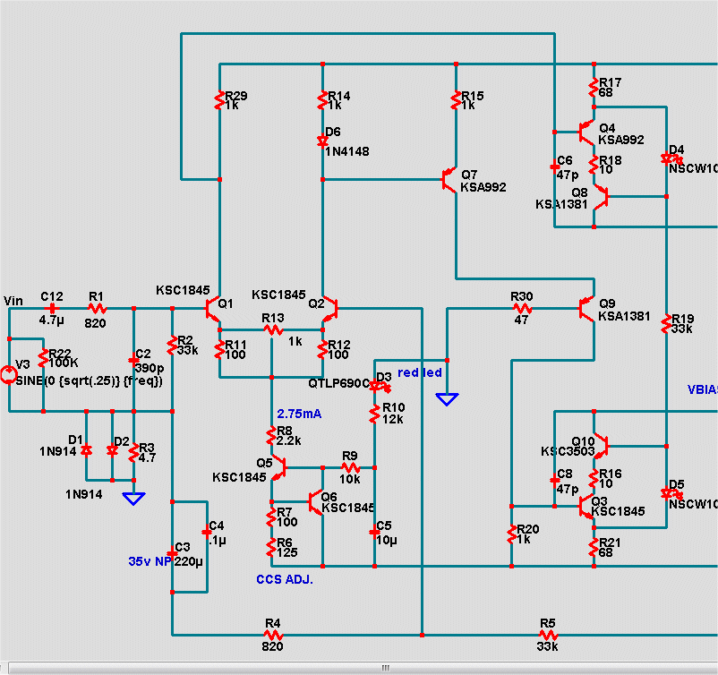

I have come to another realization about TMC and my EF2. version 2 of the nikko does not sound quite as good as version 1. The reason (which I fixed) , goes against conventional reason.
According to Cherry (inventor of TMC) , his amps had the additional "30-50" pF cap between driver base and collector .... shunt compensation. If you look at the linked post below at the bottom , Cherry has come to the same conclusions as I have independantly (I missed that post below)
http://www.diyaudio.com/forums/solid-state/171159-bob-cordells-power-amplifier-book-18.html#post2392376
For some reason without the 47pF's a bit of "magic" is gone from the sound. this must be a very low level oscillation from the driver pair. My 2 new boards... one for the forum and one for me( Below 1 and 2) , along with the complete schematic (below 3) will soon be done and fully documented. The driver issue , turn-on thump, and 2ma thermal stability (any temperature) has been incorporated in the circuit. On this amp , I have taken everything into account - even "psychoacoustics". Cherry's "driver stopper capacitors" do add to the final "flawless" results. It is funny I actually heard this minor issue before rebrowsing the Cordell thread. 😕

For some reason without the 47pF's a bit of "magic" is gone from the sound. this must be a very low level oscillation from the driver pair. My 2 new boards... one for the forum and one for me( Below 1 and 2) , along with the complete schematic (below 3) will soon be done and fully documented ...
OS
I am sure that's the reason, the 47p caps. helps to eliminate low level HF oscillations riding the signal (that's why is important to have a 100MHZ scope on hand ...), mje340/350 are prone to produce such oscillations by it's own ...
Cheers
Arturo
Cherry spoke of the BD139/140 pair. He said they oscillate at 100mhz if driven with over 10cm trace length. He recommended shorter traces and the stopper caps placed within 1cm of the driver C-B. I adhered to this with the above boards for both resistors and caps(and trace length -40-80mm). My modular design forces me to have 4-8cm between VAS OP and Vbe/driver. The Nikko and my JVC BOTH have the 22-47pf caps from B-C on the drivers and long VAS to driver/Vbe traces.
In the post above the addition of the caps prompted the suggestion of "HMC" "hybrid miller comp" . All I know is that it DOES work , even my ears tell me that.

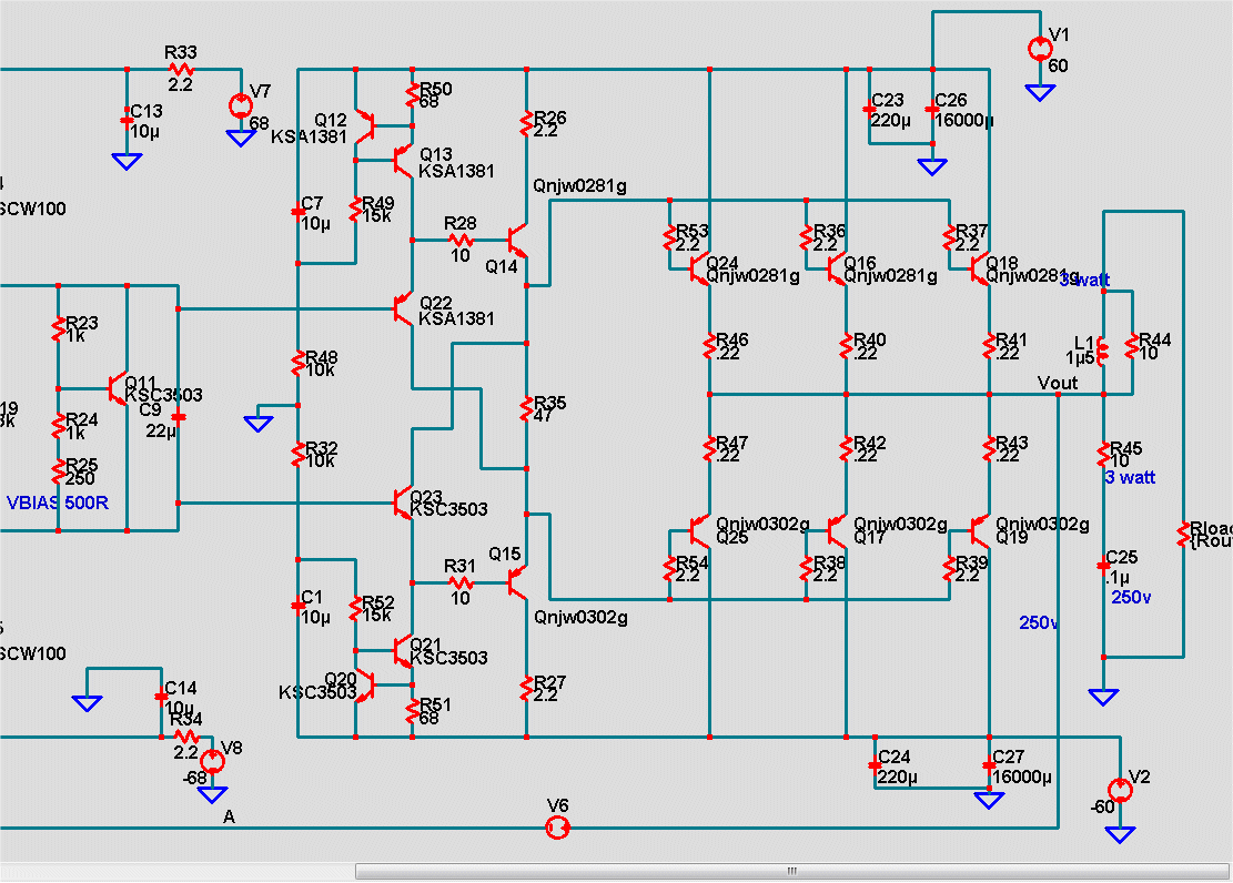

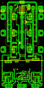

NEW stuff !! LX (luxman revisited)
After drooling over $30,000 luxman "space amps" , I decided to redo my already tested LX voltage board (below 1) and do the "correct" setup and pair it with a triple. I need a sub amp badly. :scratch:
Not any triple ... but B. cordell's "DBT" (diamond buffer triple - below 2). He has it as just a concept in his book , but after rereading my "trouble with triples" thread , it decided to go ahead with the simulation/CAD work. This OP stage just has to compensate one Vbe , will be driven by a hefty output pair
( the drivers = njw0281/0302) , and basically be a scalable "mini arc welder".
I almost have the "DBT" layout done , once I do ... it will exist in the real world. 😎 The LX/DBT combo simulates very nicely (attached) ... in fact , the best non-tmc THD-transient performance I have seen. The PCB will have the cap multipliers , PMA's CFP bias spreader , single or dual voltage (without jumpering) capability.
All these subcircuits have been thoroughly tested both for being "idiotproof" and maximum fidelity. The whole package will be a choice of the AX,EX, or LX. The power boards will be the PB120F (EF2 - simple) and the PB150 (this DBT triple). with the triple scalability , i can just make the board longer , clone OP pairs and make a 10 device 80V rail monster that will not "droop" (or drive 2R loads). 😱
WAIT till you see these !!! 😎😎 No more BS- the performance will be superior.
PS - I won't compromise and use angle mounted PCB's ... WHY ??? The pb150 driving a 4R sub with 3-5 pair NJW21193/4's needs excellent thermal conduction (direct mounting) to have the best MTBF. One could use 2 angles to adapt my board , but what is so hard about drilling 7 holes and using self tapping screws ??? (example board- below 3 ... "DBT" / 3-pair OP)

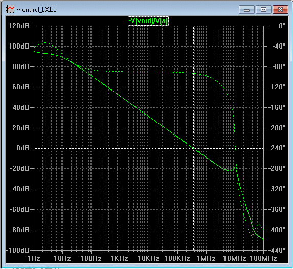

No , but I did now (below) . What is wrong ?? Gain Xover at 375khz w/ 87 degree margin. I did cap. load with squarewave , minimal ringing. Triple is very stable.
I already built the LX and ran it for 4 months , so I know it has no "bugs", besides having a high impedance VAS (needs a triple to really perform).
