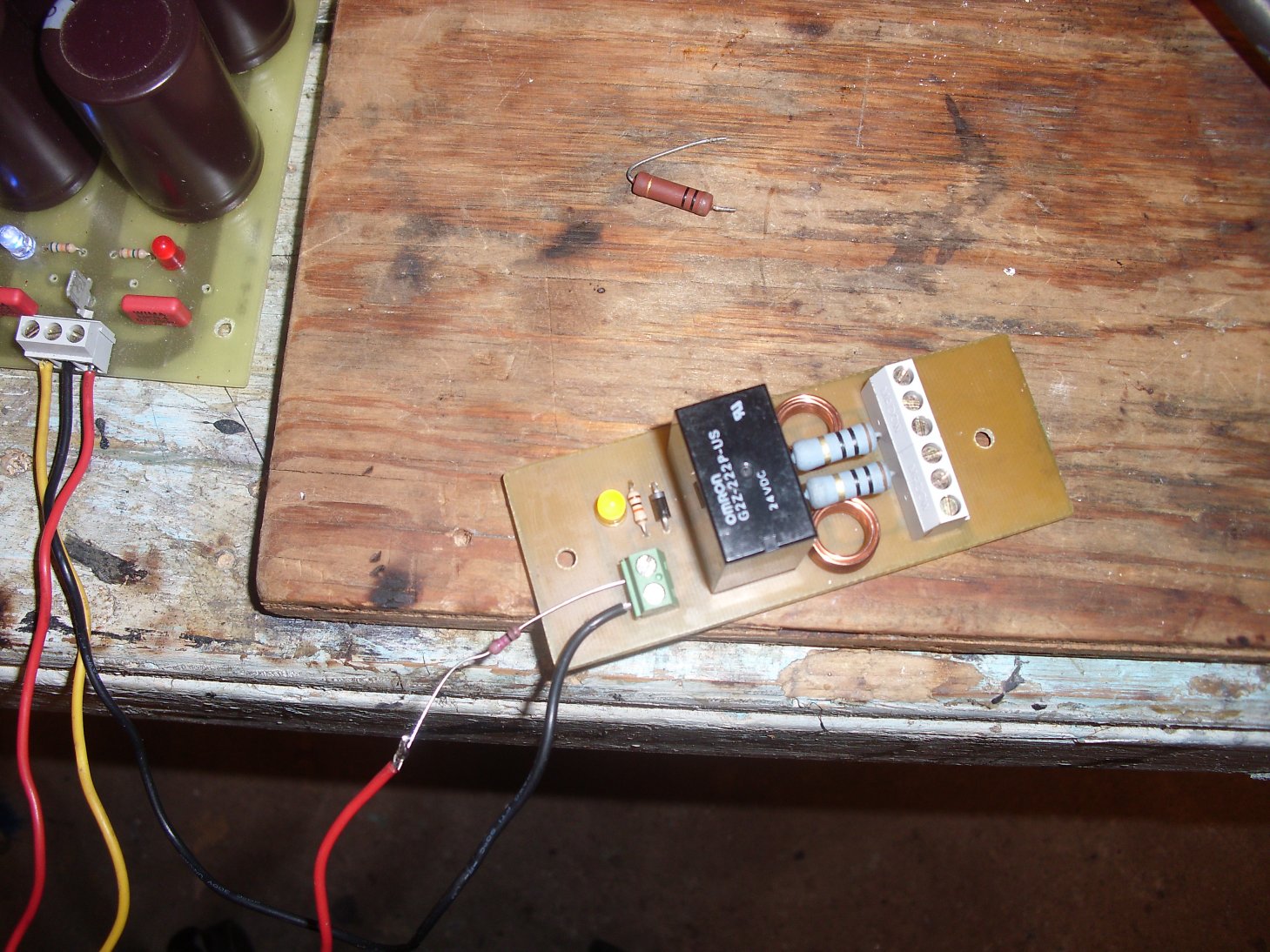

OP coil / relay board done , LT CD4000 series trouble.
I finished the physical job (below 1). Ran the relay at 22 V (hey , its a 24V relay) ... any ideas on how to run a 24V device with a 12V logic circuit ?? (below 2).

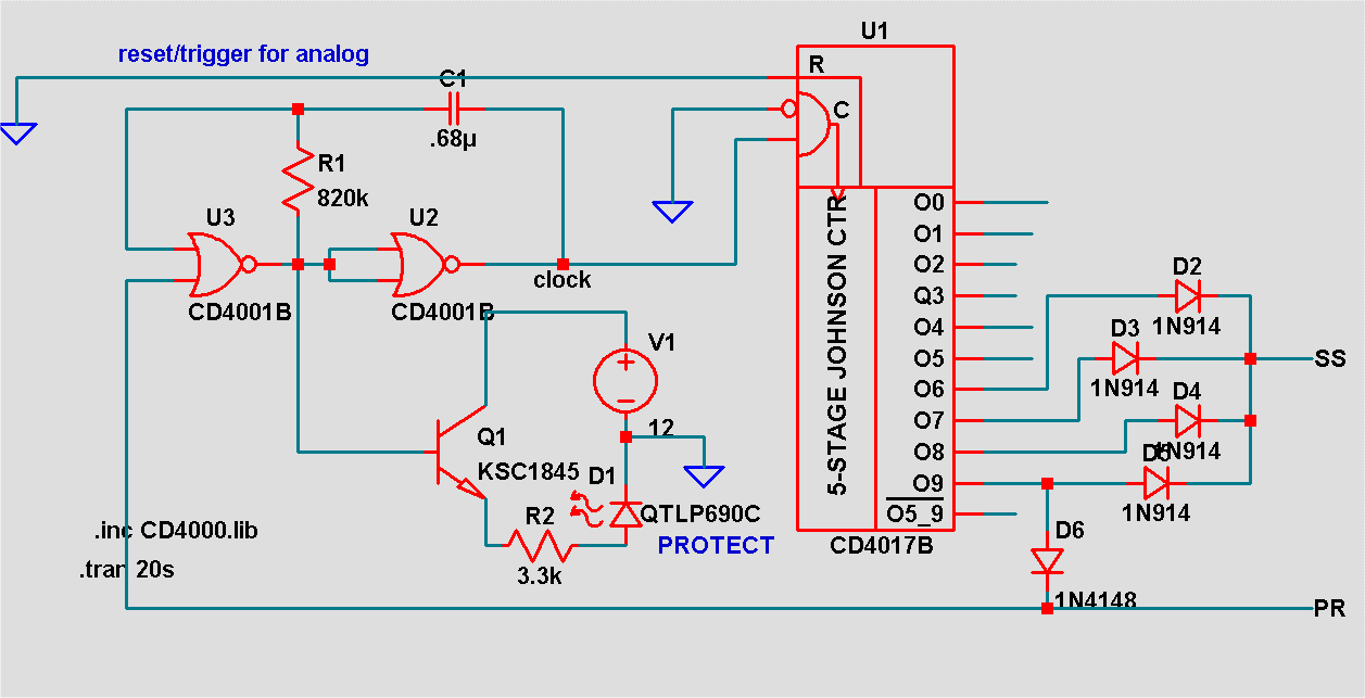

The logic circuit - 2 -4001 nor gates act as a astable gated oscillator which also flashes a LED. The oscillator output is the clock input for the 4017 decade counter which toggles from O0 to O9. Diode OR gates turn on "SS" at 6 seconds and "PR" at 10 seconds. When "PR" goes high , the clock is disabled. Any pulse (turnon or turnoff) or a high output from a analog DC/over-current protection chip will reset the counter either temporarily or permanently , engaging the clock/LED but keeping the counter at "O0" (relay will stay open).
Built this thing in 1984 .. had to remember how to do it. (no LT spice then).

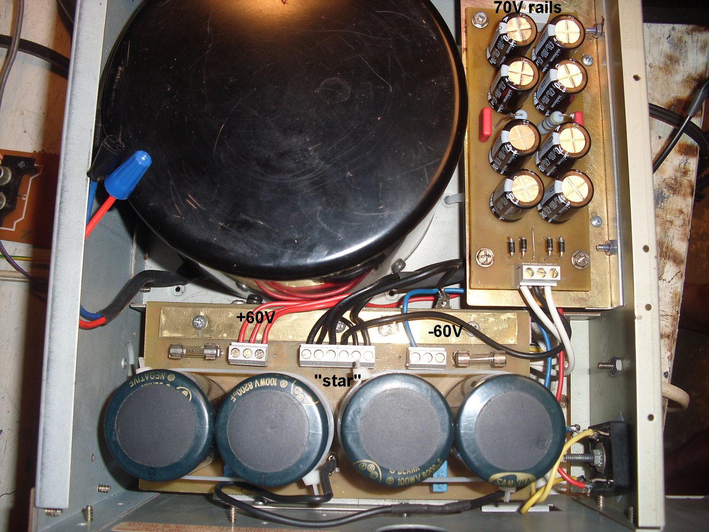

So far ...
a. Increased main filter caps from 2 X 15kuF to 2 x 16.2kuF with a 35A heat-sinked bridge.
b. Got rid of the "cheezy" 2 X 1kuF 70v supply with no Hf decoupling and replaced with a true C-R-C 8 X 470uF unit.
c. Used the same grounding scheme as the Nikko , with it's dual returns to isolate OP switching pulses from the small signal paths.
d. The design itself is better (PSRR wise) , the nikko was a goldmund/symasym type balanced VAS with no local decoupling or current sources. 😱
e. Added the cap multipliers to further enhance the small signal sections PSRR.
All this - plus the fancy protection circuit, will grace this thread in time (I am not paid) after it has endured a little summer heat and my picky ears. Documentation and "anal" layouts that won't cost a fortune to build and last 20 years are around the corner .... No fine wine before it's time. 😀

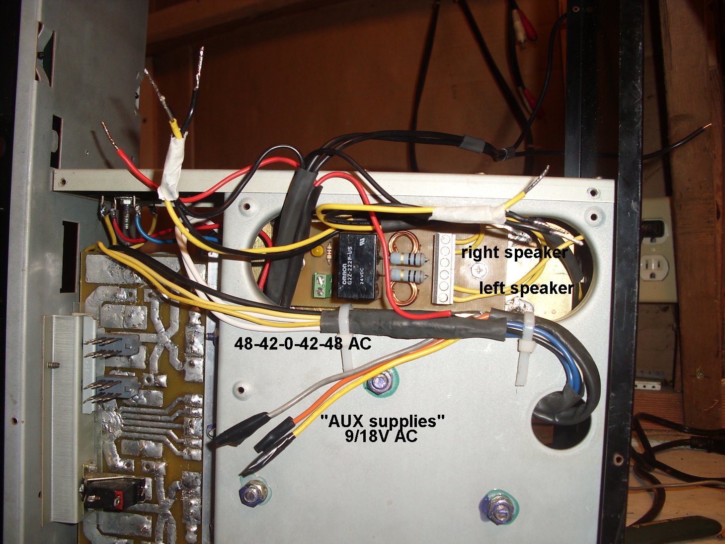

I'm still burning it up with square waves 😀. I won't do my first audition till I get some blue wire for the negative rails and the euroconnectors for the AX modules. It is almost the same as my last 250W version , but more refined. that one had tremendous headroom and a huge soundstage. This one (in the Nikko case) is the first one with true separate supplies , so the definition should be even better. With the steel case and shielded trafo , it will be quieter as well.
(below 1 and 2) , I have it almost wired ... including the relay board. I don't want to wire it twice ... so I need 18ga. blue wire. I plan on gold input jacks and other "frills". 😀
There will be 8 PCB's when I am finished ( 2 AX modules , 2 power boards , 2 power supply boards , the relay/coil board , and the protection circuit) ... actually 9 - the fancy power meter that came with the Nikko.
