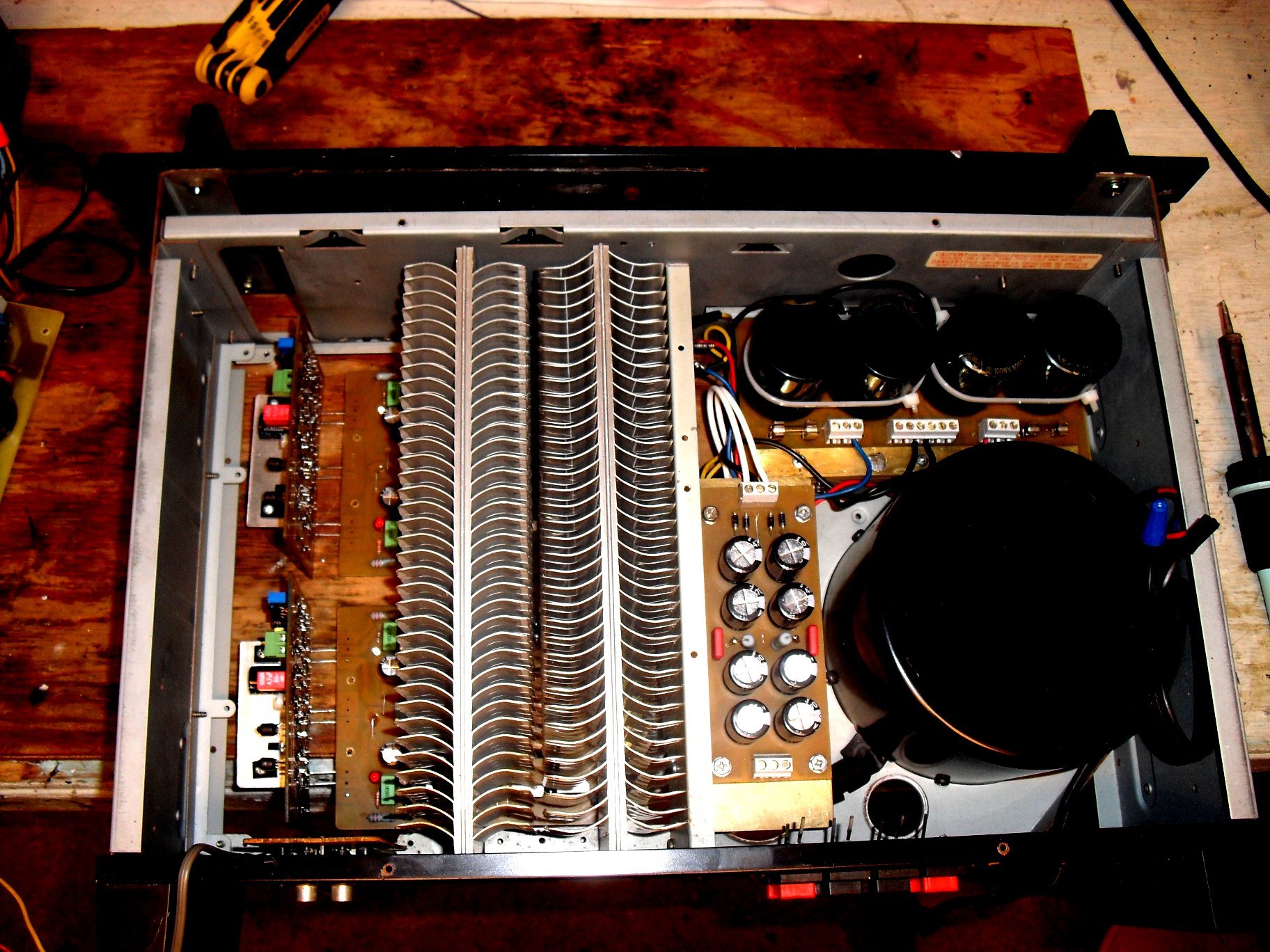

The amp(s) both survived the 10R/4.7uF test at 60Vp-p SW overnight. good to go full duty (let the kids/wife blast it)
The fit in the nikko case is exceptional. looks like it was made in japan - military duty class (way more HD than OEM's)

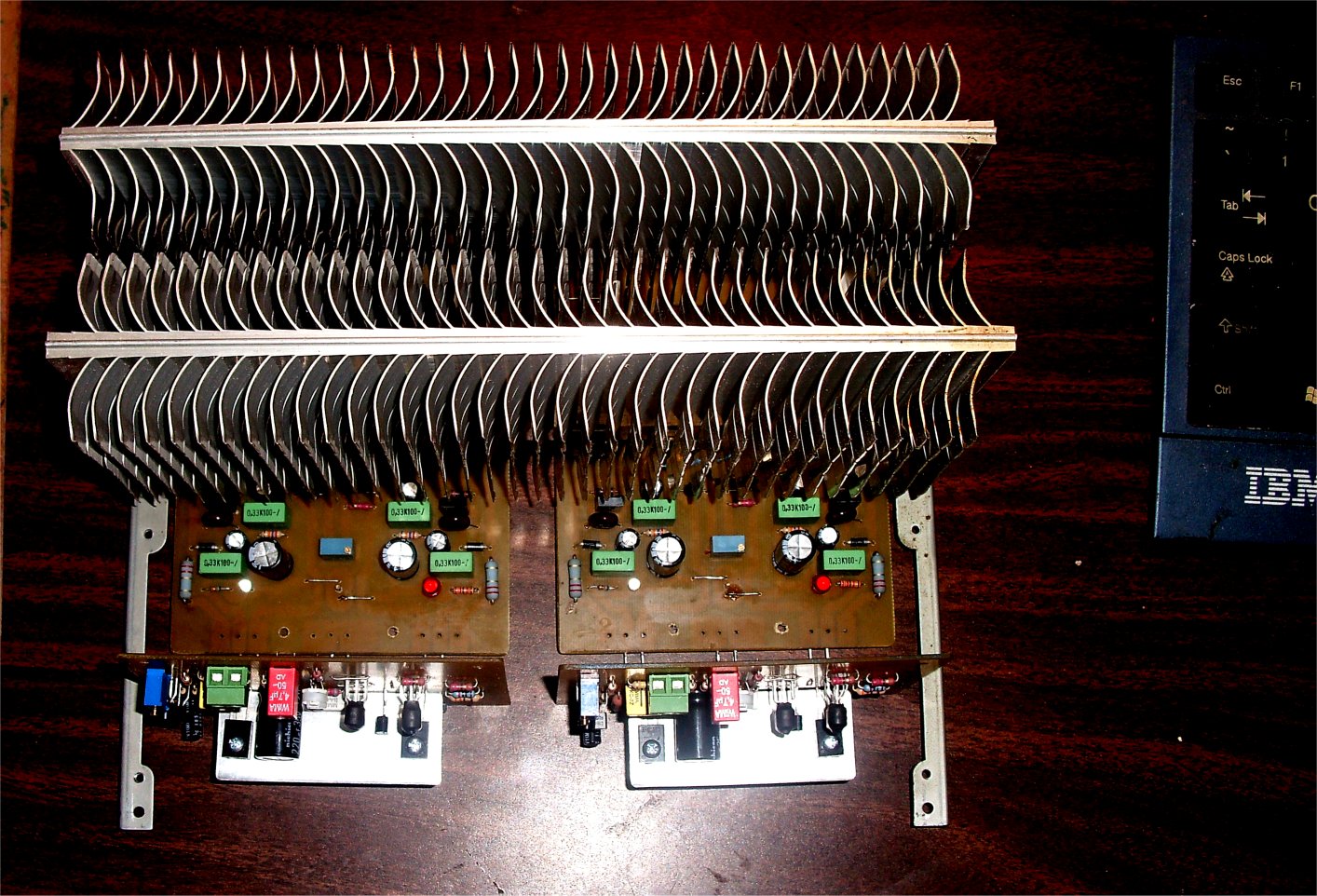

Thanks ,here's the whole thing (below)....
OS
Thank you... C2C. Not a easy one ... much planning. A normal DIY amp with conrad heatsinks , antek trafo , and roomy interior would be a "walk in the park" to layout. I have the neighbors original Nikko 230 alpha to compare to this one as well , I do think this one will outperform the original in noise , power , and mean time between failure (30 years... aye) .
I might buy some more broken ebay amps to retrofit ... this is fun .

Thanks , HughElegant job, Pete.... now build quantity and sell a few, OK?
Hugh
That is how I built this: sold 4 amps = paypal = ebay amp + mouser orders. Still , I have no "warchest" of funds ... so things are slow. On the topic , I will offer a module/power board combo for the DIYA "boardstore". Other designs , like a nice triple for sub use , and a complete AX "kit" .. I will handle.
By Bonsai - Very nice job!
I see those types of heatsinks in current commercial equipment here in Japan a lot, and they are incredubly efficient.
I truly admire Japanese engineering .. (on par with German craftsmanship) , those heatsinks are amazing !!! Full night of that 60v p-p cooking those 95w resistors and the HS's were convecting admirably , turn off the SW and they cool down in 60 seconds !! A large version of the best Zalman CPU thermal solutions !

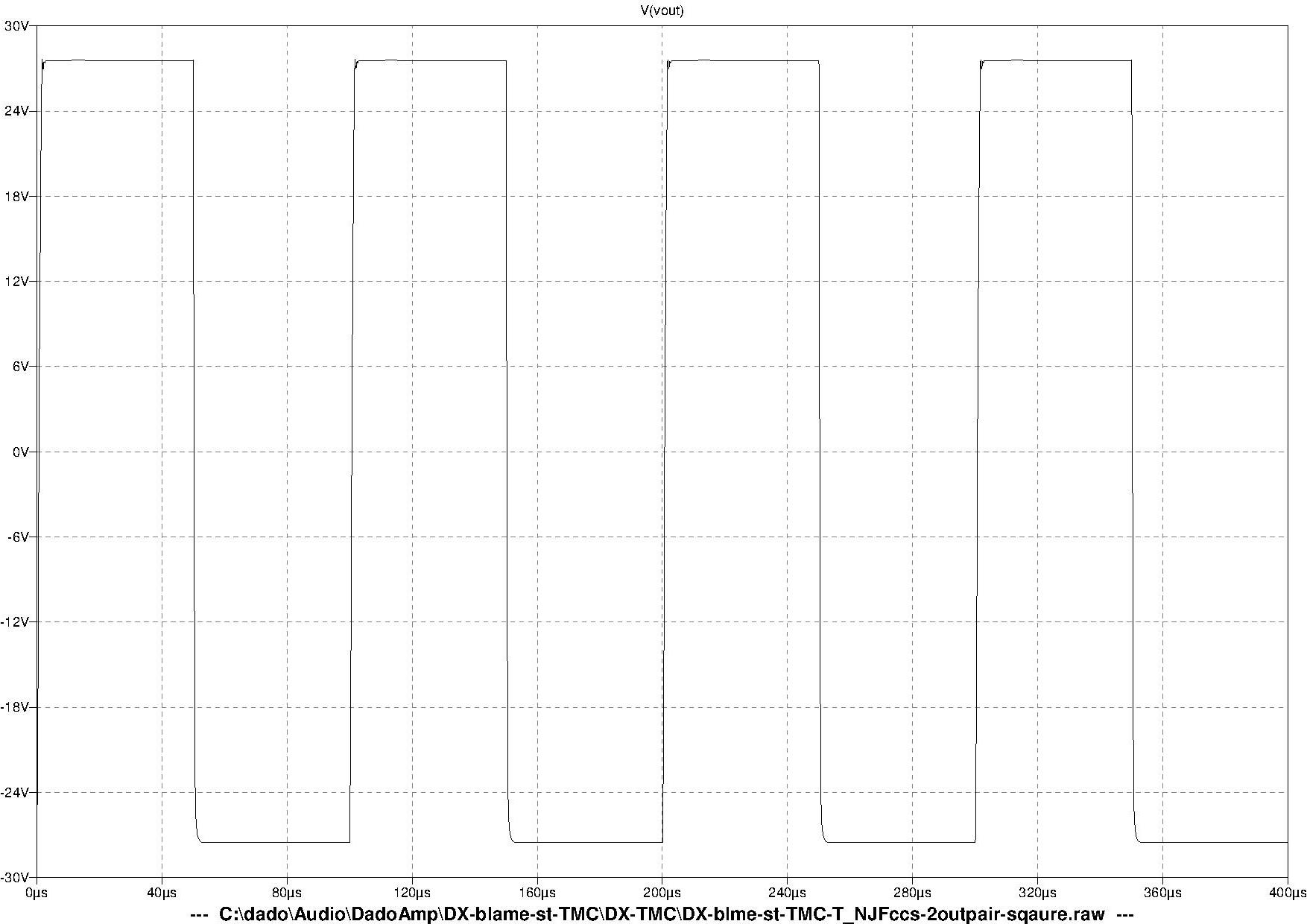

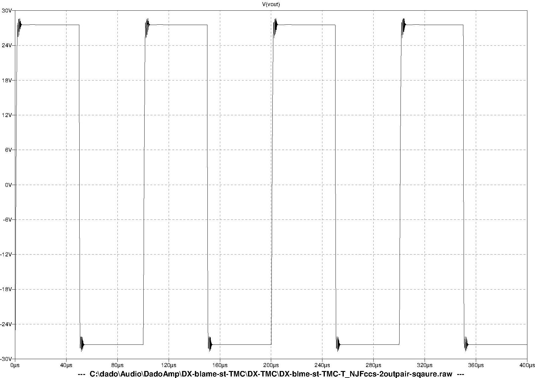

Looking your schematic I noticed that you use 68ohm as predriver base resistor(R86, R87).
I had similar problem with to much ringing on 8ohm//1uF load.
I used 33ohm on that possition and when I decresed them to 4.7ohm ringing was much smaller. Value of this resistors depends on type of output BJTs. Miller caps on predriver are not needed I think as my simulation(on my very similar amp) does not show any difference with or without them.
First simulation is with 68ohm and scond is with 4.7ohm all on 8ohm//1uF.

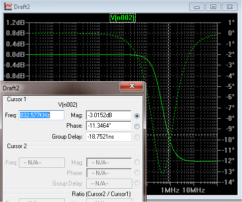

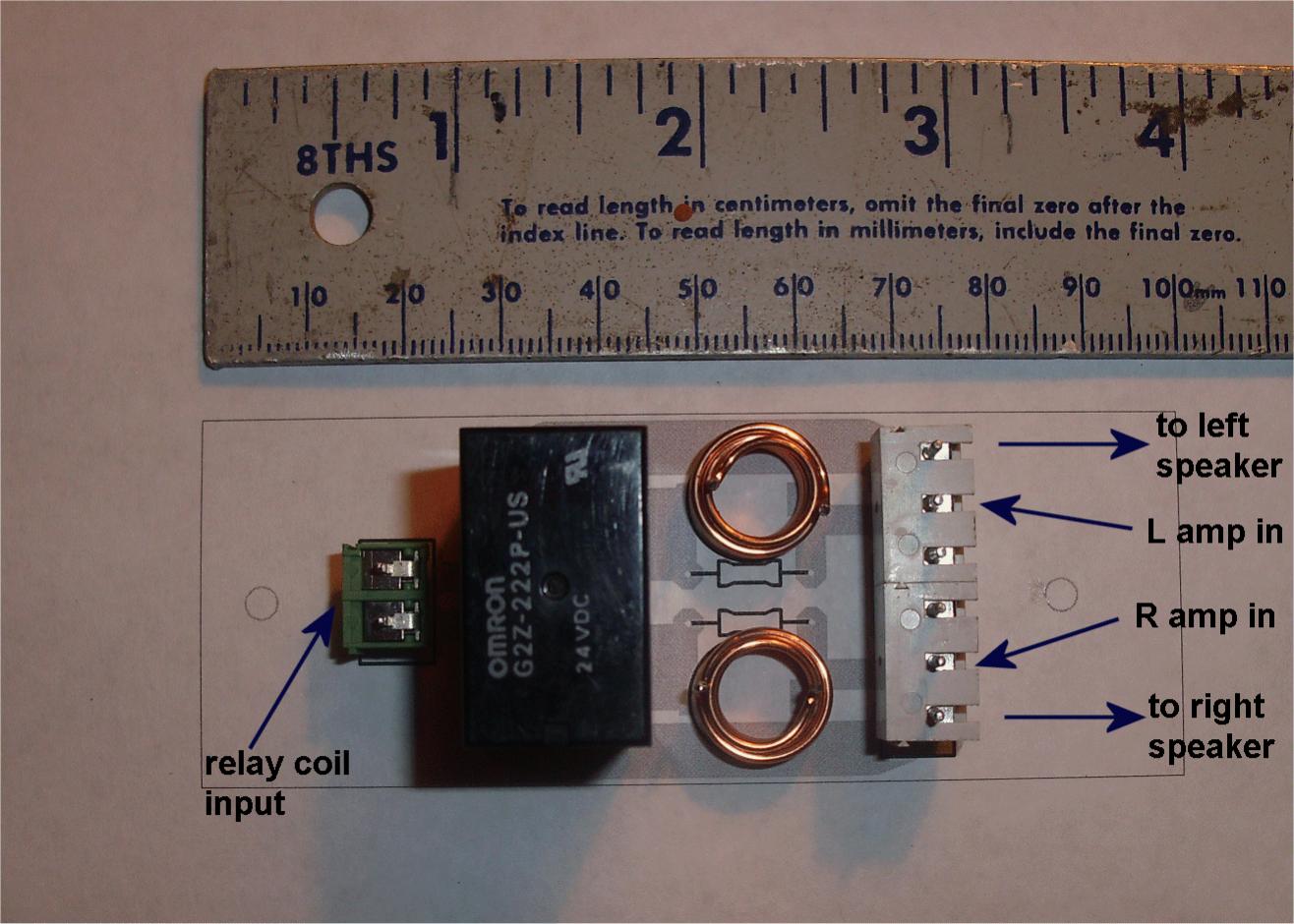

I am copying nikko's idea for the OP inductor. In fact , I am using the original components. Just curious , the Nikko coils (below 1) are 12 X 12mm (.5 X .5 ") with 12 turns ... this equals 1.25uH Air Core Inductor Coil Inductance Calculator .
They combined this with a 4.7R/ 3w resistor in series - this gives me (below 2) , @800Khz -3db cutoff (good for the job - RF suppression).
Placement wise (below 3) , I will out-do the nikko (they ran amp/coil /relay/switch in front/ speaker jacks in back) .. that is a LONG run for the output. My "scheme" is to just go amp/coil/relay/output jacks in as short a run as possible. I can switch my speakers on/off by just toggling the relay , eliminating the "loop" to the front switches.
Now for the magic 4017 cmos/ta7317 protection circuit. I will have a relay'ed output (tonight).

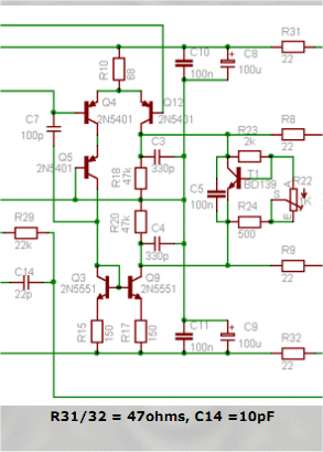

#1, most "know of" miller compensation. This amp (the mongrel) can do miller , 2 -pole miller ,and transitional. How it is implemented and what values are determined by the transistors and the topology.
Some old slow devices with huge Cob (base capacitance) could get away with no miller comp. , the output devices were also so slow oscillation was minimal.
"mid speed" devices (mje340/50) need miller comp. they will oscillate unless given a dominant pole. 22 - 47 pf is the sweet spot for these devices either in a symasym type design or blameless/cordell example.
Newer Ksa1381/c3503's are speed demons , with only 3-6pf cob , they need a larger miller capacitance to set the pole to something reasonable. (47-82pF)
#2 , the symasym HAS a miller cap (C7 - below) , it also has 2 shunt capacitors (C3-4) plus the VAS is loaded to ground (r18/20). This arrangement has multiple poles and zero's. Without this network it would not "be fine" , frying your parts and speakers quickly.
