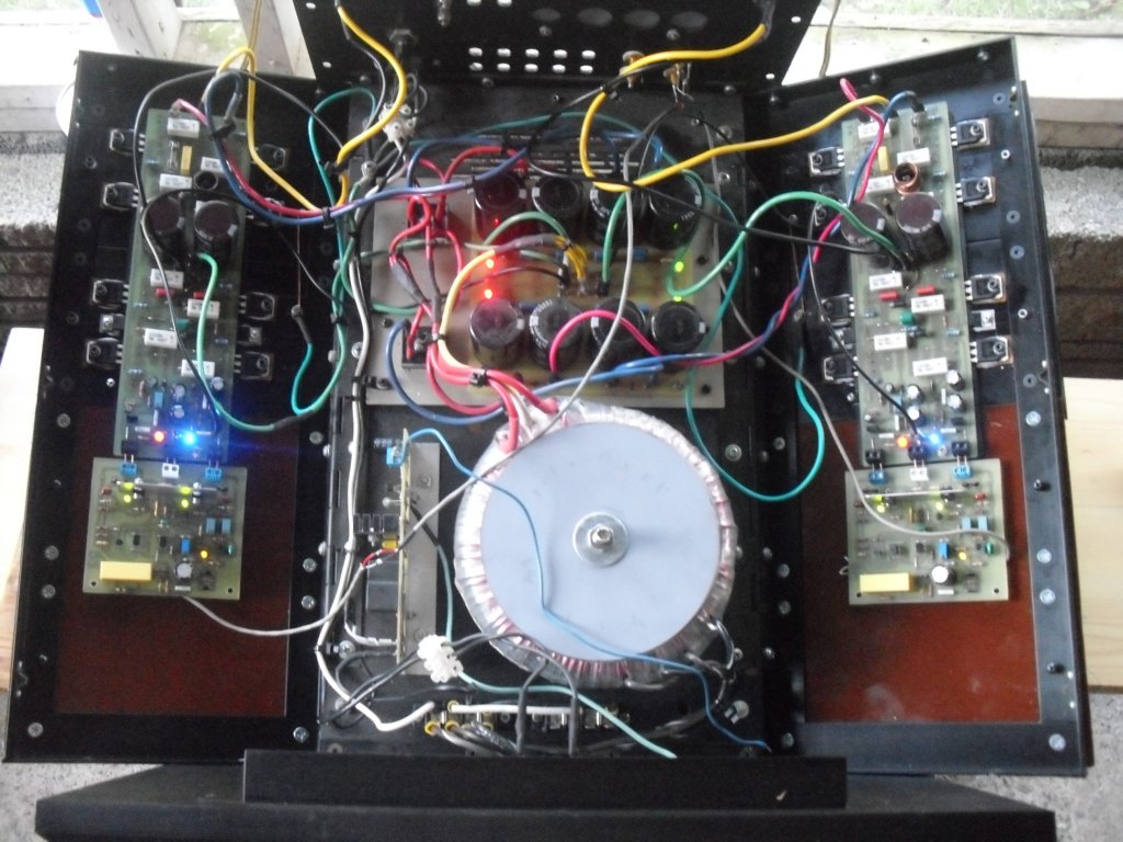

After living with it for a day , it does have a very small turn on/off thump, not enough to see on the woofer but barely audible.. it does exist. Another observation , as the rails collapse , there is no squeal or strange noise ... just a static distorted sound as you lose those remaining volts (7v and down to 0V)
What it does not have.. is ANY audible noise and hum , no thermal problems (VAS stays cool on both 45V and 75+V even after abuse) , rock steady main Vbias with 2mv max spread on 5 watt emitter resistors.

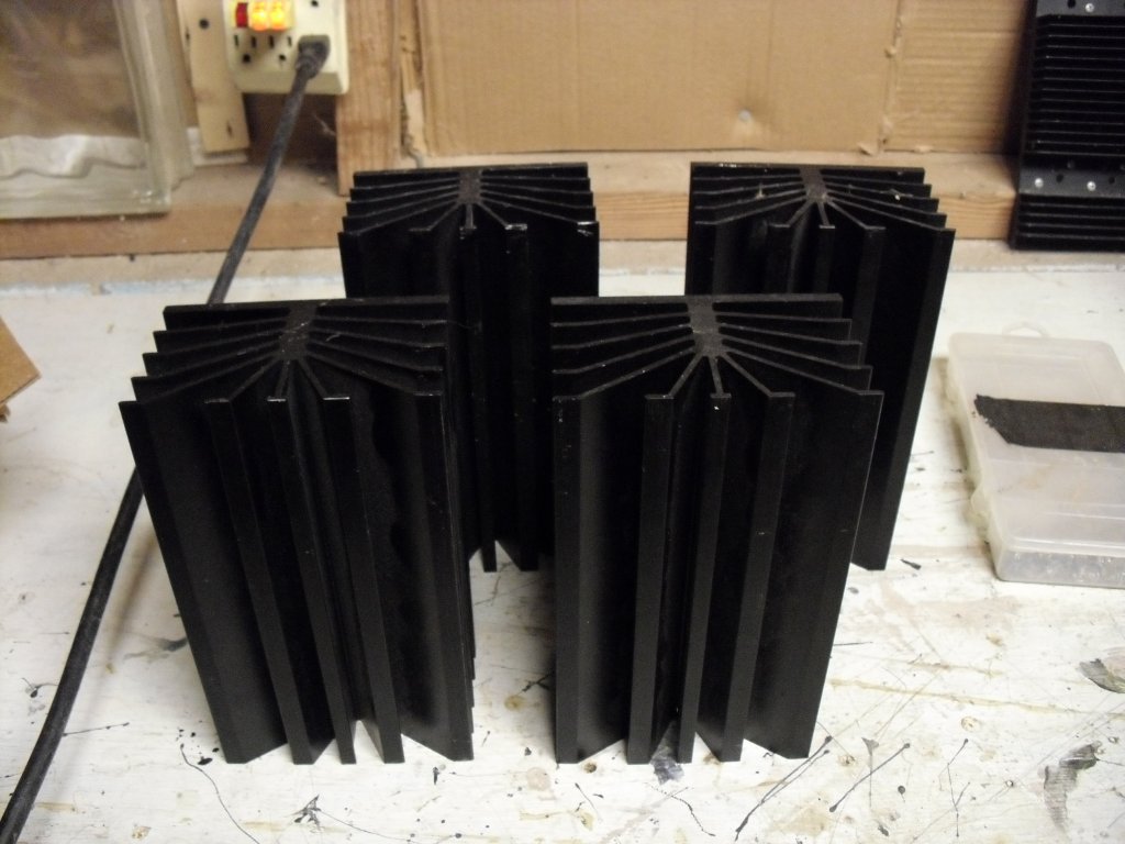

How can I get 8 of these ? I can pay 10/1/10 but do they trade ?? I have the 4 monster stealth heatsinks up for grabs.. (below)
Another thing that bothers me.. I have those 2 supersyms with 16 pair good OP's that I really want to give Keentoken , if he will wait ,on 10/1, I will have many AX and GX PCB's ... maybe a package to send him , I really want to do this but shipping/$$ are a problem.. I am ISOLATED (except for the "cop-caller" a mile away). These amps are WAyyy better than supersyms.
look at "monster sinks" , probably below 0.1 C/w.

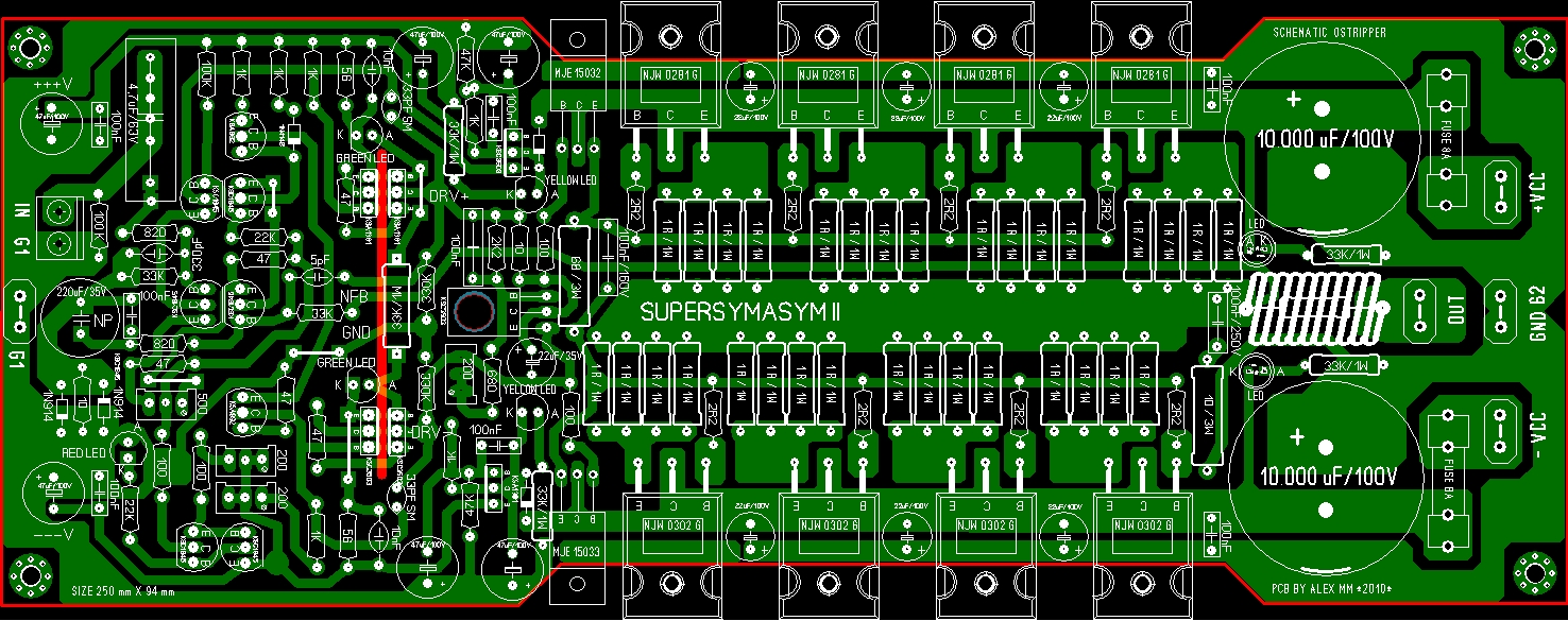

PCB variant for MONGREL ...
Next project will be this Symasym II , it's an very , very good sounding amplifier and I will invest some money to build a pair 🙂 . I layout PCB for PB250 schematic , and possible some error regarding PCB , please help me to make the correct one .

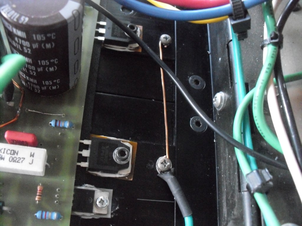

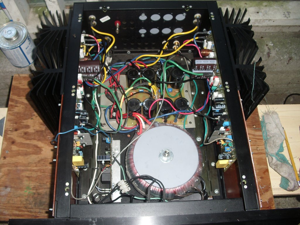

Split the ground , man. The main ground (G1) is only for the main big caps (4700-10k) the associated HF caps (.1uF@100-250v) , and the zobel cap. The capacitance multiplier , it's caps and the voltage stage have a separate ground (G2)... this feature allows the preferance of having the big spikes from the big caps on the PB250 go to the first reservoir on a PS such as the PS100 , the G1 could go to the second reservoir after the R or L on the main power supply(CRC or CLC style). If you lack something like that , you could always run G2 to a 4.7 to 10R resistor and then to the main reservoir.

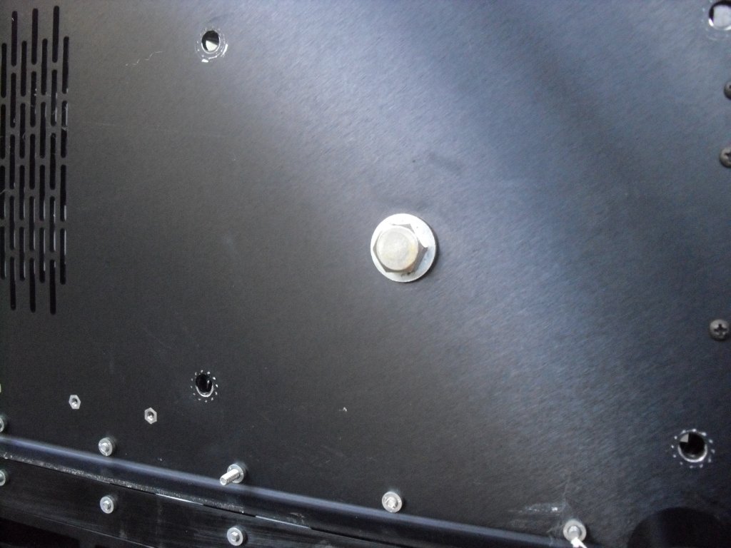

2nd day of hard testing and MILLING. It is all together now , I don't have to worry about someone getting electrocuted anymore. Big , lunky stealth case is much lighter after 1 less toriod and minus 4 -5lb heatsinks ... could actually be under 60lbs. 😀
Stupid Genesis never properly grounded their heatsinks (pix 3) ,Anodized heatsinks do not conduct between them, 🙁 all they did was ground the hinge for the whole assembly .I fixed that-DIRECT earth. (Pix 4) is the huge 3/8 X 5" bolt to hold the 30lb toroid in there.

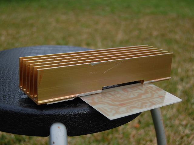

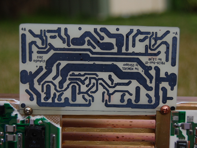

I have etched the PCB for the PB120 and test-mounted the PCB onto the heatsink. I may start drilling & mount the parts that I got in my parts bin.
Nice boardwork, SNG. What do you use for etchant ? HCL/H2o2??
OS
PCB etchant
OS,
I use Ammonium Persulphate
The alternative to Ferric Chloride. Mix contents (400 grams) with 1.5 litres of hot water to etch copper board approximately 500sq/cm.
It costs $13 for 400g, I used one teaspoon worth of crystal to etch the PB120, so 400g last a long time. It make a clear solution & it is not as corrosive as HCL.
Attached is the link to Australian supplier and you can look the MSDS on that site. Ammonium Persulphate - 400gm - Jaycar Electronics
Cheers, Stanley

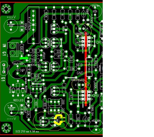

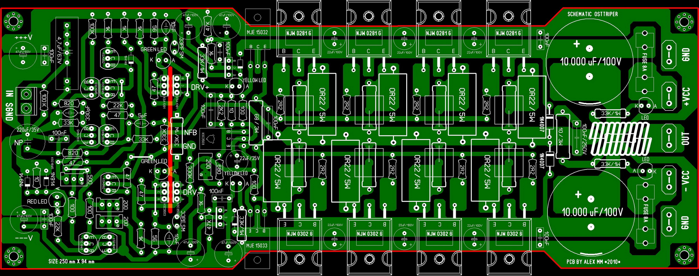

....after routed again the last PCB will be .No prototype until next week .....
Regards Alex
Hi AlexMM,
Nice layout, I like the idea of using 4x 1R as emitter resistor.
I have not checked the board trace by trace. I have the following suggestions:
(1) The Ground pin of the input connector should not be connected to G1, it should be connected to 33K (light-green trace).
(2) The two Green LED can be moved a few mm towards the LEFT to make more clearance for the small heatsink.
(3) The Q5 & Q6 can be moved a few mm towards the LEFT & a C-B bypass capacitor (5600pF) can be added.
(4) The label for Ground G1 & G2 are different from that of OS's. OS refered G1 as the noisy ground for Zobel & onboard cap, G2 is the clean ground for the VB.
Cheers, Stanley
Hi AlexMM,
I cannot edit my last reply.
The value for R22 (right next to the small heatsink) should be 39K (1W).
Cheers, Stanley
Cheers, Stanley
Have you considered the 3pin input as adopted by Jens for the Leach clone?
It offers lots of flexibility for connecting a source and doing initial testing.
It has a Signal Ground pin, a DC coupled pin going straight to 820r and an AC coupled pin going to 4u7F
The three pins are 0.1inch pitch and can use a 0.1inch 2female plug to short out the various unwanted options.
