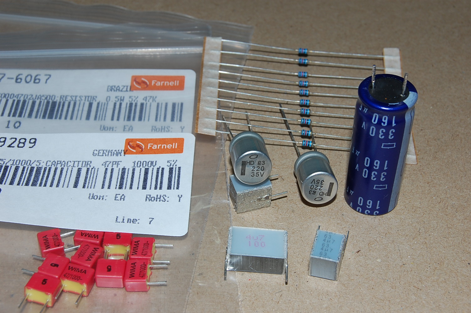

I opened the Olympus camera & found a 160uF/330V Photoflash cap inside & I got it out.
The first lot of my Farnell order has arrived. Attached is the picture of some of the parts.
Silver naked skinny cap - EPCOS B32562 series 4.7uF silver cap for C1.
Red poly caps - Wima FKP2 47pF Polypropylene, it is a bargain at 9c each.
Purple-blue electro - United Chemi-con 160uF/330V, I will use this as C3.
Silver electros - Nichicon UHD 220uF/35V, I ordered this for C3, but I think I will try the photoflash cap first.
Vishay BC SFR16 resistors - they are tiny, I can't complain as they are only 2c each and the spec is also quite good - temp coef=100ppm.
The other parts will take another week to ship from US warehouse.
Cheers, Stanley

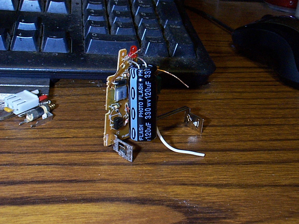

That 330V/160uF cap looks like an ordinary switcher cap. They may be the same thing, but mine has the words "photo-flash" marked on it. I have also seen "foto-flash" used.
I wish we could be certain about these things. In disposable throw-away cameras I believe are the obvious ones, with the photo-flash mark. I'm not sure, but Kodak may recycle these cameras (what else do they do with them when you bring them back to the store? Then again, if they just get thrown away, you should be able to get a bunch for free from the local walmart).
Thoughts from anyone more knowledgeable than me?

Here is what I'm used to seeing.
I can see there's also a polystyrene cap... 22nF it looks like, not sure where that's useful...

Those "naked" caps are the same physical construction as polycarbonate.
Hi Andrew,
The following is the description of the naked Silver cap on Farnell site:
Manufacturer: EPCOS
Order Code: 9752714
Manufacturer Part No: B32562J1475K
Description CAPACITOR, 4.7UF, 100V
Capacitor Dielectric Type😛olyester
Capacitance:4.7µF
Capacitance Tolerance:± 10%
Voltage Rating:100V DC
Series:B32562
The EPCOS datasheet says:
Construction
Dielectric: polyethylene terephthalate
(polyester, PET)
Stacked-film technology
Uncoated
It is the cheapest 4.7uF film cap ($0.77) on the Farnell site and I guessed that I did not pay for the fancy coating.
Hi KT,
The blue photoflash cap was actually manufactured by United Chemi-con and the camera is very old (> 15 years old) so they may not adopt the special marking for photoflash cap. The camera is a first-gen digital camera so I think that costed an arm & a leg when it was new. I tested the blue cap & the leakage current is quite low.
Cheers, Stanley

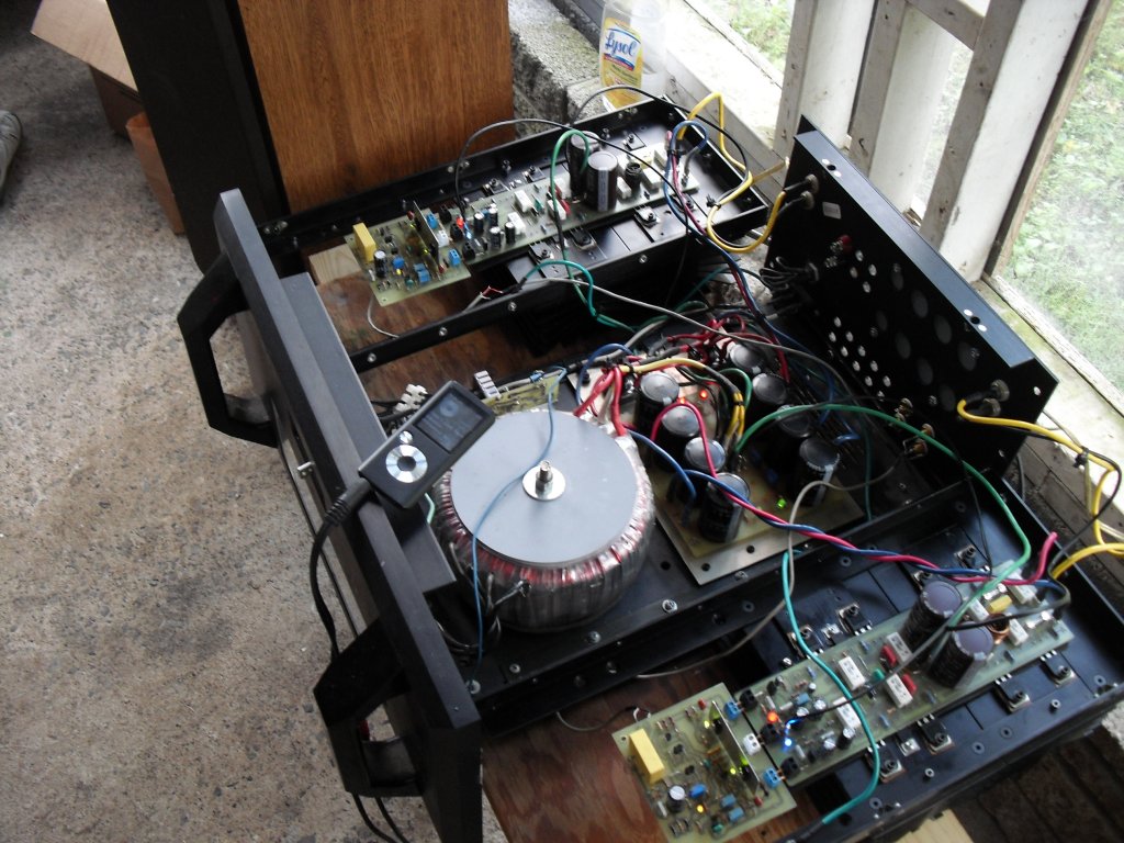

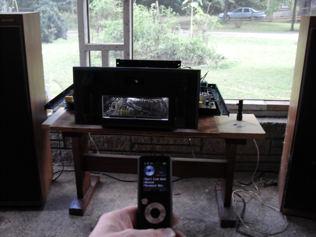

Hey OS - Grrrrrreat going and congrats!!! 😎
Where did ya scrounge that case up from - it's very nice!!!
Where did ya scrounge that case up from - it's very nice!!!![]()

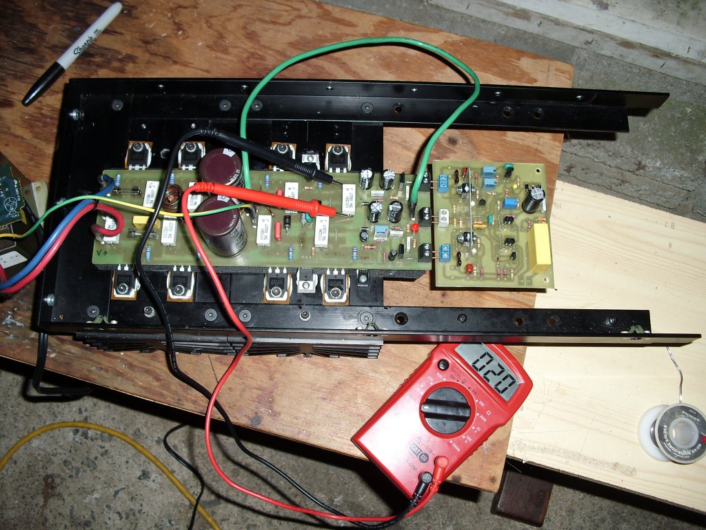

It works too good... the cops were called.
Became quite warm after 2 hours more hours 4R load at insane levels (before the cops)but held 20mv bias perfectly.
DEFINITELY.. the best to date , by far!!
Case is the old genesis stealth minus 1/2 it's heatsinks.
OS

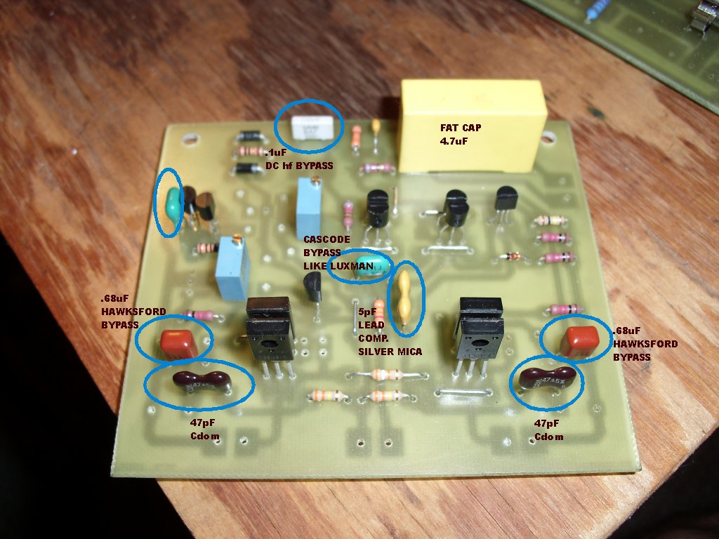

Luxman had in the 70's dual dif Jfet diamond buffer front end fully cascoded second stage and mosfet output oh and a separate supply for the front end. Must have been nearly ten years ahead of Dr. Hawksford's published paper. Tone controls and phono sections were very clever as well. Looking forward to your comments on how your new amp sounds. Thanks for a great thread.
What is strange is that it sounds even better now ??? The bias is still 20mv (@75ma per device) , but it sounds even better after runnin' the snot out of it. 😕 I wonder if the OPS has a "burn-in" .... or whether my ears were altered. 😀 (I did rest them).
On the hawksford note , I came to this amps design before even reading his work or seeing the luxman , right down to the green LED's (hawksford cascode paper). The idea to decouple the emitter resistors on the cascode is mine and APT's (first saw that on the APT1).
OS

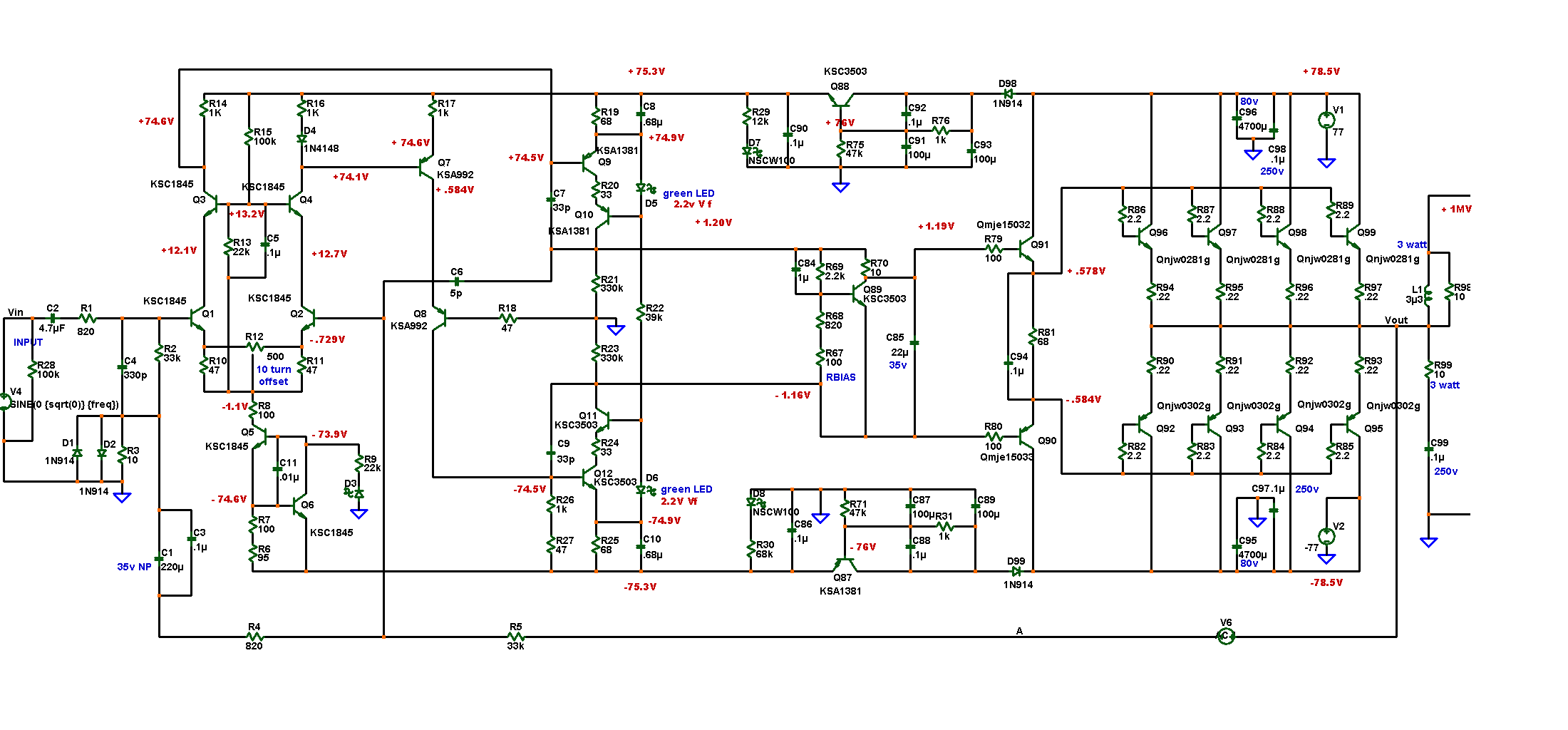

Component values
Hi OS,
Thanks for the prompt reply.
I have a few questions with regards to the component value?
I referred to the schematics with voltage that you post earlier.
R2 -- -- resistor, 68K (33K on schematics)
R19 -- -- resistor, 82 (68 on schematics)
R20 -- -- resistor, 47 (33 on schematics)
R23 -- -- resistor, 270K (330K on schematics)
R24 -- -- resistor, 47 (33 on schematics)
R25 -- -- resistor, 82 (68 on schematics)
C7 -- -- capacitor, 47pF 250v (33pF on schematics)
C9 -- -- capacitor, 47pF 250v (33pF on schematics)
Can you please clarify which one (the attached schematics or BOM) is correct?
Cheers, Stanley
