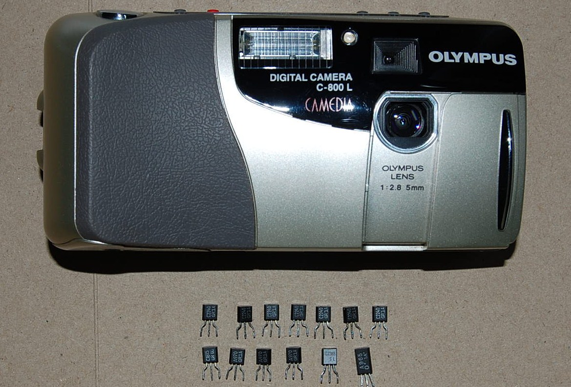

Thanks KT,
I found the following camera from my junk box. The camera still works but it does not have any slot for memory cards & I don't have the data cable, so this camera was put inside the junk box. I will open it & see what cap is used for photoflash.

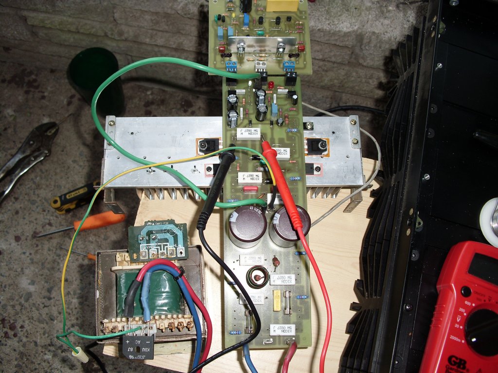

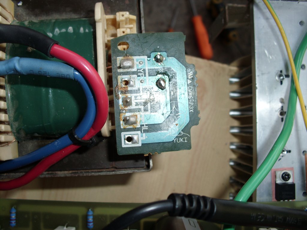

I must truly thank Ed LaFontaine for the "Yuki" trafo(pix 1). It gives a rectified 45-0-45 , which is just perfect for small amp development. (Pix 2 ) is the second amp being tested on "Yuki" (this trafo has a little japanese guy on it - strange) , and finally on the "Monster" (78-0-78VDC).
Some would wonder why I go sooo slow. Besides being a braindead redneck , I want to be sure that any offering by "mongrel labs" is top notch and very safe to build. Another reason is that to determine thermal stability in the real world is a bit harder than in simulation. Heating and cooling , with hairdryers ,lighters , and cold mornings may seem primitive ... but it works!! Electrical stability- longterm is important if you want your project to last for DECADES.
The GX/PB250 has a preferable tendancy to hold its current source , and main bias settings regardless of voltage , Main Vbias drops a little as you reach 70+ volt rail levels ... but this is good. Wiper failure on any trimmer would set the amp in a safe , if not underbiased mode. This is definitly not a "burning amp" , in fact it is a "green amp" using 18ma per rail (GX1.2VB - 78V).
SNG001 - your C2240/A970 is the EXACT semi luxman used ... so you will have a perfect match.
OS

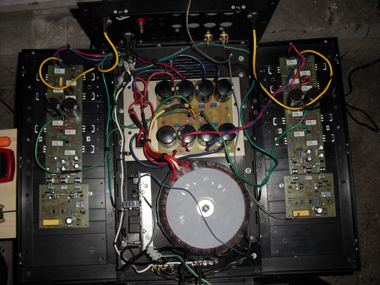

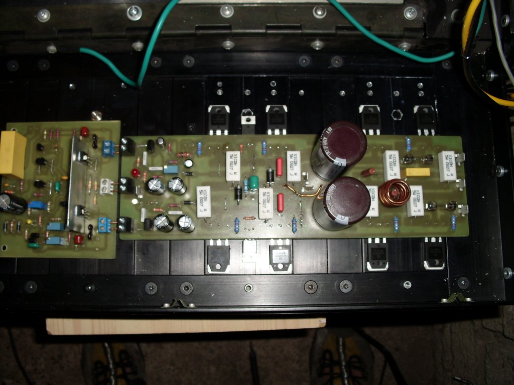

Ready to ROCK !!
All 4 pairs are installed and tested , just have to do a little millin' on my heatsinks. Lined the NJW0281/0302 pairs up at 4 -1/2" - 114mm (pix 1) and the
MJE15032/33 drivers at 4" -102mm. These amps look like they were made for the heatsinks (pix 2) . A lot of precision drilling and tapping , I use 6-32 allen head bolts with load spreaders and strange orange insulators that came from the genesis stealth.
All set for tommorrow's FULL power test from hell. 2 paralleled speakers per channel , same as the "supersym" test. With the GX's higher gain I will most likely approach the speakers "death zone" 😀

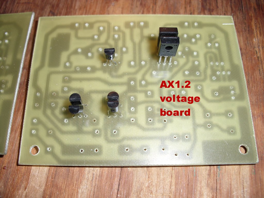

That is the reason for the "mongrels". Once you get your power board and power supply done and bolted in , you don't have to go broke and build all those projects anymore. I will eventually have Voltage boards up to A "ZX" , if I wanted to , I could even turn all of mr. carlos's DX amps into voltage boards and run them at 60 or 200w+.
Each voltage board costs less than $10 , so DIYing can be less expensive. Also , my FR-4 is "bulletproof" you CAN NOT lift a pad from my military grade PCB's .... you have to scrape it off.
I will be selling boards in october (GX,AX,BX,CX , PB250/60- PS100) all made by me , not chinese board house stuff.
Below is the AX , I had to take parts out to finish my GX's , but it sounds golden. It is still the champ in Wahib's simulation "shootout".
