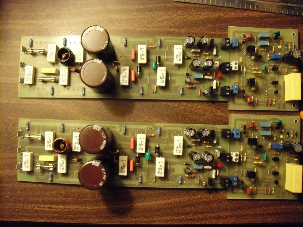

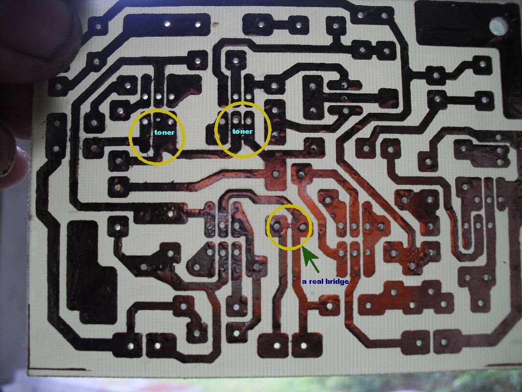

Just an example of the perfection you can get with genuine HP toner and a little "feel" for the process , below are the "AX" boards .. natural light.
most of the visible inperfections are toner blobs .. one real bridge , scrape with trusty needle punch , VERY usable board... these are the first ones I did!!

I'm willing to bet those 680nF caps are stacked polyester/polycarbonate film. This intrigues me because polyester (or mylar) is generally considered okay for audio and polycarbonate excellent (pulls out fire blanket). This is only what I've read though.

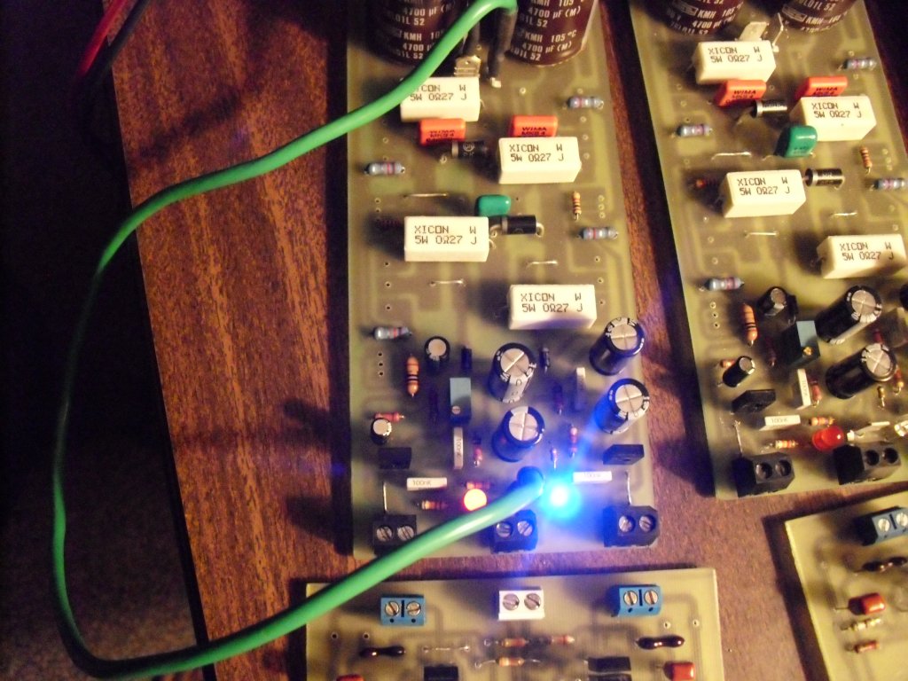

minor screwup on the AX
I like my LED's , I did not separate the trace for my CCS confirmation LED on the AX's... I fixed them (below) and will update the AX package soon. One could just leave out the LED and the board would work as advertised. 😱😱

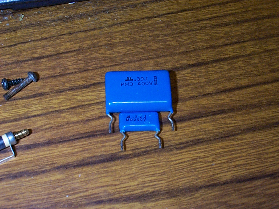

MPX caps are also propylene. For instance Dain caps at the power input to switching supplies. PMD, MPX, etc. caps can all be had in ranges up to at least 1uF. Some amps use input caps as small as 470nF. If using these caps improves sound quality, it may be worthwhile to increase your amp's input impedance to near 100k to get the proper bass response.
Has anyone tried it? Thoughts? Am I nuts?
- keantoken
Oh, I've been looking through my film caps and it turns out PMD also signifies polypropylene. I had been ignoring these blue caps because I think they're normally used for mains filtering or decoupling, but I wonder if they have value in audio.
www.paktron.com/pdf/PMD.pdf
- keantoken
all the blue caps I have are for snubbing. .001 -.01uF @400-600v

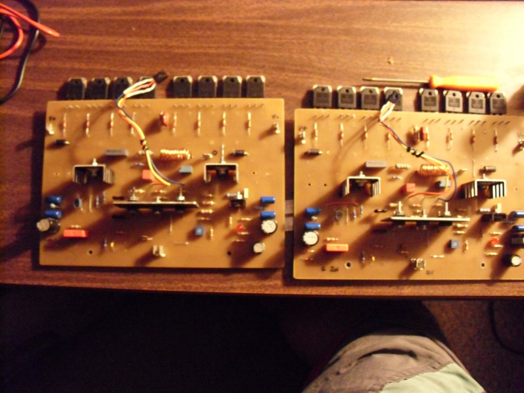

keen... when you are ready , Pm me.. your amps are ready. If you don't want them , I'm sure someone will take them. they have all the OP's , you need the big caps and emitter resistors... all semi's are undisturbed.(below)

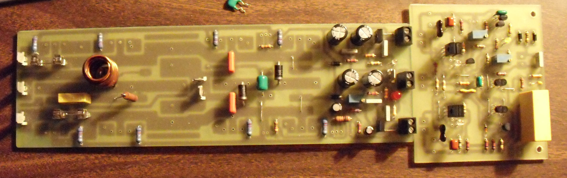

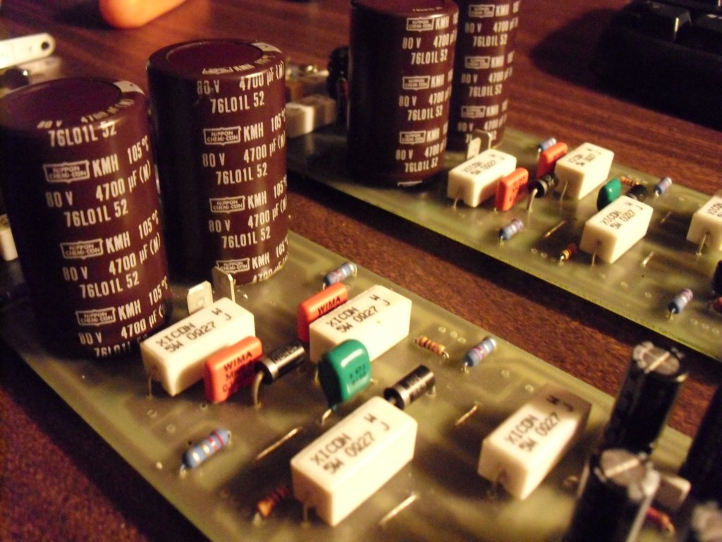

Ready to burn some amps !!
All ready for tomorrows audition. I will go step by step with this mystery amp. almost 100% sure all will go smoothly.. 🙂
A little solid state porn below.

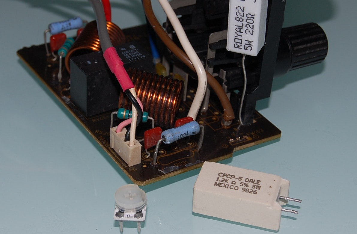

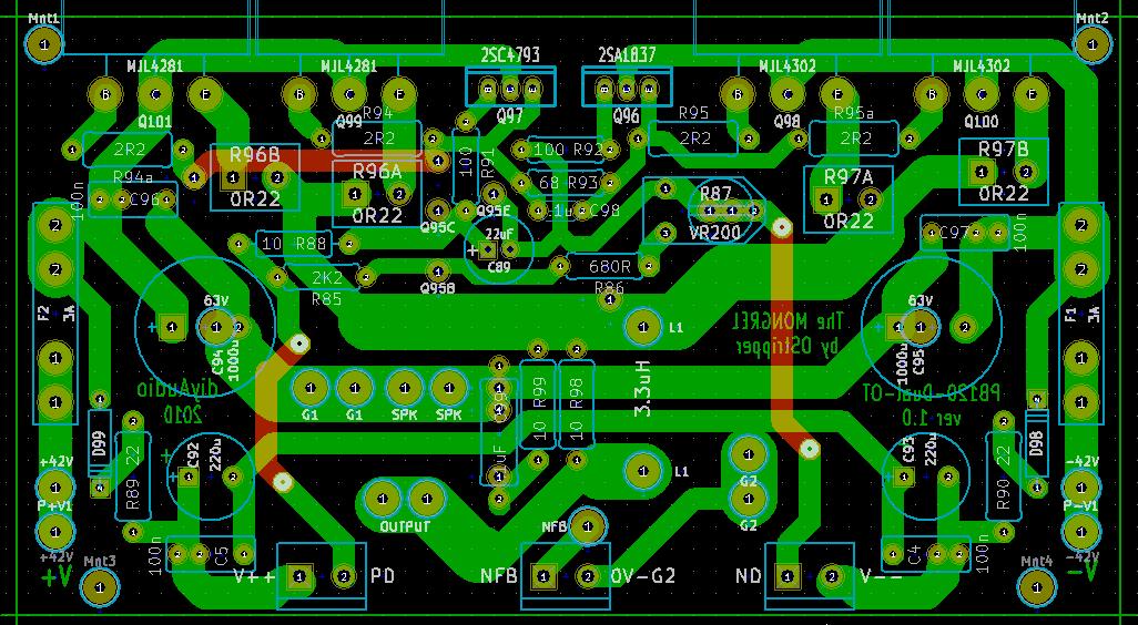

Hi OS,
I like your modular design. Although we can recycle some parts but my problem is the test heat-sink looks like Swiss cheese after a couple of build.
I have built a few DIY amps and found that two pairs of OT has got better drive capacity than one pair of OT.
I have done the layout for two pairs of OT based on your PB60LP. I made some minor changes so that I can use the trimpot & output coils in my parts bin.
In order to save board space, the layout is catered for the CPCP-5 type resistors or the standard CR5-type 5W resistors mounted vertically. The VBE multiplier (Q95) will be mounted on top of one of the OT (Q99).
The Power Board (should we call it PB120LP) measures 68 x 125 mm. I will wait for your test results for the GX voltage board before I build.
Cheers, Stanley

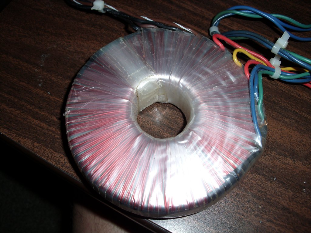

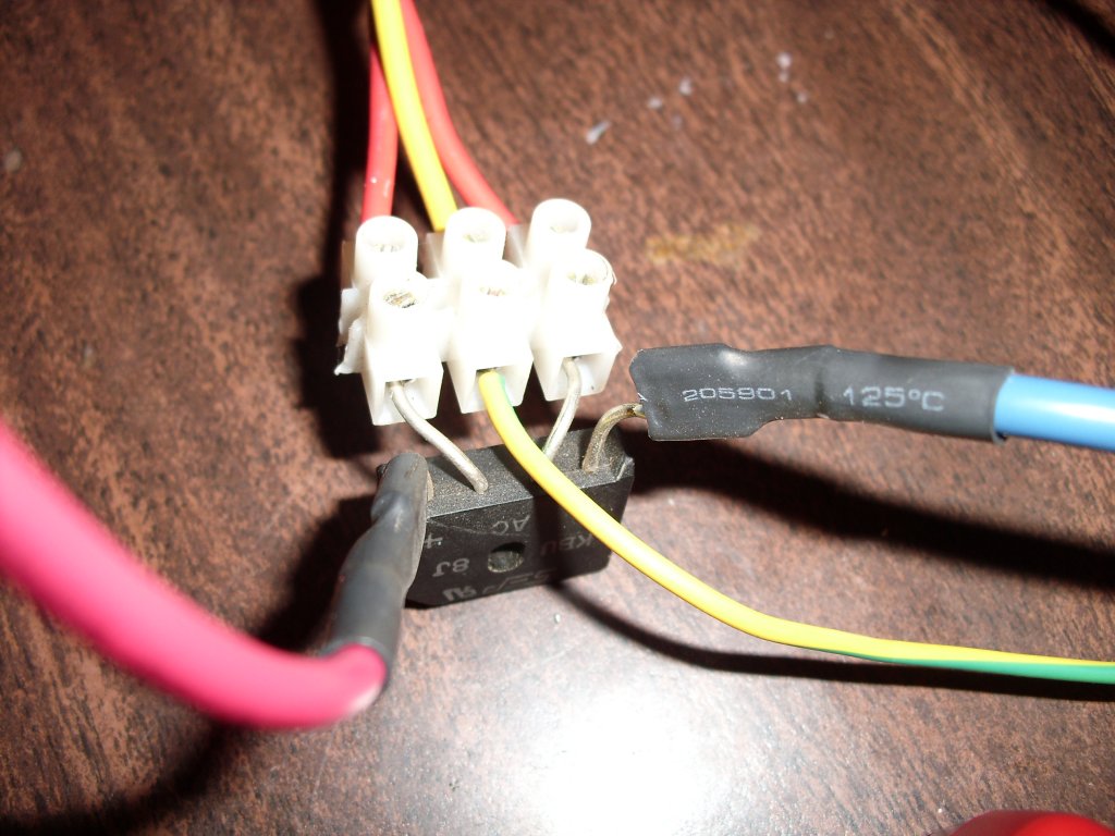

Almost ready to do the deed !! Below I use a test Toriod hooked to a junkbox bridge to get 42-0-42 on the main supply of the PB250's. After the capacitance multipliers I lose 2 volts (as expected) to get a filtered 40-0-40 at the voltage board interface. Tommorrow I will fire up the GX's with this test voltage.
Simulating at 40V rails and 70V rail I see VERY minor differances in the circuits behavior.. so this is the wisest way to proceed.
SNG001 , VERY nice board... 2 pairs do work nice... my "frugalamps" all had 2 pair with 56-0-56V rails .. VERY loud and clean , even driving 2 pair loudspeakers in parallel.
OS
