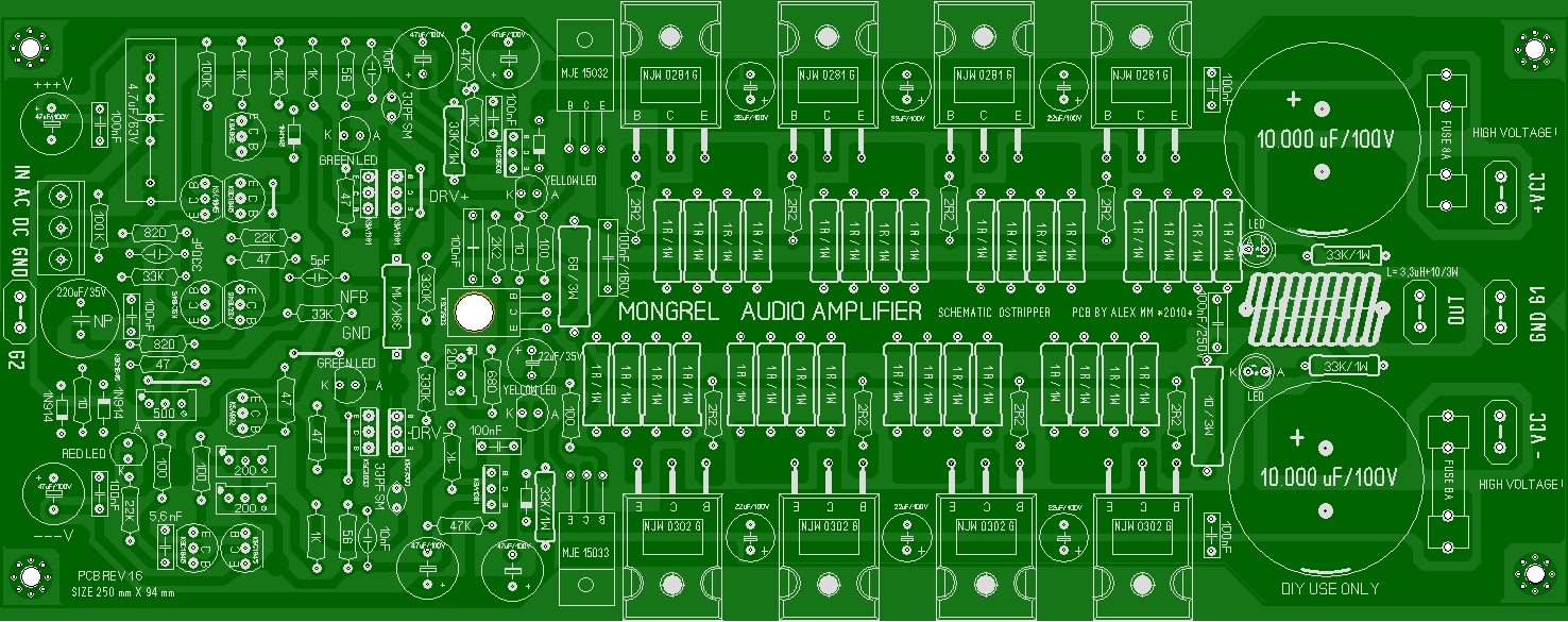

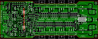

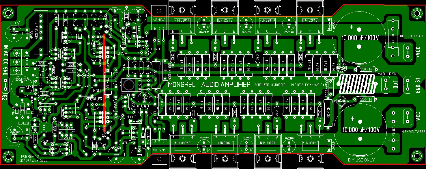

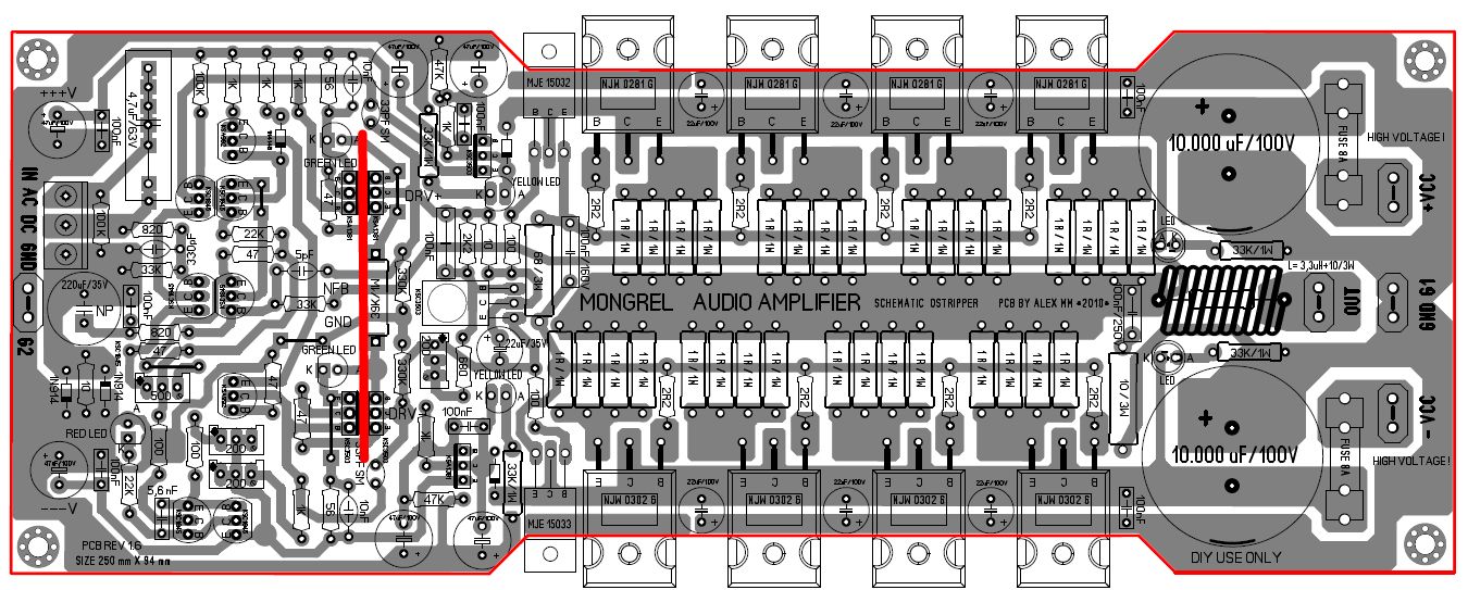

PCB REV 1.6
....as Stanley and Andrew recomanded I have modified PCB like in attachaments 🙂
Regards Alex.

Still , very good boards alex , I do believe your prototype will become your favorite "main amp" ... this amp "kicks butt" ...way better than the others that I have built (even objectively). My classical loving oldest daughter was "truly stunned" upon hearing her "Classical thunder" FLAC's on this setup. She was surprised that she only saw them(the amps) on the PC in LT/design phase just a short while ago.

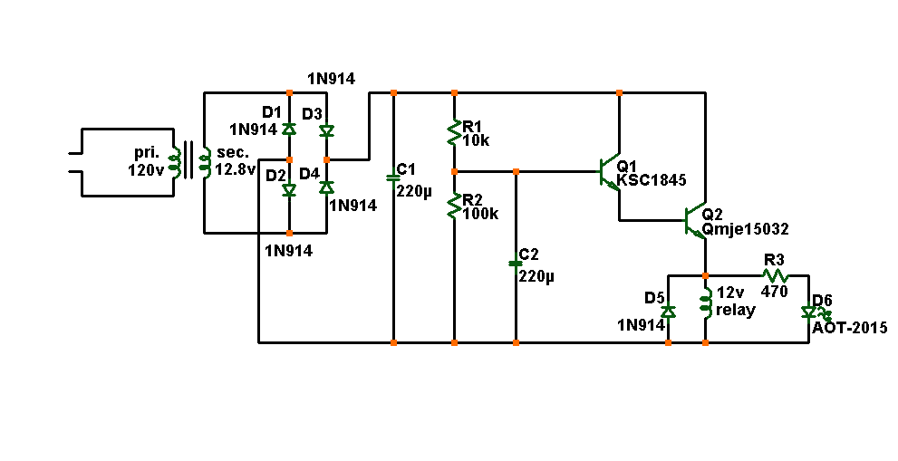

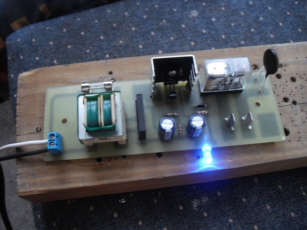

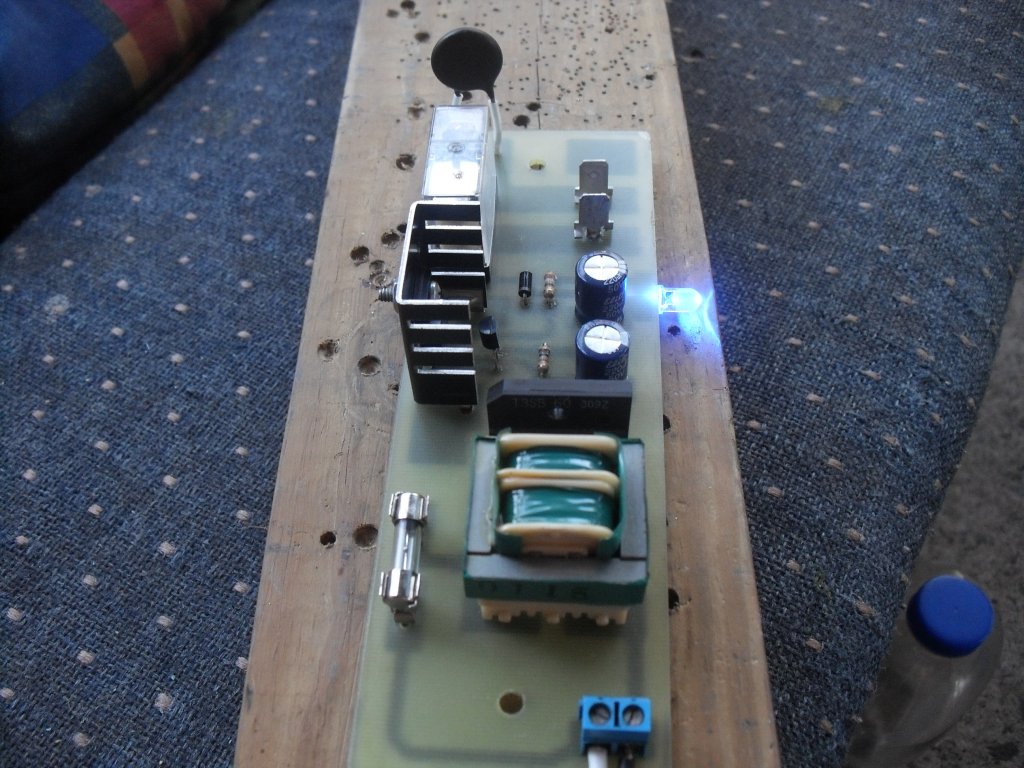

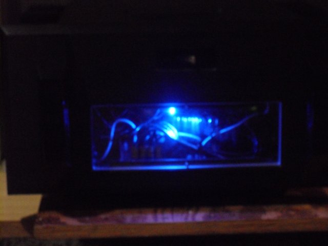

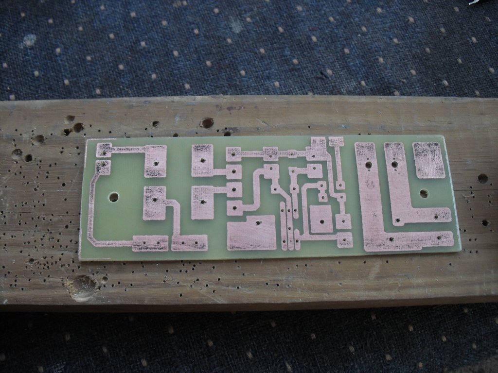

On to the "Board of the day" ,for those with 600VA trafo's and larger ... a simple softstart with it own PS , triggered by the AC and not derived from the main rails.Used a recycled Microwave small trafo ,bridge and the big relay that switches on the magnetron trafo. Microwave "guts" will always have the perfect softstart components ....
Pix 1 is the flawless , pitfree acid "burn"..
Pix 2/3 are the porno shots of it actually working.
Pix 4 is the schematic. This gives 3 seconds delay after applied AC , charges C2 (220uF) through R1. Since relay is buffered by Q1/2 darlington , many types of junk trafos could be used , just set 13.2v through R1/R2 ratio to get 12V for relay coil.
Last Pix is the superbrite blue led that tells me the main relay has engaged and to warn the user (it's on - BEWARE).

the modified input pins look like 0.2inch pitch.
0.1inch pitch is what Jens used and it works very well.
Swap the DC input with the AC input, if possible.
Solder the input twisted pair to the AC IN and Sig Gnd, on the bottom side.
Leave the shorting plug hanging on the top Sig Gnd pin.
This is AC coupled.
Move the shorting plug to across DC IN to AC IN.
This is DC coupled.
Move the shorting plug to across AC IN to Sig Gnd.
This is the input shorted for testing with Zero signal volts and Rs=0r0

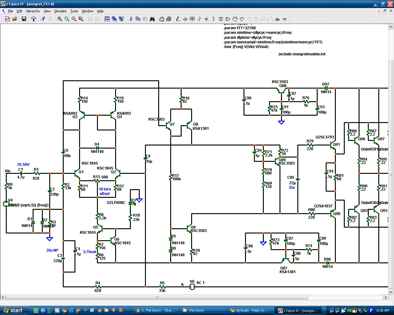

Below is the FX , a strange "rabbit hole" adventure , just like the GX. There is a large following of Koda "modders" that even blog about it. Must be something motivating them. The FX is as good as done ... same as that softstart.. 1 hour for the boardwork , 1 hour to make the dang thing , that's it. !
I can't let the virtual perfection of the GX slow me down in my exploration of the other great designs out there.I still can't believe that the GX sounds as good as it does , I only had a "hint" of what to expect by it's distortion profiles (both FFT and total THD20) , and took a chance.... glad I did. 🙂

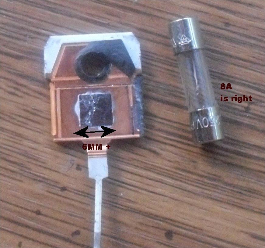

I blew one channel up ... arggg!!
Catastrophy , one slip and POOF!!
Not a bad chain reaction , actually , just the fuses went , then the first pair of NJW's ... and it took out 1 flyback diode.
I got to see what a hard short did to it. NO damage to either the cap multiplier or the GX module (fired it back up with 1 pair OP's). I won't use the remaining 3 pairs for this amp even as they test good. Have 16 more pairs.. so no sweat.
I am actually glad to see the amp blows up "gracefully". 😀

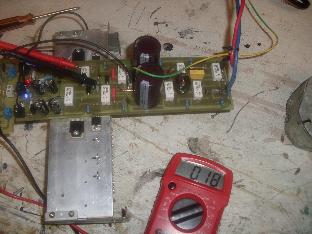

I know I must be on the right path if those "down under" want to build. 😀 Upon redoing and cleaning all the flux off of everything (that and a piece of aluminum milling - arggg!) The bias is even more stable , can't shake 20mV (75mA w/.27R emitter resistors) from 10C in the morning to 35C in the afternoon. If one would have to service these amps , they are so easy.
On the test jig ... 17mv @ 45 volt rails (pix1)
The poor NJW0281 had bubbled tinplate on the thermal inteface .. it must of got real hot in the couple seconds before the fuses failed. (pix2 below) note the nearly 1/4" (6-7mm) dies ... no fake here!
(Pix 3) happy again 🙂🙂🙂... Damn .. I had to build three amps , will be MUCH more careful now... a lesson learned.

I don't expect a fuse to save a transistor when an accidental short occurs.
Your 8A fuses in the supply rails seem very high.
I use supply rail fast fuse rating = 50% of Ipk, where Ipk=Vpk/Rload.
For a two pair output stage possibly going to 100W into 8ohms Ipk~5Apk.
Therefore I would use an F2.5A fuse for 8ohm speakers.
For 100W into 4ohm I calculate that to be F3.5A.
Quasi uses the same rational. His fuse rating = 50% of Irms, which reduces the 4ohm fuse to F2.5A

I agree ,andrew. they are what I had on hand , This is a 200w setup so I was thinking 7A. the 8A did save any wiring , PCB traces... and actually saved the speaker... 🙂
