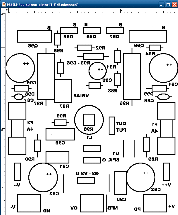

OS, any chance you could do a "parts mirror" for the PB60LP ?
20 MINUTES...done.
It is in the "PB60LP_complete.zip"
A hint , after ironing and soaking the mirror on top , spray some clear Lacquer (acrylic based) to "set" the labeling.
OS

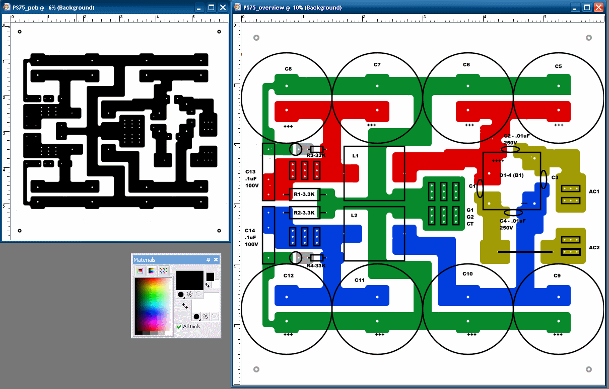

I WILL keep my promise , because when I have my PB250/CX1.1 and the new one (PS100) , the BIG power board , the old one will find your home. With your "cap trick" on LT , I have hit the "next level". It has shown me why the DX/aksa55 sounds as it does and how all the others stack up. Which means I "owe you".

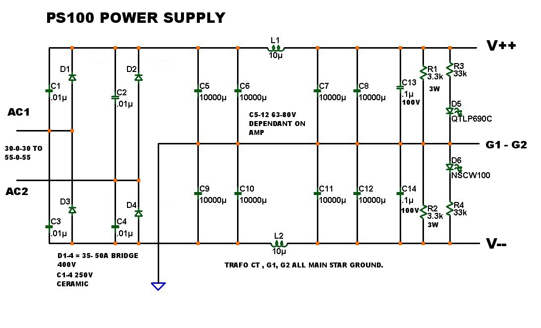

Below is the "BIG" power board .. 100,000uf is the max you can stuff it with , 50A bridge, CLC layout , snubbers , and red/blue leds so you won't die playin' with it. VERY expensive to do 100kuF - (70$-100$). If you use it for the little amps (PB60LP) or run the big one at under 60-0-60V you can fit 18k X 8 ...
:eek::eek: 144,000uf ($104). For audiophile use this should be good for both power boards. I am poor , so I am just going to buy 8 /6800-8200uf units .. I guess 54k + the 20k on my powerboards will just have to do. :eek:
One other note , board is setup for this bridge : GBPC5010W-G Comchip Technology Bridge Rectifiers
Any fairchild 25-35A bridge has the same lead spacing. :)
"PS100_complete.zip is the "package" .
OS

That rectifier pad looks like you could add more vias to make it compatible with many more rectifiers. Same with filter caps, and would it be possible to add pads for local bypass to each one? I find a lot of SIP type rectifiers in junk amps, sometimes attached to a heatsink. Does the rectifier fit in the bottom of the board, possibly for fitting to the main heatsink? Also, could you allow for use of a common-mode choke?
- keantoken
- keantoken
I made the rectifier pads even bigger with the snubbers spaced out even further. I really appreciate the B. Cordell and N. pass sections on the forum , they agree what I have made is the best "bang for the buck" (CLC) , as far as unregulated suppies go.
As far as local bypass for each big cap.. B_S!! That was discussed and dispelled (I read the whole B.Cordell-power supply interview). One good .1uF/250v at the main PS OP and another good one (low HF ESR) on the amp powerboard will be more than adequate.
If you drilled a 3/16" hole directly at the center of the bridge pads a 35-50A bridge could be thermally mated with the case or plate below if you spaced the board with 3/8" (10mm)spacers ... many, many options.Not everyone has the same parts , even as the mouser 50A bridges are just $3.79 !! :eek:
Chokes - Just about any mouser pre-formed from 3.3uH to 20uH will fit , as well as any you make your self. One could even put 2 -.1 / .33 R 10-15w resistors for a CRC setup.

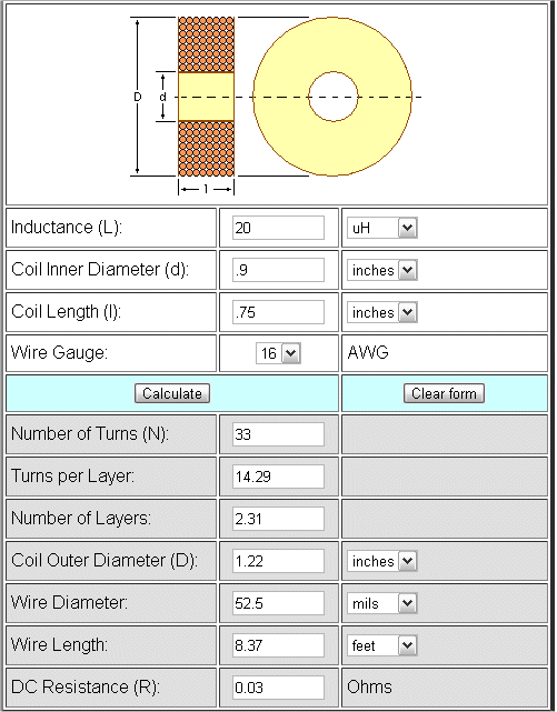

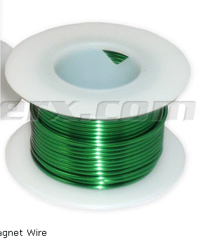

Tried to steal magnet wire from the primary of a microwave trafo... :mad: Did not work to good... :( Nicest stuff I could find was here: Colored Magnet Wire
I like the green stuff (16ga.)
For those who need to know , according to this formula ,
L= (d^2 * n^2)/(18d+40l)
where:
L is inductance in micro Henrys,
d is coil diameter in inches,
l is coil length in inches, and
n is number of turns.
Or , if you are lazy... Air Core Inductor Coil Inductance Calculator
So , for my PB60/250 .. 14 turns of that pretty green magnet wire at 25 X 25mm coil size = 3.37uH
For the PS100 , I went here to be lazy ... Pronine Electronics Design - Multilayer Air Core Inductor Calculator
and I get 20uH 2- layer inductors (with the same pretty green 16ga. wire)
with 8 + feet and 30 turns in 2 layers (approximate). So 1 spool of the 32ft. 16ga. will do the PS and both amps easy.

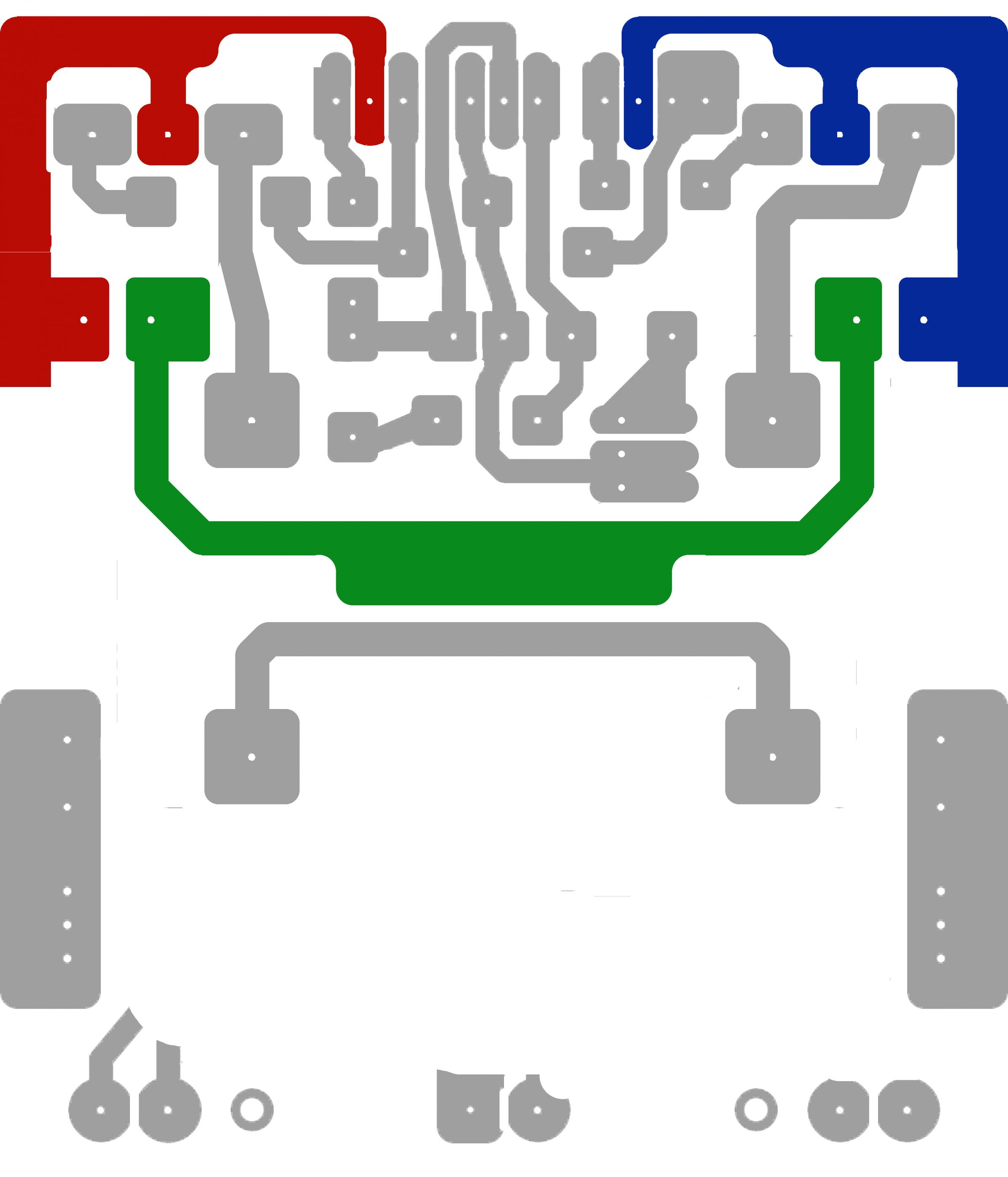

Hi OS
A few of points on the PB60LP PCB design.
In order to make everything fit inside my case I'm using C94/C95 as the 2nd half of the CLC, and they will be outboard 20,000uF caps. This raises the point that G1 tracks are long (and not very stiff in my mind). I believe the PCB design could be fairly easily modified to have G1 as a broad straight-line track directly from C94 to C95. This would stiffen G1 considerably in my opinion.
With G1 redesigned, then C96/C97 decoupling could be physically placed closer to the output transistors, eg connected to the rails located between the output and driver transistors and connected back to the new G1 track.
Also, I note the euro-conn NFB termination goes nowhere.
Your consideration on these points would be apreciated.
Craig

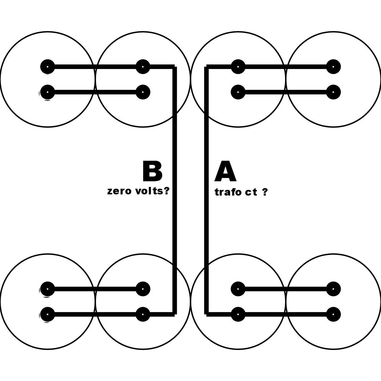

trafo centre tap twisted with AC secondary to the rectifier and passes through to be twisted with the DC after the rectifier to reach the junction of C5 & C9.
Do not take the pulsing cap charging centre tap currents to the main audio ground. DO NOT!!!
Break the connection between C6 & C7. Since you have separated the two halves of the ground on the PCB, you also need to break the connection from C10 to C11.
Take the junction of C6 & C10 to the junction of C8 & C12. That becomes the PSU zero volts and take a lead from this output to your main audio star ground.
OK , I split the grounds between the 2 banks on (attachment 1). "A" goes to the trafo CT and then to the chassis ground ? B is then separate and takes all the connections from both "G1 and G2" . Do A and B then connect separately to the chassis ? Also, is this change because of the CLC ? On the Quasi NMOS PS all amp grounds , the trafo CT , and all capacitor grounds terminate at a central star on the PS PCB.
OS
Also , would the main audio star ground be on the chassis ?
I DO take your advice in these matters VERY seriously , Andrew. While searching the forum for grounding info , your posts were everywhere. :D
OS

I already am redesigning the PB60LP (below) I can't go straight , but I can get a lot closer. NFB comes through a shielded wire with the shield at output potential. Wire can go beneath the board from L1 input to NFB terminal. Better than snaking it all across board.
OS
