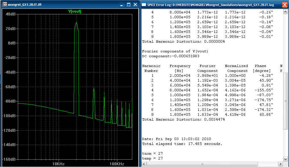

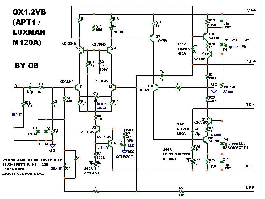

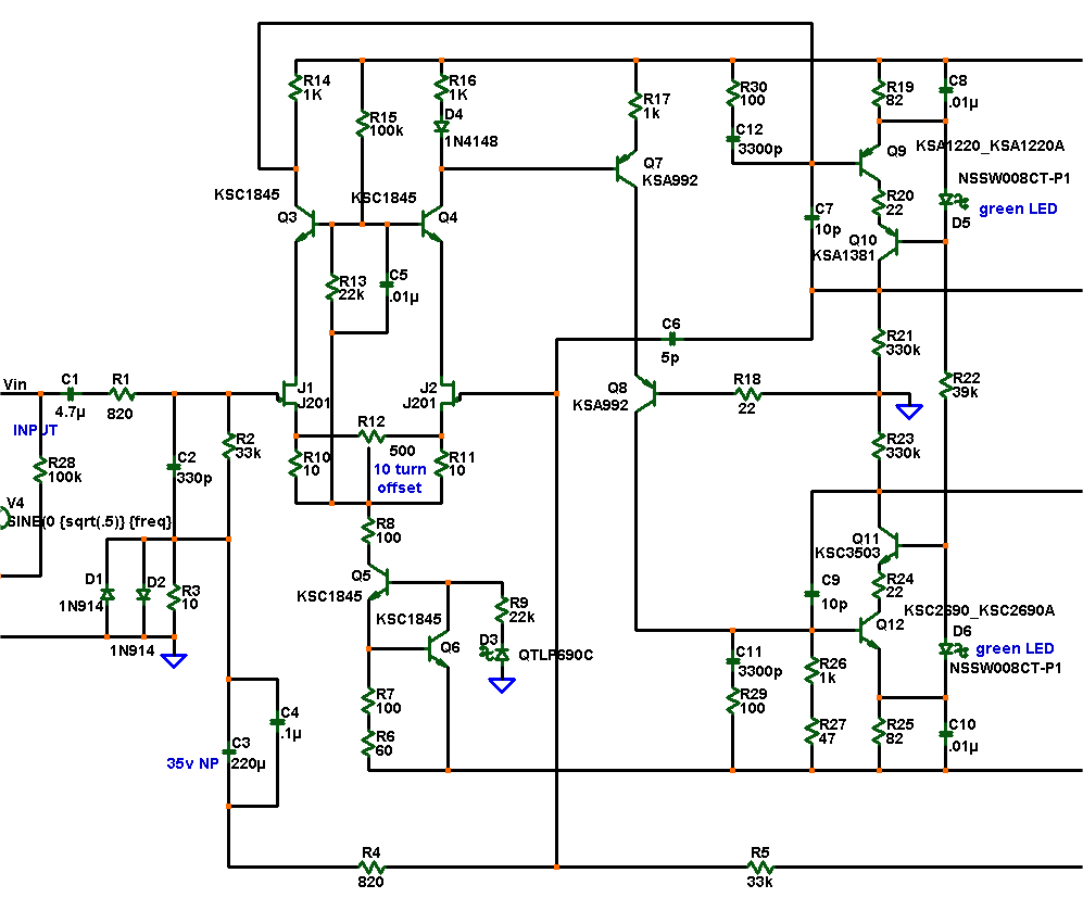

The GX(apt1/luxman-M120a) . is finally done. 🙂 It is at the root of the mongrel website as "GX1.2VB_complete.zip". I still have to finish the "top mirror" , but one could make a working circuit as is.

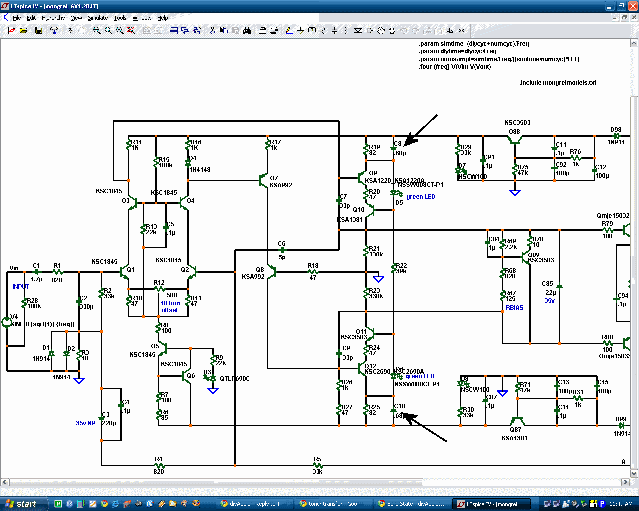

The layout is immaculate (attachment1), the circuit exists in the world several hundred thousand strong (most luxman class AB products). My version is cooler 😎 .. you can use almost any TO-126 VAS driver (Q9 and 12) , and use almost any input pair considering the 15V cascode voltage reference for the LTP and just 2.1V for either VAS device. I have tried the j201 FET , ksc1845, BC547C ... anything.. 😱 the amps specs change very little... A SUPER forgiving circuit. 🙂 Also , the 2 magic resistors (R20 and 24) are supposed to minimize "memory distortion". If you don't like them, jumper them.
One might ask WHY are there 3 trimmers onboard ?? 😕 The one (attachment 2 -R27 "LS adj.) compensates for the unavoidable imbalance between P and N channel devices which can not be avoided with modern semiconductors. Distortion falls by a small margin so this is worth another 2$ part cost.😀 The constant current adjust is INVALUABLE , you can set the VAS average current , use FET's or BJT's (attachment 3 - FET) and set a range for the Vbe on the power board ... Definitely worth another 2$. The "offset" is self explanatory as even when I built the "supersym" and tried to match the input pairs with my DMM , I ended up with 10mV offset (OH NO), I like 1 or less.
If I was richer I would build a tube amp as to watch the blue glow of the rectifier tubes 🙂🙂 . Being "POH" , I have to use LED's to "get off". D3 ,4, and 5 are both the confirmation of the CCS and VAS cascode operation and D4/5 set the 2.1 to 2.4 volt VAS cascode voltage references. These are the most critical points for this amps operation ,so it is nice to confirm their proper function. On the VAS ,with Q9 and 12, I have tried MJE340/350, (yuk!! 🙁 ) BCxxx,2sa1220/2sc2690 , and many others. This just slightly affects total loop gain but does not destabilize the whole amp in any way. 33, 47, or 56pF for the two Cdom's (C7 and C9)will work, while in the alternative compensation, (attachment 3) 10pF is advised . 33p is the best for slewing and a unity gain point of 600khz. I did include the extra pads for the ORIGINAL luxman two pole compensation "TPC" (C11-12 / R29-30 in attachment 3).

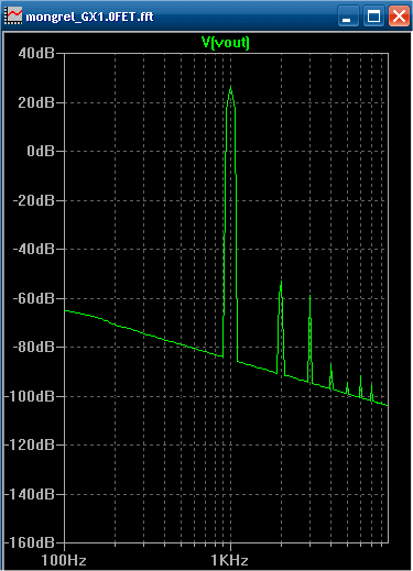

Finally the real reason why this amp was used so exclusively by luxman and the APT1 .... the FFT (with the FET's,attachment 4) shows VERY low high order harmonics with a dominant 2'nd 🙂 . With the Bjt's everthing is 6dB lower. What we have is an amp that is easy to build with many part choices and adjustment options , runs VERY cool using 16mA per rail and can be built EXACTLY as the LUXMAN M120a .. they still make 2sa970/2sc2240. Who can beat a 600$ amp "core" for under 40$ ??
My subjective opinion on this amp after reading hundreds of reviews , seeing it work with the "frugal APT" and simulating it , is that even as it has higher distortion than a blameless or a symasym , it's real test will be controlling a reactive speaker load that distorts at 1-5%THD .. whether it has .0001 or .03% THD matters not as it will be swamped out by the real world anyways. This goes for the addition of the FET's as they double the THD but enhance the character of the input stage.

On MY amps (the GX's) , at least in simulation (below) , you just change C8 and C10 to .68 -1uF and it holds .003-4%THD all the way from 1k to 35Khz ..any power level all the way to clipping. Luxman and APT chose well ! 🙂

the cascodes seem to not only have a theoretical effect on the amp (early effect and VAS impedance) ..but low THD out into the ultrasonics . Reading the "sparkling" reviews of both the APT and Luxman ,this also gives a VERY good sound.

Ostripper, be careful about changing the original compensation (concerning the Luxman/APT amps). Adjusting the compensation for my headamp makes the difference between great and mediocre sound quality - I discovered this just in the last several days. How much have you experimented with compensation on real boards?

I deeply considered this and have the pads for both the luxman and basic APT1 compensation on the prototype Voltage stages (GX1.2). Monday or tuesday, (Texas to here from mouser is VERY fast) I will know. I am going to show the forum the WHOLE process (boards , construction , and testing/abuse) 😀 .
I have really "farted around" with the "supersym" compensation , it has a drastic effect on the final sound. Yet another reason for the sensibility of the modular approach.

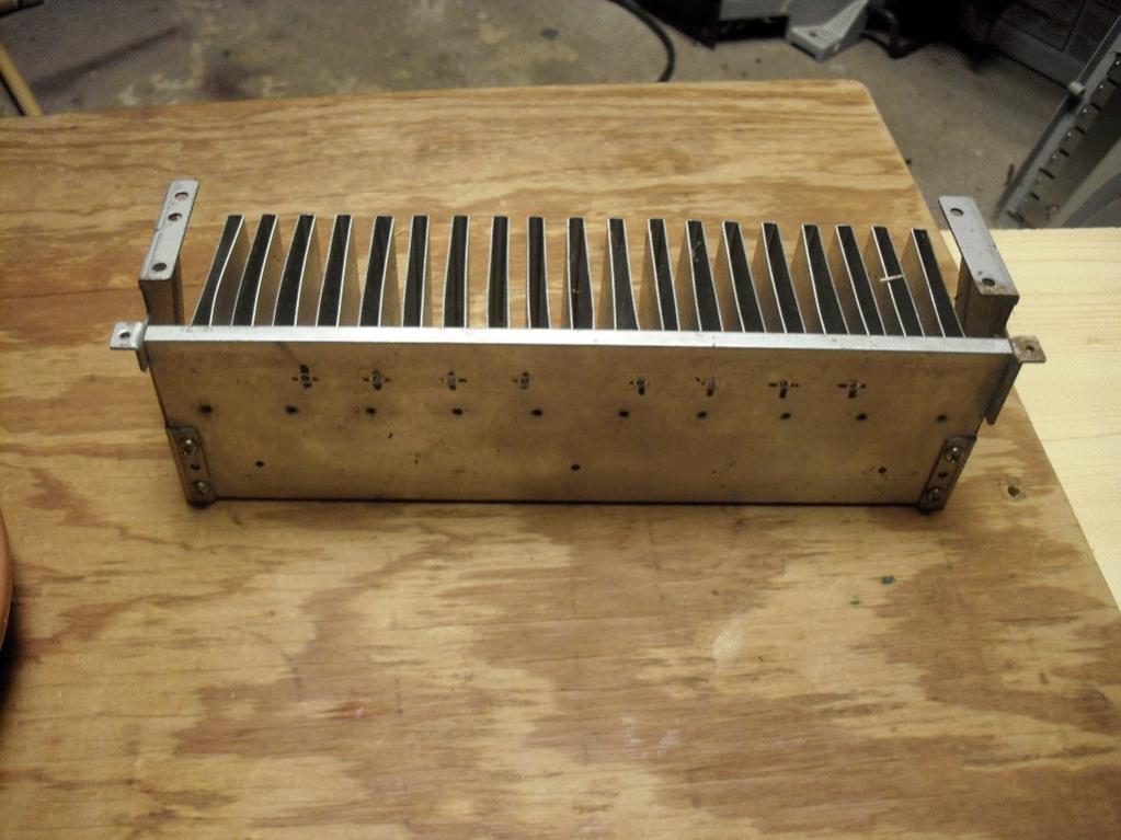

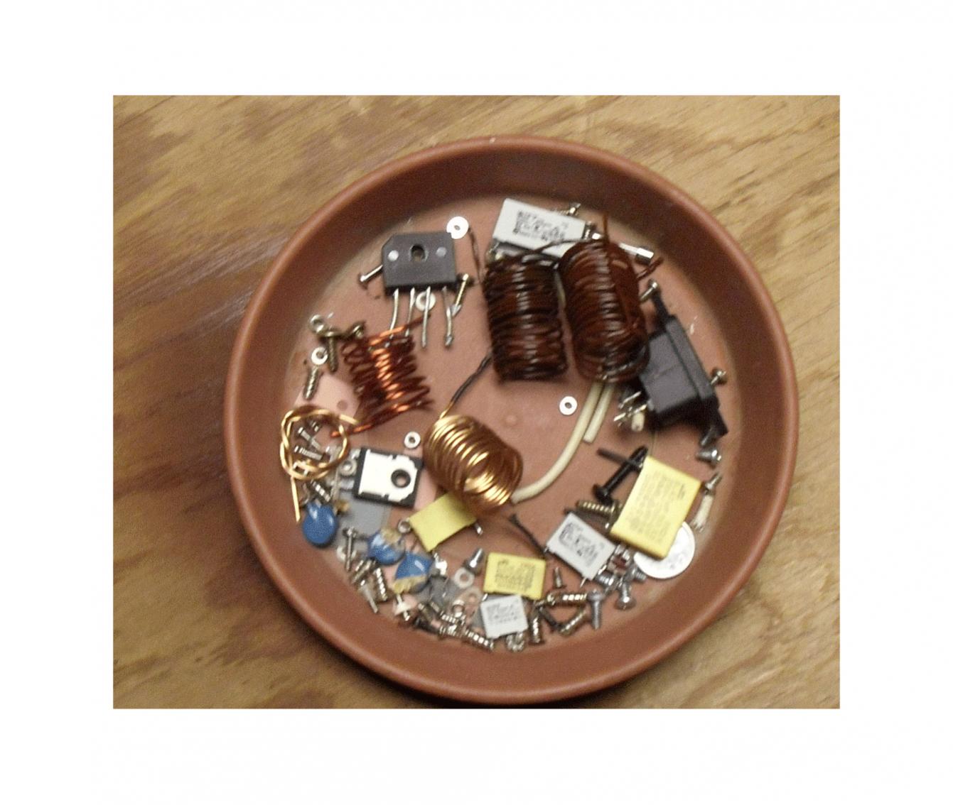

dang holiday slowed it down(mouser order).... I want to build 4 amps !! ...🙁
below)..
I did scrap a test heatsink to fire up the power boards with 1 pair OP's, found magnet wire for my inductors and to-220 hardware for driver mounting in some old PC power supplies 🙂 PS... even scored 4- .1uf/250v polystyrene zobel caps !!

Os the Gx looks good, the Luxman should perform better than the apt, there is quite a difference between them, maybe not obvious at first sight and the reason its good upto high frequencies. The Luxman has so called hawksford cascodes while the apt uses conventional cascodes, the hawksford being superior by quite a margin although there could be stability issues.
This type cascode was named after hawksford after his paper regarding slope distortion back in 1987 I think it was, but in actual fact the oldest reference I can find using this setup is Luxman, they predate hawksford by about 7 years. Nowadays many high end manufacturers use it. My hats off to Luxman, I have studied their amps a few years back, they are excellent, they were far in advance technically to anything else on the market 30 years ago. Look at their folded cascode designs, excellent executions done 30 years ago.

So THAT is the famous "hawksford" cascode. I heard it mentioned but never saw it in practice before the luxman. With either the FET's or BJT inputs it blows the APT away. I did try both cascodes until I noticed the hawkford's better performance over a much wider range. This is the first one I will build and audition over the next few days , but by what I see , I should be VERY pleased.

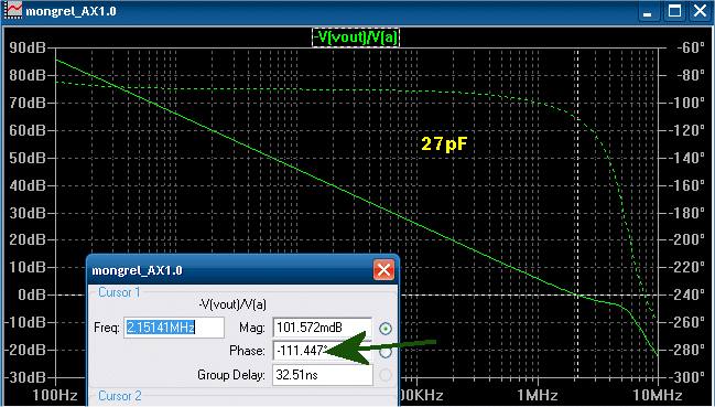

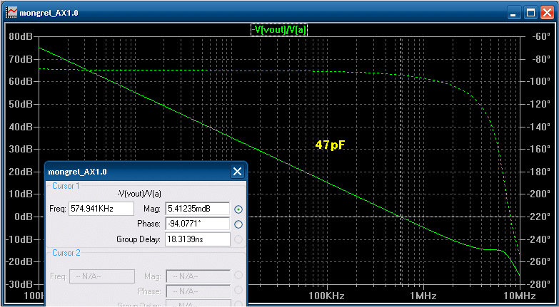

I just want to warn you Sam , swapping cdom on a power amp can destroy the amp.
To find the lowest stable value , which for the AX (blameless) is 27pF, look at the squarewave response in attachment 1. That slight ringing without a capacitive load (8R resistive load only) shows under compensation. This corresponds to plot 2 which shows a -111.4 degrees phase. this leaves only a 68 degree margin (75-85 is best and stable). I could of predicted plot 1 just by seeing plot 2. To be on the safe side I chose 47pF instead of 27pF for 3 reasons:
A. better to be a little overcompensated than not , you may have a slightly slower amp .. but a safe one.
B. 47p brings the unity gain point to 575khz and phase to -94 deg. giving 86deg. margin ..(attachment 3), this amp will drive even a 22uF cap with just highly damped ringing.
C. larger Cdom allows you to lessen degeneration of input pair and VAS increasing loop gain.
I would not do this swap on a real amp without at least seeing the "bottom range" using the simulator. I have never had a warm zobel network or a fatal outbreak of uncontrolled oscillation to date.
