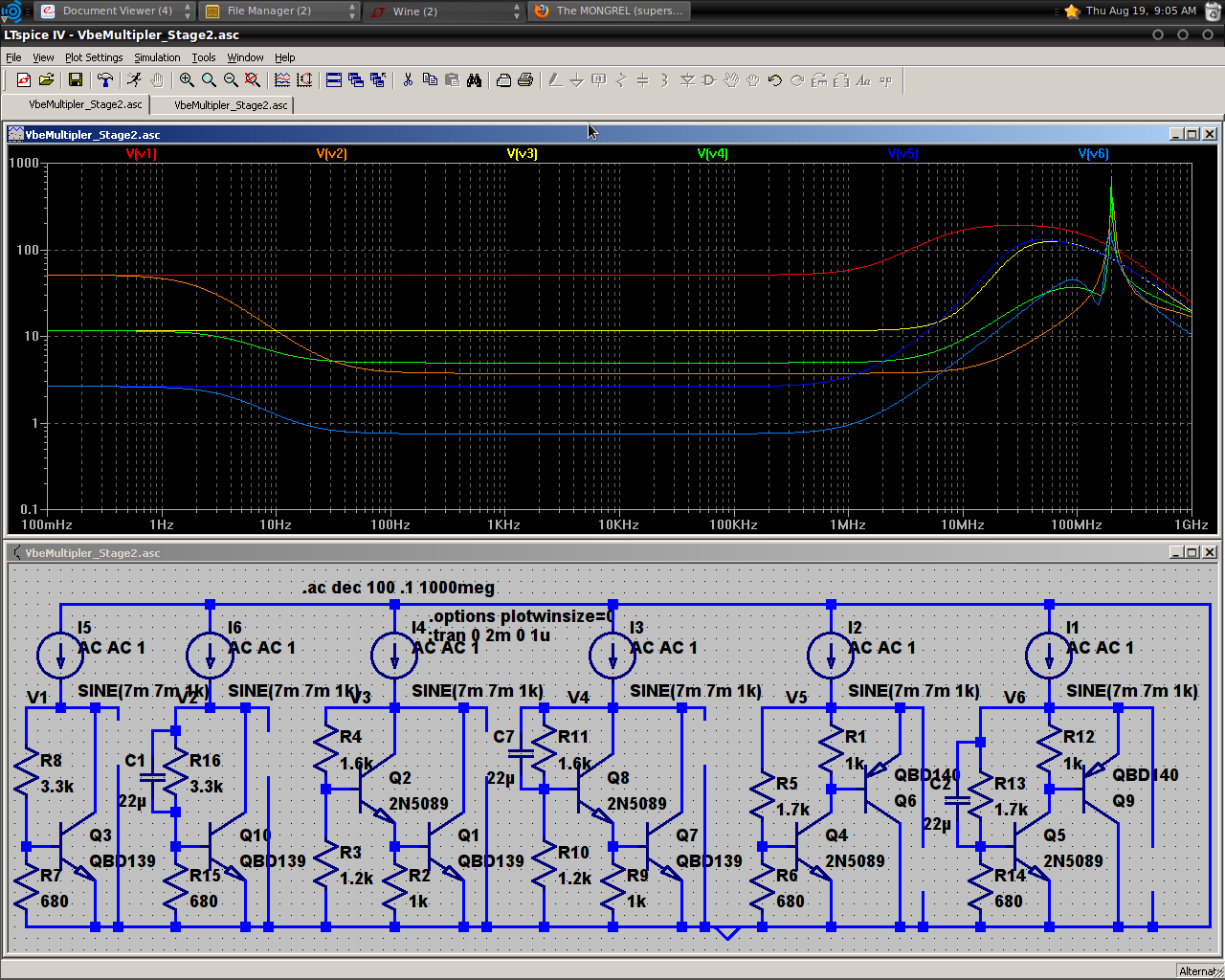

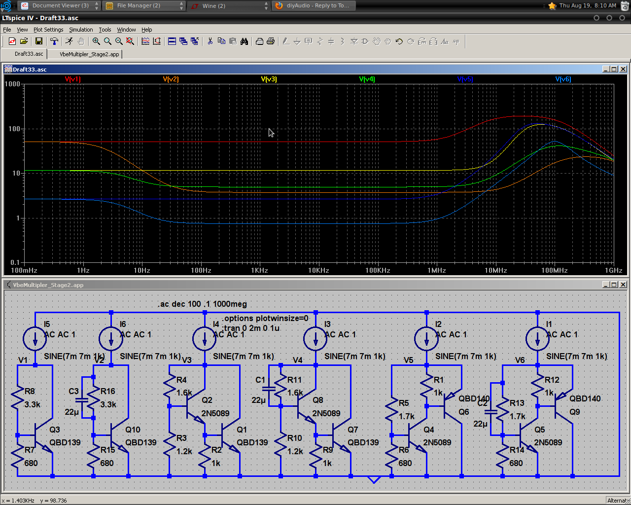

Os I was thinking of asking keantoken to sim a vbe multiplier using a darlington and make the same comparison he did in the aksa thread. Im trying to find transistor models for the darlington at the moment. I dont really know what to say about the outputstage, In all the years I still havent built anything with quasy outputstages.
I don't know if having a model for the darlington will matter, a 2N5089 driving the usual transistor used here would probably work.
But if I were to predict, I would say that the results at AC won't be much different than those of the C-B capacitor mod. In both cases a hurdle overcome is the Ib of the transistor. The Darlington uses a whole other device to fix this, with little impact on other factors. For instance, the resistor network reduces OLG of the stage by its ratio. The cap mod fixes this as well as the Ib problem by adding only 1 passive component.
Gm is still the same, which is the second hurdle. Compared with the cap mod, using a darlington is still worse, and with the cap mod added to the darlington, performance is still about the same.
A better option is to use CFP instead. This reduces Gm as well as Ib, and sims much better. Add the cap mod and it works wonders.
Sims to follow, let's see if I'm right.
- keantoken
impedance range ~ 0.8ohms to 200ohms.
Can I assume that lower AC impedance is better for a Vbe multiplier?
Why is V2 the lowest impedance between 7MHz and 280MHz?
Does that matter in an audio amp?
What effect does adding the bypass cap have on each?
Lower impedance is better, as far as I can tell.
At the frequencies you describe, adding any more active components will only degrade performance in my experience. This is why the single-transistor version works so well there.
The darlington doe have better DC impedance, but CFP is most "bang for buck". Although instability might tip the scales a bit.
I'll add a bypass cap, 22uF .02ohms 22uH and see how that goes.
- keantoken

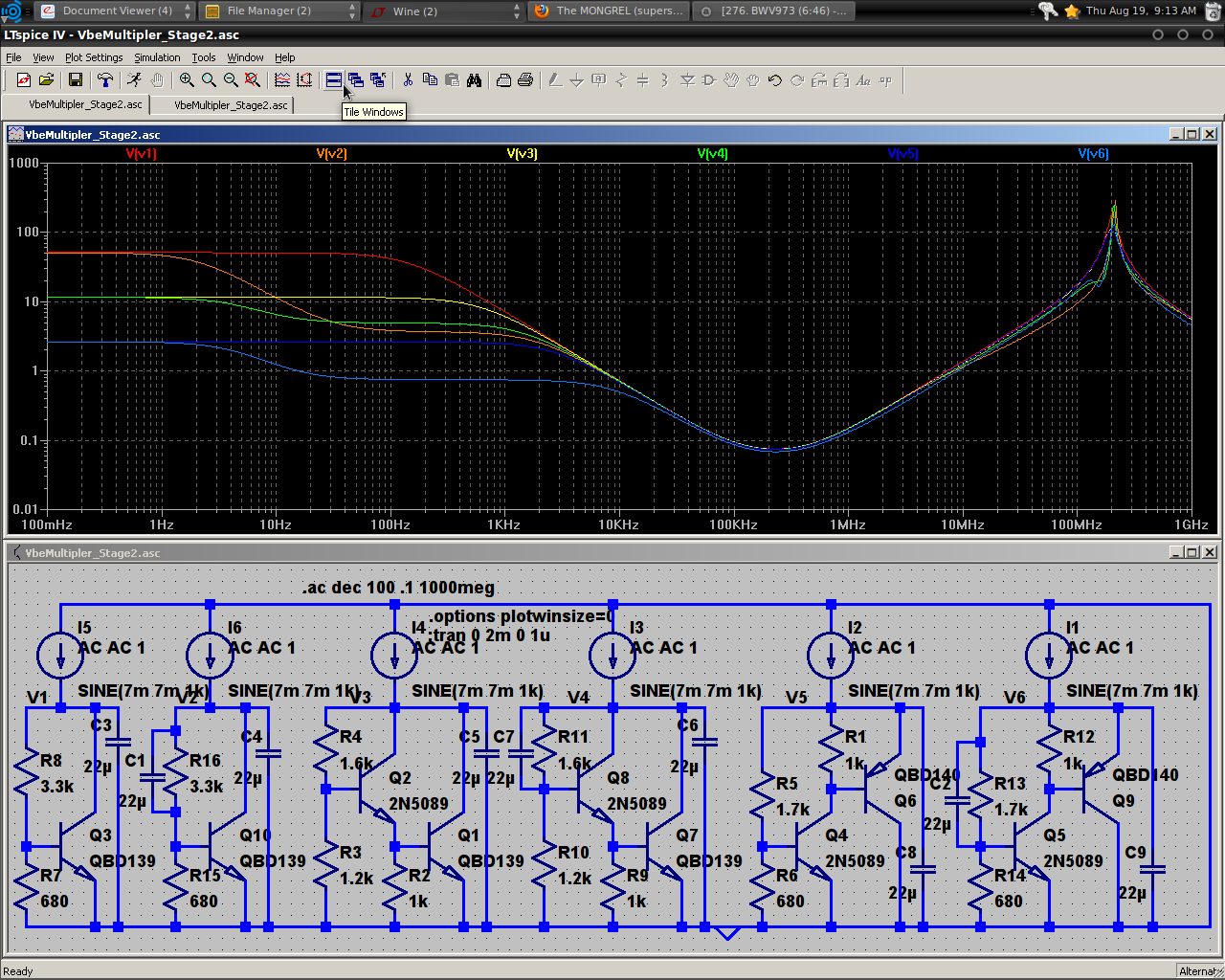

Wait a sec, I neglected cap parasitics the first time around. The first plot are the results. This assumes .075ohms ESR, 22nH ESL, 22uF. ESL is worst-case.
Second plot adds the same spec'd caps as bypass. I thought the spike would be worse, since using the same caps adds the same resonances, and the caps will resonate supposedly, but it turns out the resonance comes from the 22nH resonating with the BD139's Cob.

So.. the single transistor vbe with the cap mod is the winner. 🙂 You can upload here : HFS / This is the "root" of the server. Click the upload folder , a upload button appears on the top right .. then , just like DIYA "manage attachments" , 10 "choose file" buttons appear. Digital instruments are cool 😎 , check out my signal generator/instrument (below) Could not blow the "supersym" even with all those waves. 😀
OS
is it the complex impedance of C1 or C4 that causes the resonant peak?
What value of resistor and where to damp?
A 33 ohm resistor in series with C1 or the "cap mod" works. That is assuming that by the time the amp is on the PCB, we will have any control over resonances at 200MHz!
