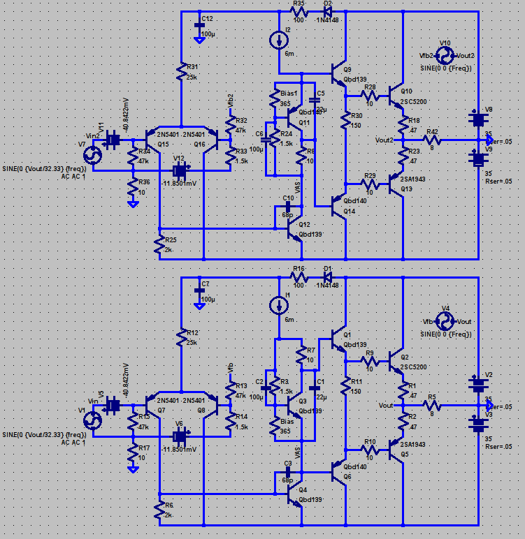

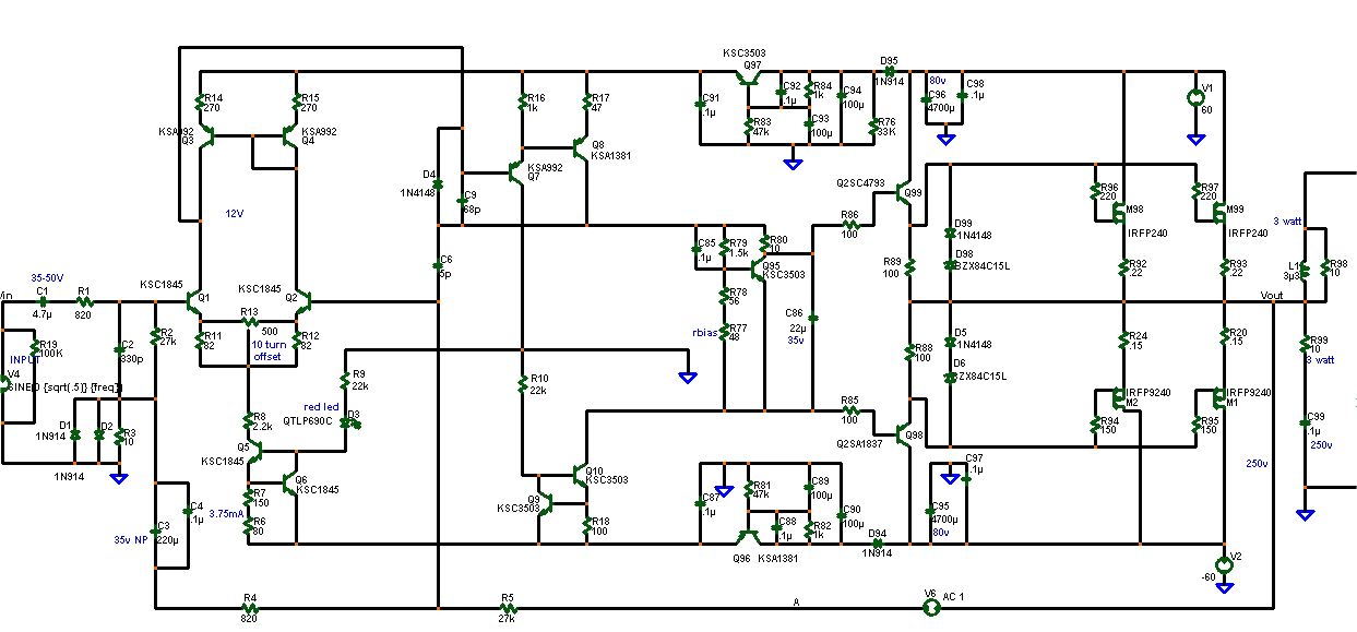

you even forced me to draw it out.
There are two audio signal outputs from the Vbe multiplier.
The upper feeds the upper driver.
The lower feeds the lower driver.
NPN multiplier has the extra resistor in the top feed.
PNP multiplier has the extra resistor in the lower feed.
Whether it's a CCS or a bootstrapped resistor does not affect the two audio feeds to the driver stage.
Replace the lower CCS transistor with a complementary VAS. It looks exactly the same if you travel from +ve rail to -ve rail.
All the drive current flows from the top/VAS, down to the drivers. If we use a PNP multiplier with 10R on the bottom, most of the signal flows through C86 to get to the lower output. If we use an NPN multiplier, the signal must go through the 10R resistor, increasing voltage drop also across the multiplier resistor network, increasing conduction through the transistor. With a PNP multiplier, there is only 1 low-impedance path between the VAS and drivers.

Any chance we could ask LTspice to adjudicate?

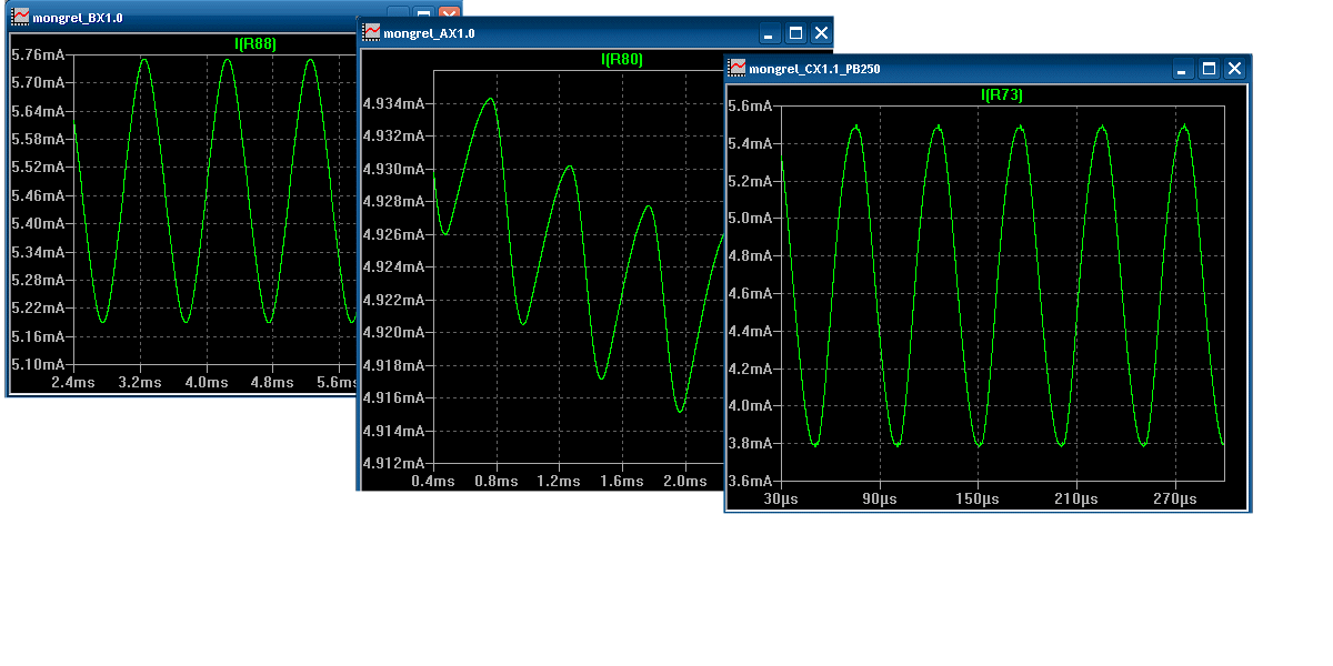

Yes , the signals and voltages are the same on the 2 "sides" , but I see a big difference in the current through the 10R resistor between topologies. I simulated the 1/bootstrap - bx ,2/blameless - ax, and 3/symasym- cx at exactly 6ma- no signal current per amp. All 3 simulate differently using the same Vbe/OPS. ?? 😕 he he ..not really.
That would be dependent on topology.. ??All the drive current flows from the top/VAS, down to the drivers. If we use a PNP multiplier with 10R on the bottom, most of the signal flows through C86 to get to the lower output. If we use an NPN multiplier, the signal must go through the 10R resistor, increasing voltage drop also across the multiplier resistor network, increasing conduction through the transistor. With a PNP multiplier, there is only 1 low-impedance path between the VAS and drivers.
- keantoken
os

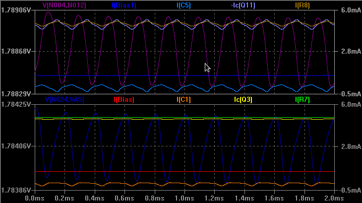

First, all my comments are on the latest schematic, with a single-ended VAS. So it won't help for a balanced VAS.
The VAS is a high impedance output. This means that no matter it's output voltage, it will push whatever current is necessary in order to get the amp's output where it must be. How this current flows through the multiplier determines how well bias is held.
I've simulated this with the simplistic BAKSA circuit. The top traces are for the top circuit, bottom for bottom. As you can see, for the bottom arrangement most of the drive current flows through the cap. For the top one, current is split up through different components. Multiplier impedance is also less, as can be seen in that the voltage between driver bases is halved.

I see , I now know which to use on a dedicated blameless. Still, I must compromise , as I will end up with 4 balanced VAS's and 4 singles which all must work with the same OPS. This makes me wonder how the commercial "boys" and the top 3 amps on the forum get away with mje340's , "floating wipers" , and sometimes NO caps. Can you think of a good compromise ?

Oops, too bad OS, I think it's a false alarm (happens all the time with the Rush)! That is a very interesting design though... Can't have too much gain as evidenced by lots of degeneration, or the operating point is not stable. Conservative on NFB.
EDIT: Now I see Q11 and Q20, this is outside of the signal path so I didn't see it as a "Rush" at first.
To avoid the floating wiper issue, make R79 (post 314) the trimmer. This way a disconnected wiper will only decrease bias to 0. Or perhaps I am missing something?

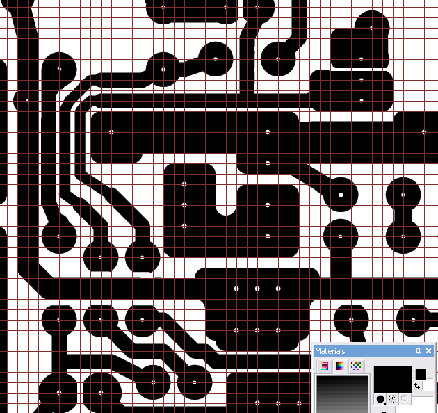

Hi OS
Thanks for developing the PB60LP and answering my questions the other day.
The PB60LP now looks complete on your website, but i did spot a minor ommision on the PCB layout - the through-holes are missing for the output quick-connect. Obviously this is very minor but just bringing it to your attention.
Craig
Craig
Have to post again... freakin' moderation happy fools.Hi OS
Craig
Here is the correction, craig , small as it may seem.(pix1)
You can use these with the 2 outer holes.
or drill the inner hole out bigger and use my favorite , this ..

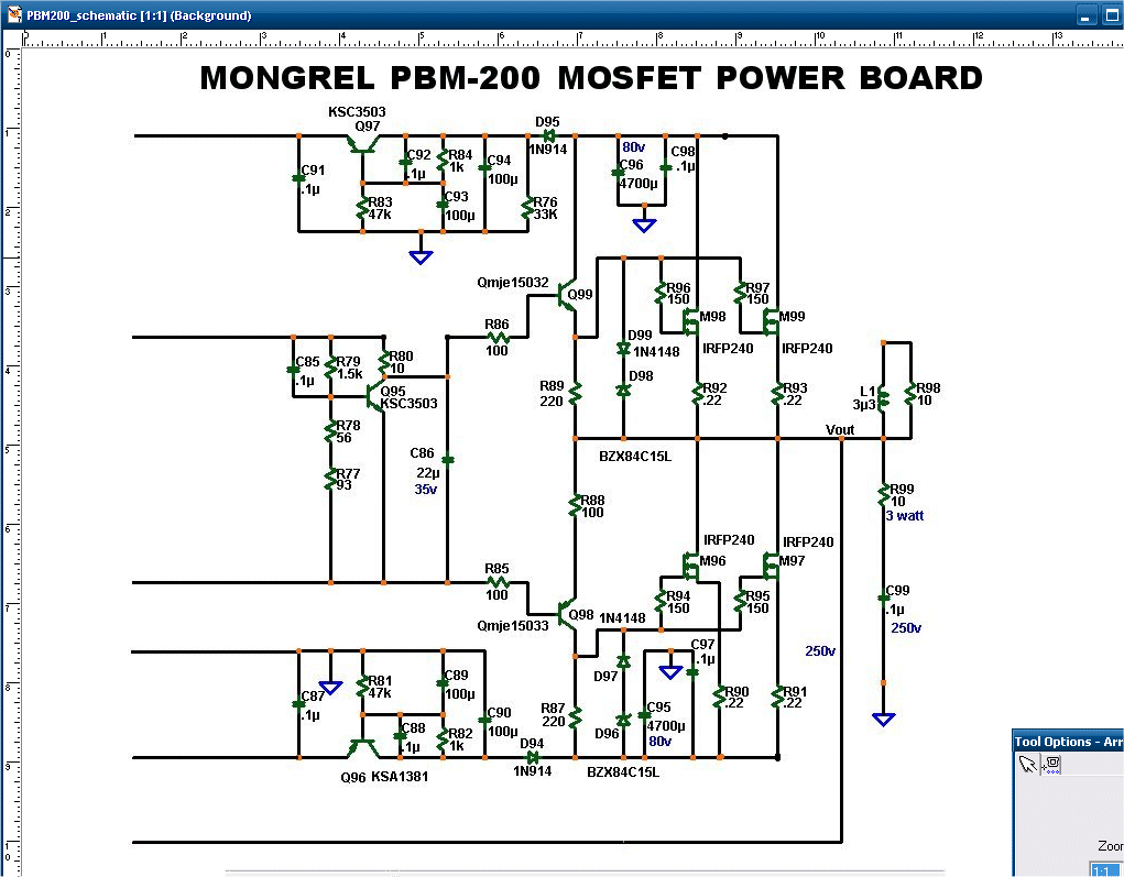

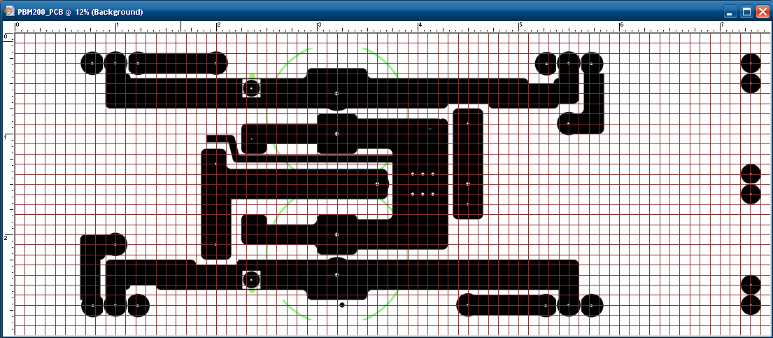

The correction and my new board PBM200 (2X IRF240/9240) is below.
Homemodder , you have mosfet experience , a few tips.. I HAVE built the CX voltage stage with IRF240/9240 , but any tips/suggestions would be appreciated... maybe even the super beta as Vbe ??

Os I was thinking of asking keantoken to sim a vbe multiplier using a darlington and make the same comparison he did in the aksa thread. Im trying to find transistor models for the darlington at the moment. I dont really know what to say about the outputstage, In all the years I still havent built anything with quasy outputstages.

does C86 need to be 22uF - a smaller value allows use of a higher quality cap ?
