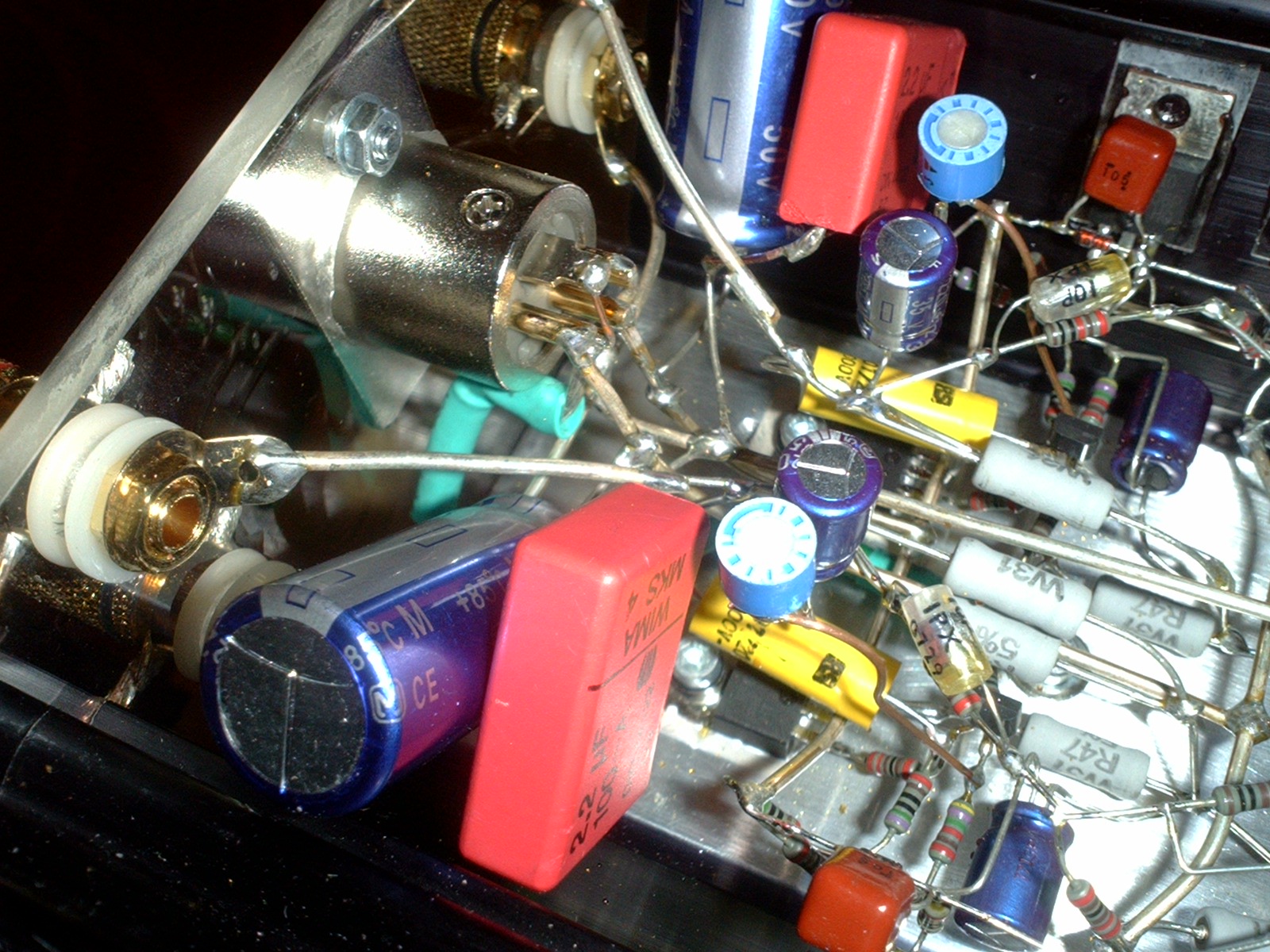

My Mini-A seems to oscillate when I load it with a 4 Ohm three-way speaker (vintage Dual CL 173). Upon switch on I hear a fairly loud steady tone, from both channels. I'd guess it's below 1kHz, but it could very well also be artifacts or distortion from a higher frequency oscillation.
Not wanting to hurt my Mini-A I don't dare to take measurements. Anyone has a hint where to start debugging? The amp works mighty fine with 8 Ohm fullrange speakers.

I already have that one...🙂 (in yellow)
Okay, the blue and the red one are local supply bypass caps (2200u+2u2), the cubic red one is over the 9.1V Zener diode, the yellow one is the 1n cap (C105) and the other two blue caps (C101, C103) are also part of the Aleph CS.
Maybe C102 or setting the AC gain differently would help?
The styroflex I could easily replace with a 10p silver mica, maybe it's a good idea to do so while I'm in there.
