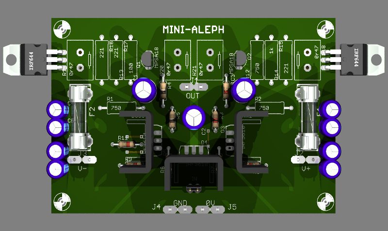

Ladies and gentleman for your amusement and ridicule....
I still need to tighten up the silkcreen a little, but my beer said, post anyway. I call it electrobear.
