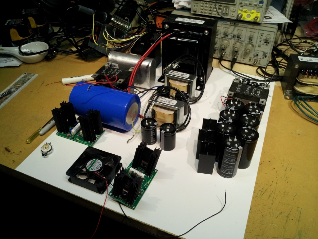

So...the HT will be in one box because that's what's safest and (secondarily) that's what will fit in the space allotted...it's my Midlife Crisis, after all 😉
I've layed the components out on an 18"x22"piece of posterboard to see how they'll fit (see pic).
The filament trannie will go under the big 733A trannie (inside the box, bolted to the back plate) so it's not on the posterboard. The two white spaces are for the 833 B+ choke (back corner) and the OPT (front right corner). I think I might upsize slightly to 19"x23" for a bit more breathing room. Since the 369KX and 733A transformers, the 833 first choke and the OPT will be on top of the box I have a little more room than it looks.
Good thing I'm using the AOT1N60 driver setup in the schematic, there's no way I'd fit another stage of tubes and their associated peripherals in there, nor could I fit a bridge of 3B28s with their filament supplies for 833 B+. As it stands, the driver board will be fit into the white space near the tube socket and the rectifier boards will go along the side walls of the box.
The input from the preamp will come in on the left front side directly beneath the 6E5P tube socket. The output will exit on the right front side directly beneath the OPT. The left and right monoblocks will be mirror-imaged to achieve the shortest and most direct signal path from preamp to amp to speakers.
The fan shown will be located under the 833, which will be enclosed in a 6" OD pyrex glass tube with a vent cap on top.
This thing is about 80% power supply!
My rule of thumb, (sometimes painfully) learned from many electronics projects since I am able to hold a soldering iron: Plan the area needed for your layout carefully, then increase the estimated area by a factor of 1.5 to avoid problems that are difficult to solve later on...
