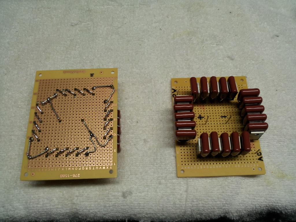

Here's a snapshot of the 1200V schottky diodes with their voltage-sharing 10nF, 1250V caps attached. All 16 of these in the picture will go into one HV bridge for the 833 B+.
I just noticed something...the caps I used across the diodes are rated for 1250VDC, so 4 x 1250V = 5000VDC, looks OK so far.
BUT, if you go into the data sheet and look around, there's a sub-data sheet that lists the maximum permissible AC as only 354V!!
Since the rectifier sees AC, I assume I need to replace these caps, correct?
I guess it's better to find out now than when I flick the switch...

To clarify, that's 354Vrms as the AC spec for those caps, which is 1000Vp-p.
So are four of those in series across the four diodes of each leg sufficient for a bridge rectifier seeing 2500V from the transformer secondary? I can't seem to find any such caps available with a much higher AC rms rating...am I getting myself worked up over nothing?
Yes, they will never see that great a potential across them as many as you're using.

Caps across the diodes will not allow them to share the voltage evenly. You need resistors across the diodes for that. You just need a little bit of trickle current, so something like 2.2 Mohm across each diode should be alright. At the voltages you're working with, you need to be careful with the amount of power dissipated in these resistors... Definitely do the math.

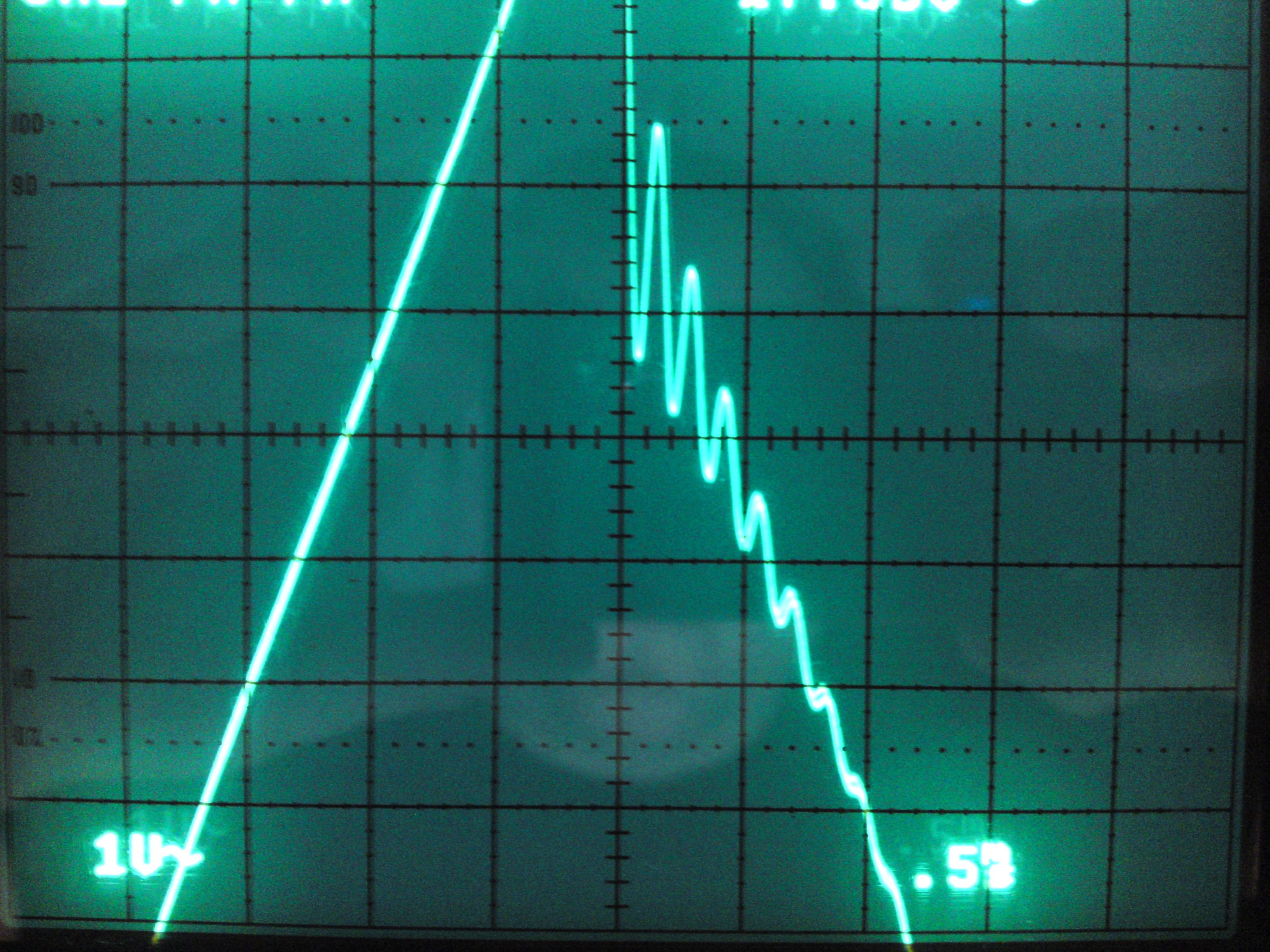

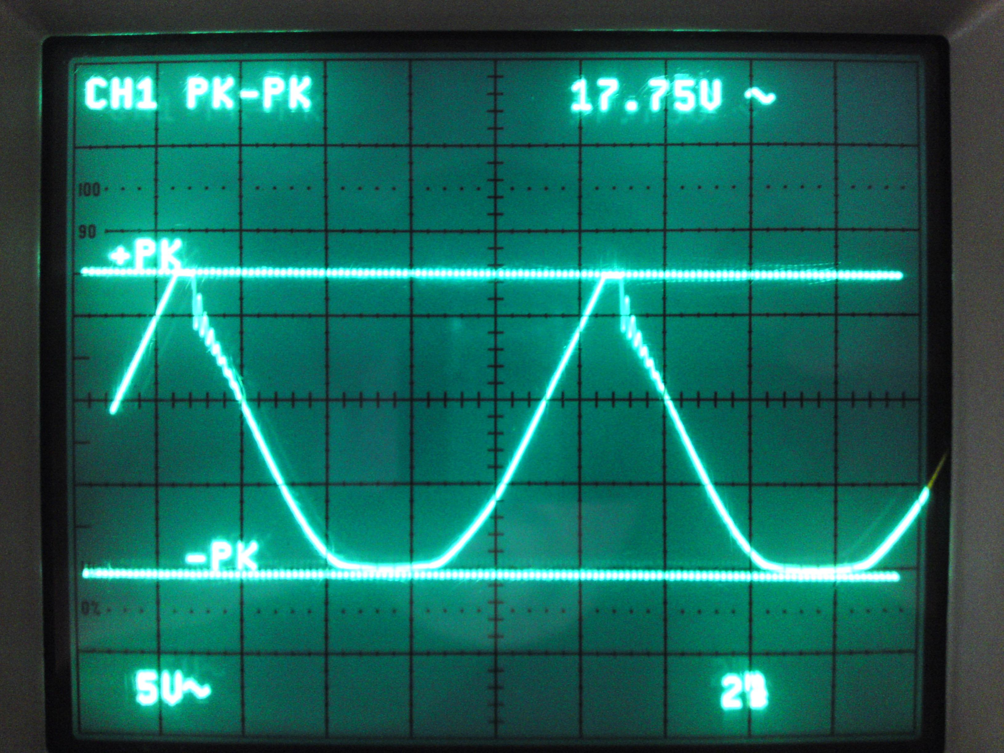

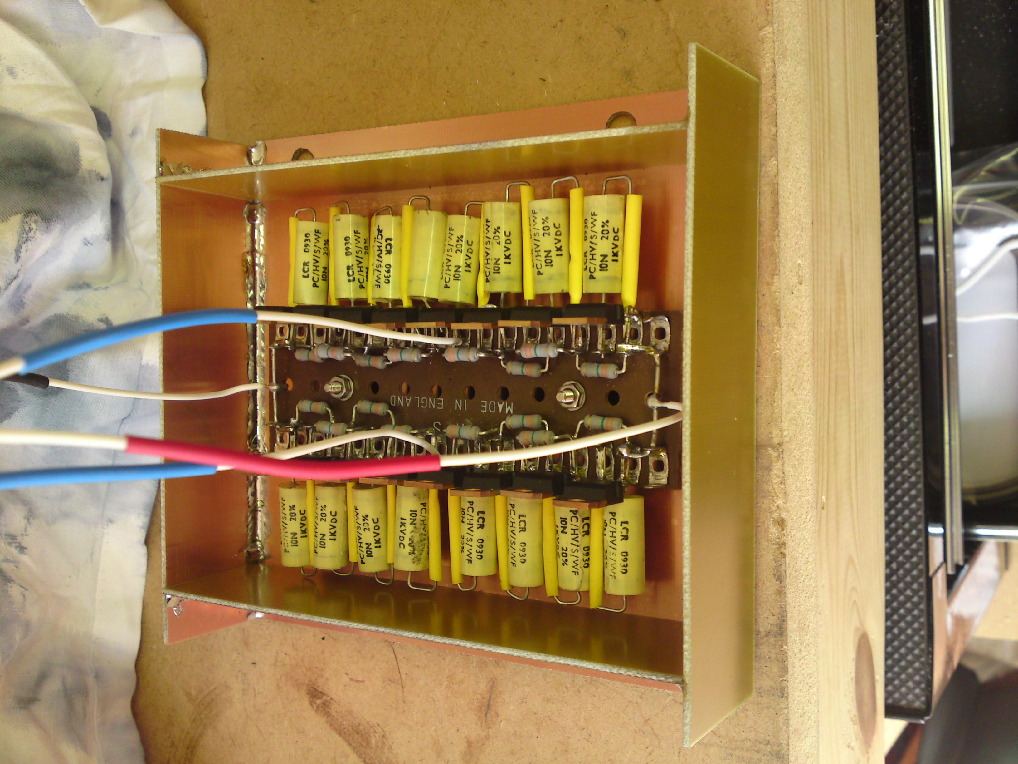

I tried to use both capacitors and resistors on my 1250v Choke input (30H) power supply for my Push Pull GM70. I had massive ringing that I couldnt solve.
I gave up and used 866 MV's in full bridge which gave no such issues.

Interesting! What type of rectifiers, standard or schottky? Si or SiC?
I went with the SiC schottky diodes because of their lack of a reverse recovery spike, which can kick off ringing.
They were STTA512D.
Hopefully you will not have any such issues, but it may be worth testing for!
James
They were STTA512D.
James
They were STTA512D.
James
Ultrafast, Si diodes with a definite reverse recovery (albeit "soft"). Hopefully the use of SiC schottkys will prevent that issue
Definitely a watch-out, though.
Edit: Here's the datasheet for that diode. If you look on p.7 they have a chart showing the turn-off behavior with a serial inductance - it shows ringing.

My inclination is to leave it the way I have it since the diodes are rated at 4800V and the caps at 5000V in a 2300V application. The diodes are all very close in Vf (which is inversely related to leakage current) and I've sorted them into quartets with Vf with .002V apart at worst (most are identical to 3 digits).
I've decided to add one more diode and cap per leg of the bridge, to give me a total of (5) 1200V diodes and (5) 1250V caps per leg, just to give me a little more headroom. I actually ordered 8 extra diodes to make the bridges for the driver circuits, and they're from the same batch as the others, so they should match pretty well.
Turns out Digikey is backordered until June for these diodes so I'm glad I ordered extra when I did, no telling how the next batch will match up with what I have. I don't need to worry about matching the ones in the driver bridges since they aren't in series.
I ordered and received 8 more 10nF caps so I've been able to finish the two HT rectifier bridges (see picture).
I tested them using a variac and dialed it up to 140VAC input, getting 166VDC output in both cases. Everything worked fine, so I let them warm up a bit then I measured the voltage drops across each diode in each leg of both bridges. For the worst matched leg, the voltages varied by 4.5% from highest to lowest - translated to 600VDC across each diode, which they would see if 3000VDC were across the leg, that makes 27V difference worst case. It looks like they balance just fine using the 10nF caps across them.
Interestingly, I used 5% caps, and the worst case imbalance was around 5%...
I will probably pot each bridge in epoxy to be sure nothing can ever short out between the wiring or between the solder pads; I may remove some of the pads between the highest voltage points anyway just to be safer. It shouldn't evolve too much heat at 160mA draw so I think that potting would be the safest way to go.

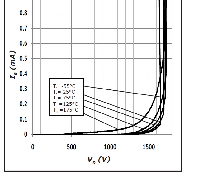

It's good to see that you are testing things at lower voltages when possible. However, note that leakage currents in the diodes is rather non-linear and very temperature dependent. In addition, you can't rely on the matching between diodes. Dude! You're playing with fire here...
~Tom
Interestingly, the datasheet from Cree shows that the Ir is quite steady with voltage and temperature up to at least 1000V per diode and 125 degC. Must be the SiC.
