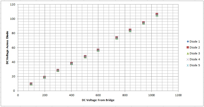

Experimental results:
I had previously checked the DC voltage across each diode in all four legs of each high voltage diode bridge with 166VDC output from the bridge, and the % difference between the high and low diodes in each leg ranged from 0.6% up to 4.5%.
That told me about low voltage behavior, but there was no guarantee that behavior would be the same at high voltage, so I hooked up my Hammond 733A transformer to a variac, connected it to one of the bridges and ran up the DC voltage out of the bridge from 100V to 1040V, in ~100V increments, measuring the DC across all the diodes in one leg of the bridge at each point. The results appear in the graph below.
As you can see, the five diodes appear to share voltage superbly all the way up to 1000V+ bridge voltage, or 40% of the way to the target 2500V. The relationship is very linear, with R-squared = 0.998. At 100VDC bridge voltage, the difference between high and low diode is .16V, and at 1040V it is 1.6V. It's almost like I made the numbers up! But I didn't.
Now, the only caveat I can think of is that this was a naked bridge with no filter and only a multimeter for a load, so the total current was only on the order of a milliamp or so, but the voltage sharing behavior appears to be near perfect. Higher forward currents would cause the temperature to rise a bit, which could affect the results, but I can't see it getting to the point where there would be a problem, especially with (5) 1200V diodes in each leg.
Am I missing something here?
PS: The wider gap in voltage after 600V is where I shut down for a moment and switched to a 5000V multimeter probe, in case you are interested.

Interesting. From that reference:
Question: When diodes are used in a bridge or string configuration is it necessary to place equalizing resistors across the diodes? Also, is it necessary to place capacitors in parallel with the equalizing resistors to reduce noise and high voltage spikes?
Answer: Balancing resistors and capacitors are generally not required when using VMI diodes. A resistors connected in parallel with a rectifier is intended to balance the reverse bias voltage across the series rectifiers. As such, the resistor value needs to be selected such that the current through the resistor is fairly large compared to the reverse leakage of the diode, thereby making a stiff divider circuit. If there are relatively high leakage currents expected in the diode, this can result in a significant power loss in the balancing resistors.
Capacitors connected in parallel to resistors/diodes can be used to balance voltages across diodes during transient conditions, or ringing. Care must be taken to select the capacitors small enough so as not to impact the rectified waveform at the output of the diode.
VMI's diodes are well-balanced for Ir and reverse recovery time (Trr).
Many of VMI's diodes have up to twenty junctions in series. The series junctions operate under many kinds of applications, and all sorts of conditions without compensating resistors or capacitors with no problems.
My diodes aren't VMI diodes, but that does agree with my experimental results for the Cree SiC Schootky diodes.
I would still use resistors to ensure voltage balance. Why play games with this stuff? Just use the resistors and be done with it. The peace of mind will be well worth the extra few bucks you spend. I can't speak for anyone else on here, but every time I've cheaped out on something it has came back to bite me.
I understand your sentiment. It's not about being cheap - hell I'm spending $10K on parts here! It's about adding an additional level of complexity and additional failure modes to the rectifier bridge. My concern is that a "belt and suspenders" approach of adding resistors because they "can't hurt" may actually decrease the reliability.
Looking at the 1000V data, I get 1.6% difference between the highest and lowest diode, or let's even round up to 2%. If at full power I end up with a total of 500V across each diode that's a maximum difference of 10V in the stack, while each diode has 700V of headroom. If operating at higher currents and temps changes the relationship between the highest and lowest diode by a factor of 10X I still have an extra 600V headroom to spare.
