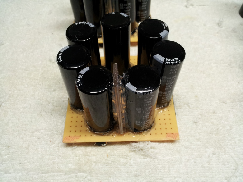

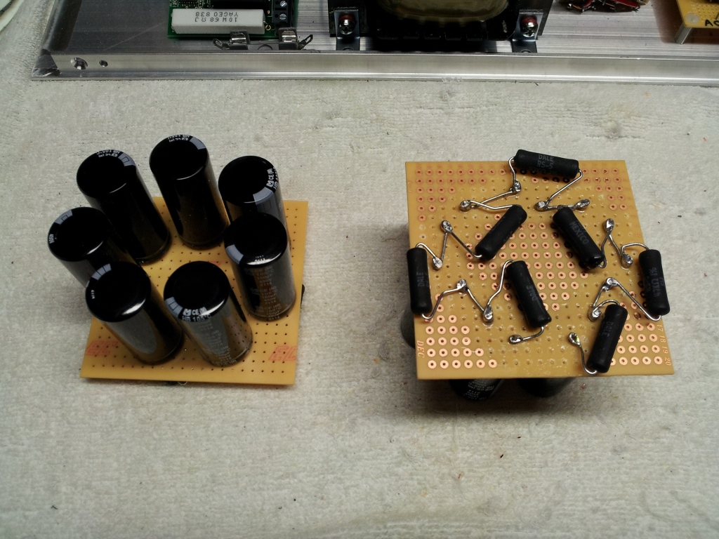

I completed the C1 capacitor banks, with (7) 150uF, 450V TSHA caps and (7) 47K 5W resistors in each. Everything measures fine at 21uF and 329K for each bank. The caps are spaced apart for air circulation and cooling and I may also put some hot melt glue between them for further mechanical strength. The resistors are lifted about 1/8" off the board for the same reason. I can bend them further off the board when I install in the amps if space permits.
As with the rectifier stack, I removed all the solder pads near the HV connections and coated the connections and the board with high dielectric acrylic conformal coating (1500V/mil thickness) to help prevent arcing or surface discharges. I prefer the acrylic to urethane or silicone varieties of conformal coating because it is quick drying, easily removed with solvent and can even be soldered through without removing if you're in a hurry. I think coatings are an often neglected area in DIY - they can offer a lot of benefits for not much cost or effort.

1/8 is a little close. I would almost have them perpendicular to the board. I would not use hot glue on anything in the high voltage circuit. In high voltage heat is a double whammy. It causes air to ionizing and flash over. The more space between components the better.

Like I said, when I get ready to install them in the amps I'll know better how much room I have and how best to orient them. I do envision bending them further away from the board, but it doesn't make sense to do that before I know the ultimate layout.
The amps will have forced air cooling with a fan mounted under the 833 sucking pre-heated air from the chassis and directing it up around the 833. I'll orient the air intake slots to ensure that cool air is directed over the resistors and rectifier diodes.
Oh, and the hot melt glue would go between the bases of the caps on top of the board, not on the resistors - I re-read the post above and realized it might be misinterpreted that way so I edited it...

Ok I see. Ya those big caps could use more support. Are you going to have a filter on the fans? The only reason I ask is high voltage attracts dust. And dust can make a good discharge path.
I've got more experience with big high voltage equipment then any other area of electronics. Just trying to pass on anything that I think might help you is all.

Thanks, I appreciate your input. I'll have some type of low resistance filters on the air intake slots, to minimize the amount of dust that gets in. That's another reason I'm applying the conformal coating as well - dust can't form a discharge path if the circuit is coated with a barrier.
That's good. The more dust you keep out. The less headaches you get, lol.
As for coating, you can us some corona dope.its made by gc electronics. Its a thicker then regular paint. Has a little brush in the bottle with it. Kind of like fingernail polish. Its made exactly for this purpose.

I went ahead and hot glued the bases of the caps in the C1 bank for added mechanical strength, and I glued a strip of Lexan polycarbonate between the first and last caps in the bank for added electrical insulation, since the metal cans of those caps have 2000V potential difference between them. See Pic.

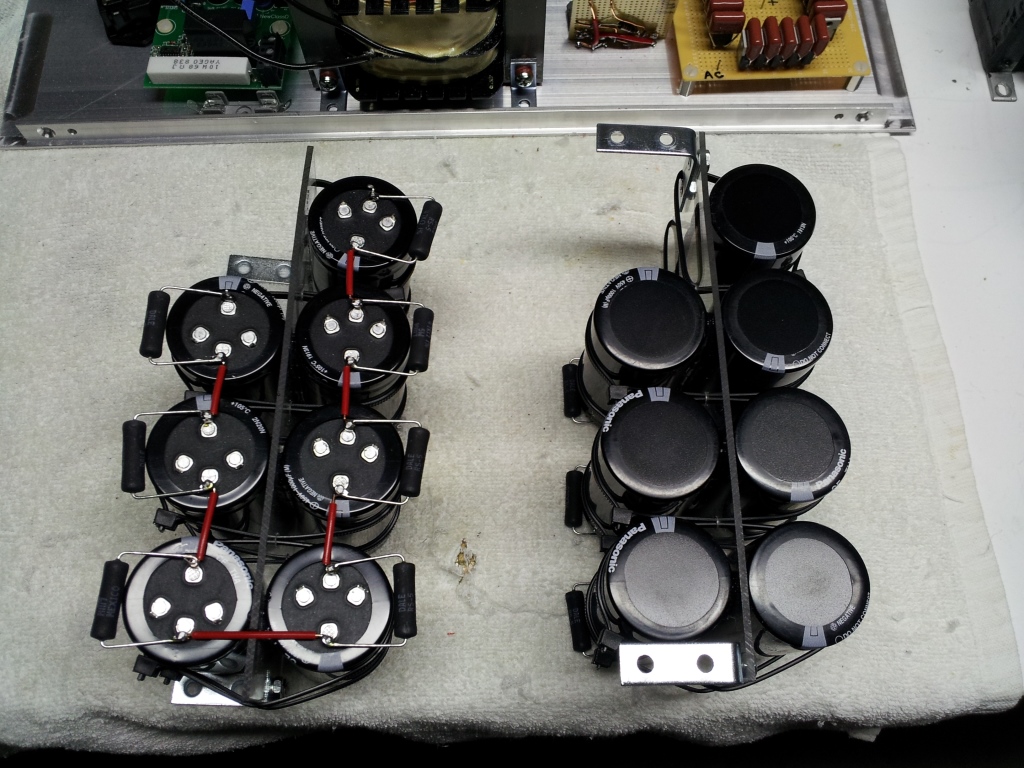

I completed the two mirror-imaged C2 cap banks (see pics). They test at 127uF and 126uF at 120Hz using my LCR meter, a little lower than nominal but well within the 20% spec. The balancing resistors will be bent away from the caps when the banks are mounted; for now they take up less space flat against the caps.
The banks are constructed on a Lexan panel with the caps in series order around the panel. The panel serves to separate the caps with the highest potential difference from each other, and also gives rigidity and a place to mount the brackets. The banks will be screwed to the side panels of the enclosure underneath the OPT; I left some clearance at the back of the panel so the cap vents can expel their contents if something goes wrong. Caps are secured with hot-melt glue and zip-ties through holes in the panel.

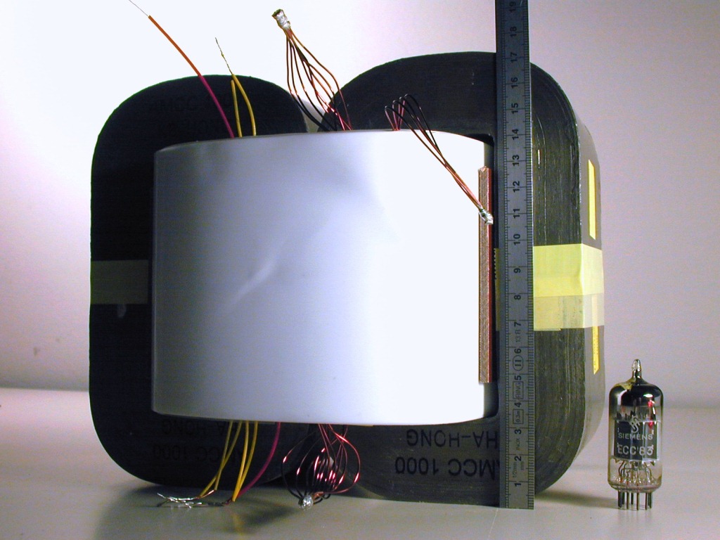

I use a lot of Hammond transformers, including the OTP 1642SE.
Kupfer und Eisen...1642SE | eisen1642se, kupfer | hifi-forum.de Bildergalerie
Ok, the 8ohm outputs of this transformers are useless, but because I have 8ohm speakers only I can use the 16ohm output so I have a Raa of 10kohm and this seems to fit perfectly for the 833C...😛

I received an update from Monolith on the progress of my OPTs. The amorphous cores have been received and the bobbins have been wound. Performance is a little better than specification:
L=68H (spec>60 H)
-3dB FR = 7Hz - 66kHz (spec 8Hz - >60kHz)
32 Hz saturation frequency at 1400 Vrms input (spec <35 Hz)
Attached is a picture of the core from one OPT with the bobbin in place. Note the teflon dielectric. An metric ruler and an ECC83 are in the picture for size reference.
They are still waiting on the laser-cut enclosures; once those arrive the OPTs will be assembled and on the way to me!
L=68H (spec>60 H)
