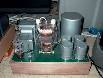

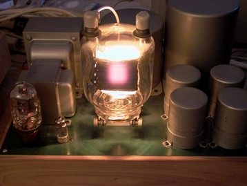

Good morning Matthias..
Glad to read that your 833A amplifier is up and running...that 833A makes a nice room heater.
Some of the older 1 kw tube AM broadcast transmitters use four 833A's, two in parallel in the RF final amplifier, and two in push-pull for the modulator. The Gates Radio units used a pair of 807's to drive the P-P 833A modulator. The HT supply delivers approximately 2500 volts, the HT plate transformer delivers approximately 3000 volts at 1 ampere each side of center, and the rectifiers were mercury vapor 8008's or 575A's. You can see the flashing in the rectifiers in sync with audio modulation. To get 1 kw RF out of the transmitter, the final RF amplifier ran 2500 volts and 560 mA on the plates...and the two 833A's in the modulator delivered approximately 650 watts (in class B) to modulate the RF. The distortion measured fairly low with good tubes.
The glowing plate is normal with the 833A...just make sure the tube gets plenty of air and isn't boxed in by components. Use the heat radiating connector for the plate in particular. There is a maximum seal temperature spec for the 833A (as with most other power tubes). Treat the 833A right, and you will get long life and good service from it.

Yes...the 833 are doing a very easy job in my amp in compare with a RF transmitter 😛.
The 833C have massive graphite anodes and these are glowing comlete after a hour, not a spot ony... 🙄 300W continous power per tube.

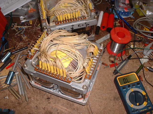

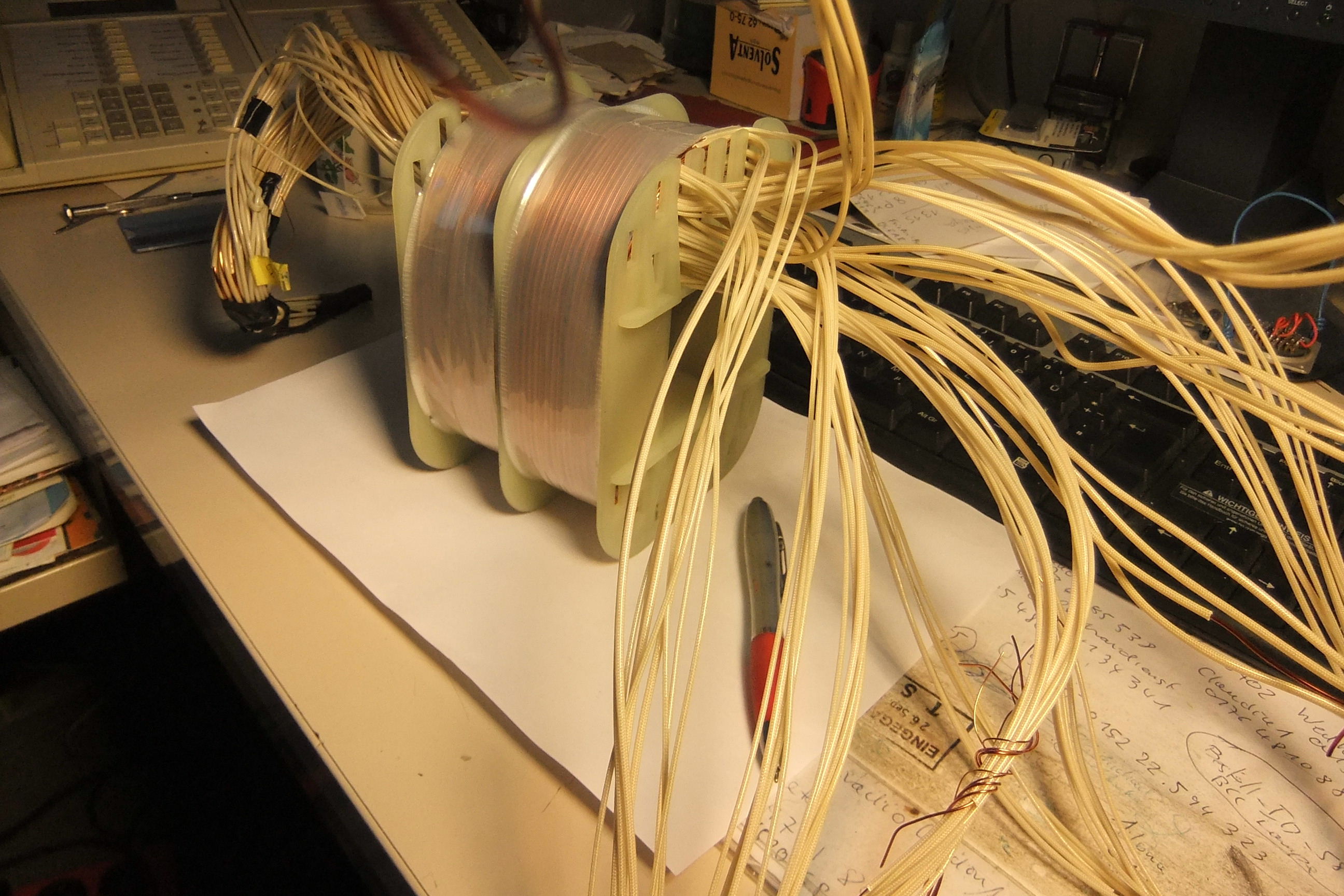

Each complete core (per channel) weighs 14.2kg. Then add in the wire, steel can, potting epoxy, etc.

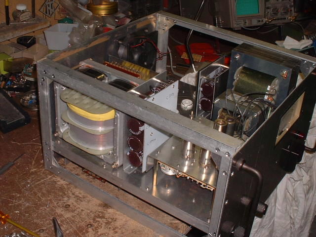

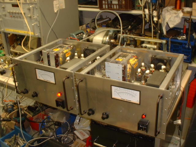

Hi Magz,
I wound two transformer for my hombrew projects. They are similar in size and weight. The measure of them are 170x170x150mm and the ready to fit weight is abt. 14 kg ( 31 lbs) . They are SE170a double C-cores . I salvaged the cores from a wrecked Siemens HF Transmitter.
I made two clones of the MC-3500 McIntosh power amps with these trafos.
Below you´ll find some pics of the amps and the trafos. Believe me or not I need a whole weeks to wound ,wired and test them.
One amp deliver 400W rms. The Plate voltage is 470V .
The measures are:
width: 19"
hight: 6 units (10.5")
deepth: 16,5"
The total weight of one finished amp is 55kg ( 121 lbs)
