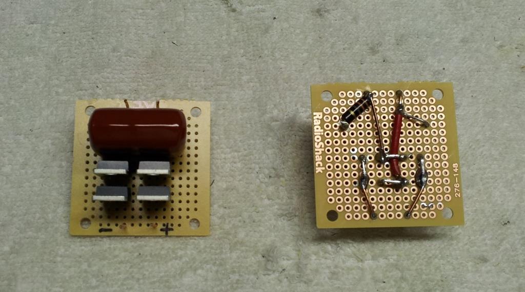

Assembled and tested another sub-assembly, this time the rectifier boards for the driver B+. They contain the rectifier bridge (four Cree 1200V Schottky diodes) and an RC snubber. Works as planned.
By the way, after that picture was taken I went back and removed the extra solder pads between the high-voltage points of the bridge and gave the board a coat of conformal coating, just to seal it all up and be sure nothing was close enough to arc. Just a note for completeness sake...

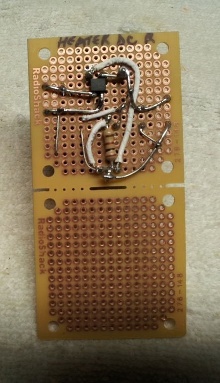

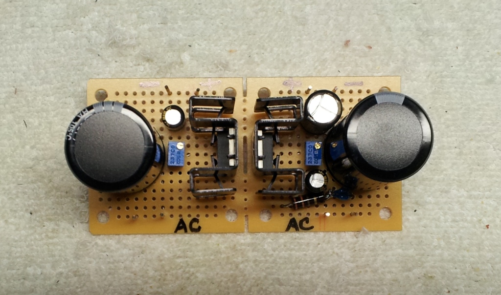

Today I completed the DC heater boards for the 6E5P driver tubes. I mirror imaged them so the wiring will be optimum in both the left and right amps. It's a simple circuit with a 2A, 40V Schottky bridge (SMD) feeding a 10,000uF cap, followed by an LM1084 adjustable LDO regulator. The regulator has 1000uF across the output and 56uF to ground from the adjust pin. I also added an RC snubber across the AC input (20nF C0G ceramic cap and 330ohm resistor).
This circuit is able to easily get 6.3VDC from 6.3VAC, in fact I can get up to 7.5 VDC max, so I can use the 6.3VAC winding on the 369KX transformer. At 6.3VDC I measure only 3mV AC, so it should be a nice quiet supply. I'll have some .1uF caps to ground at the tube heater pins to further reduce any noise from the regulators.
The other half of the two boards will carry a similar circuit (12V) for the 833 cooling fan power, but it will be a little simpler, with no AC snubber or adjust pin caps to ground...after all it's just to power the fans.
Here's a snapshot of a completed board, with both the 6E5P heater 6.3VDC supply and the 833 cooling fan 12 VDC supply. The fan supply is the simpler looking one.
Having these two boards as compact as possible helps me to fit all the rest of the BIG stuff inside the chassis. This combo board will tuck nicely into the side of the amp chassis.
