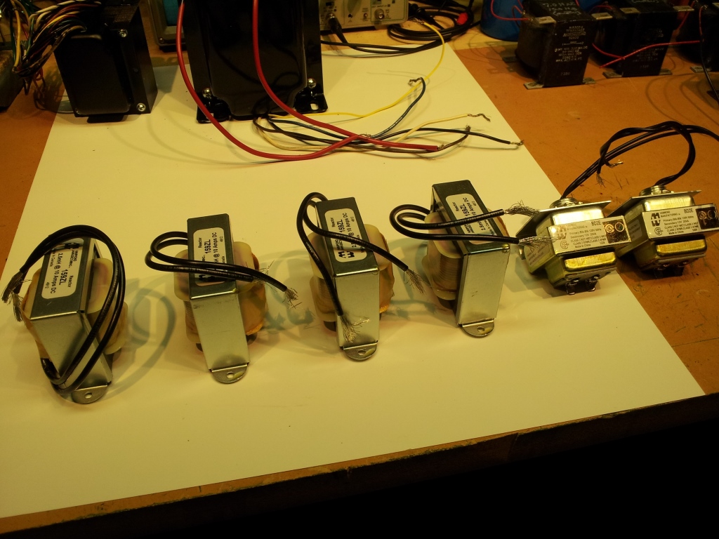

The filament supply chokes arrived today, along with the two small 12V transformers for the fan supply (if I use a fan). Now just waiting on the one 733A and the custom Monolith OPT and choke.
Time to start exploring layouts and decide on a chassis.

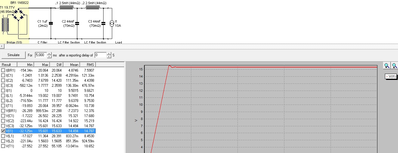

Yes, definitely DC on the filaments. I'll be using Rod Colemans excellent filament supply boards which use a CCS and Gyrator to control the current and voltage. I have to parallel two per side at 5A each to get to 10A. The chokes in the post above are rated at 2.5mH at 10A, so they should do.
Below is the PSUD simulation for the supply to the Coleman boards. Ripple will be ~40mV going into the boards, and in the uV range at the tube filaments.
I will definitely be breadboarding/testing before assembly, I just want to get an idea of the size of chassis needed - I'd like to keep it around 18"x22"x4.25"deep if I can.

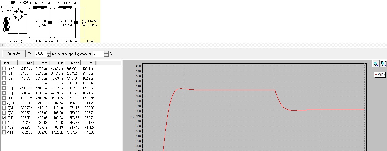

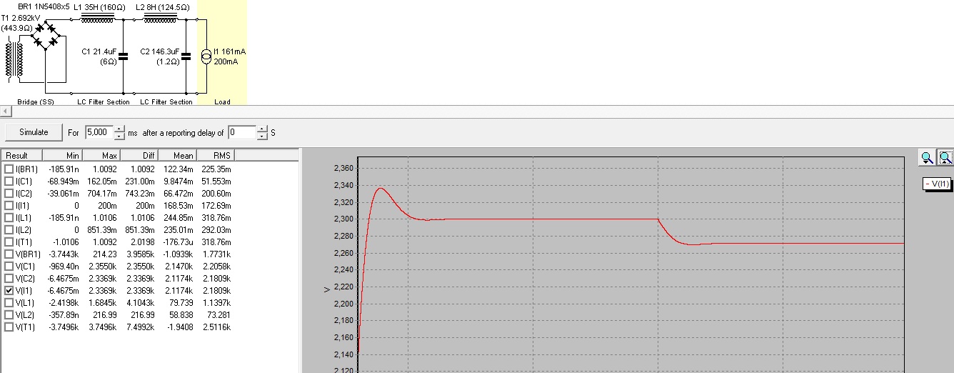

And here's the PSUD for the 833 B+...
a little underdamped, perhaps, but not too much. Should be nice and fast. 12mV ripple.
