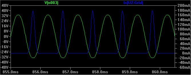

Here is an LTSpice simulation of the amp output and 833 grid current with a 4ohm resistive load at full power (195Wrms). Input is a 1kHz sine wave at 2.5V.
About 180mA of grid current is required from the driver circuit.

Note: Up to 40Wrms, no grid current is drawn, meaning the Midlife Crisis is in pure Class A1 for the first 40W (most real-world listening situations where I'm not cranking AC/DC).

Here is an LTSpice simulation.....About 180mA of grid current is required from the driver circuit.
That's probably about right. I measured about 250 mA and I only had 1500 volts of B+ placing my grid just into the positive region at idle.

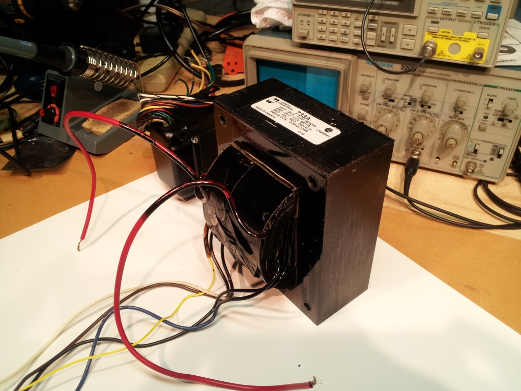

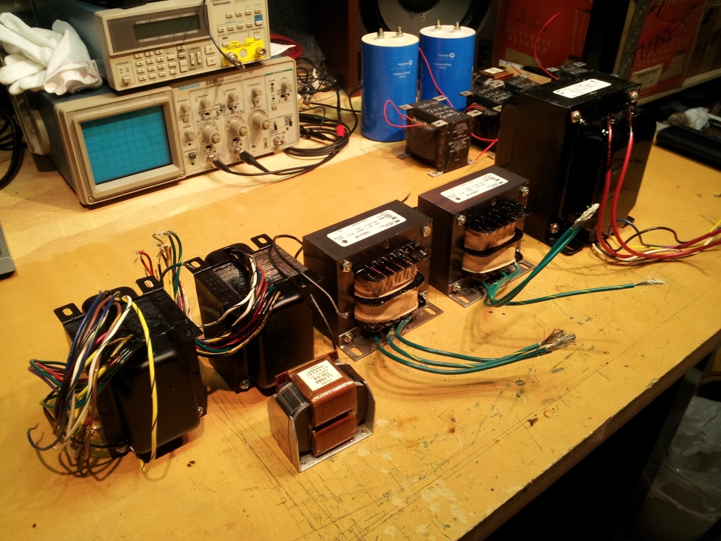

Received more parts today...most of the power transformers (picture 1), with a Lundahl 1685 13H choke in the picture for comparison.
From left: two Hammond 369KX for the 6E5P/driver circuits, two 18V, 20A Hammond 165V18 for the 833C filaments, and one Hammond 733A for the 833C B+.
The 733A is massive, as befits a 2500V, 345mA (CCS), 50/60Hz trannie. The 2500V lines come out the TOP of the transformer through separate openings, most likely for isolation from the other lines, so it looks like I'll end up laying it on its face with all the wires inside the chassis for safety - the end bells come off very easily (see picture 2), so that should be no problem.
The 369KX is rated at 450V, 300mA. Since all the supplies will be choke input I need to use higher voltage transformers. I chose ones with AT LEAST double the current ratings I need to operate.
Still waiting on the other 733A and two 159ZL chokes for the filament PS.
I also have two little Hammond BD2E transformers coming for the cooling fan PS, if I decide to go that route. My goal is to get all this into an 18"x22" chassis...it will be tight, I think.

I love the 2.5kv transformer... I did not know you could get End Bells that big. If you dont mind how much did Hammond charge you for it ? I may just order a couple if I return to my own 833 Beast later.
