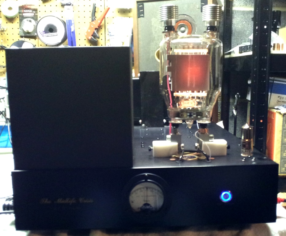

An update. 833 filament supply and input/driver stages on monoblock #2 are complete. Voltages all check out. Sine and square waves up to the 833 grid connection look excellent.
Now for the heavy parts...
The left monoblock is done and running! See picture.
Sine and square waves and noise level look the same as the right channel.
My son is visiting from college for the weekend, and he will help me carry these up to the family room (he doesn't know that yet...).
Stay tuned for some listening impressions on my main system, and yes, eventually a Youtube video...

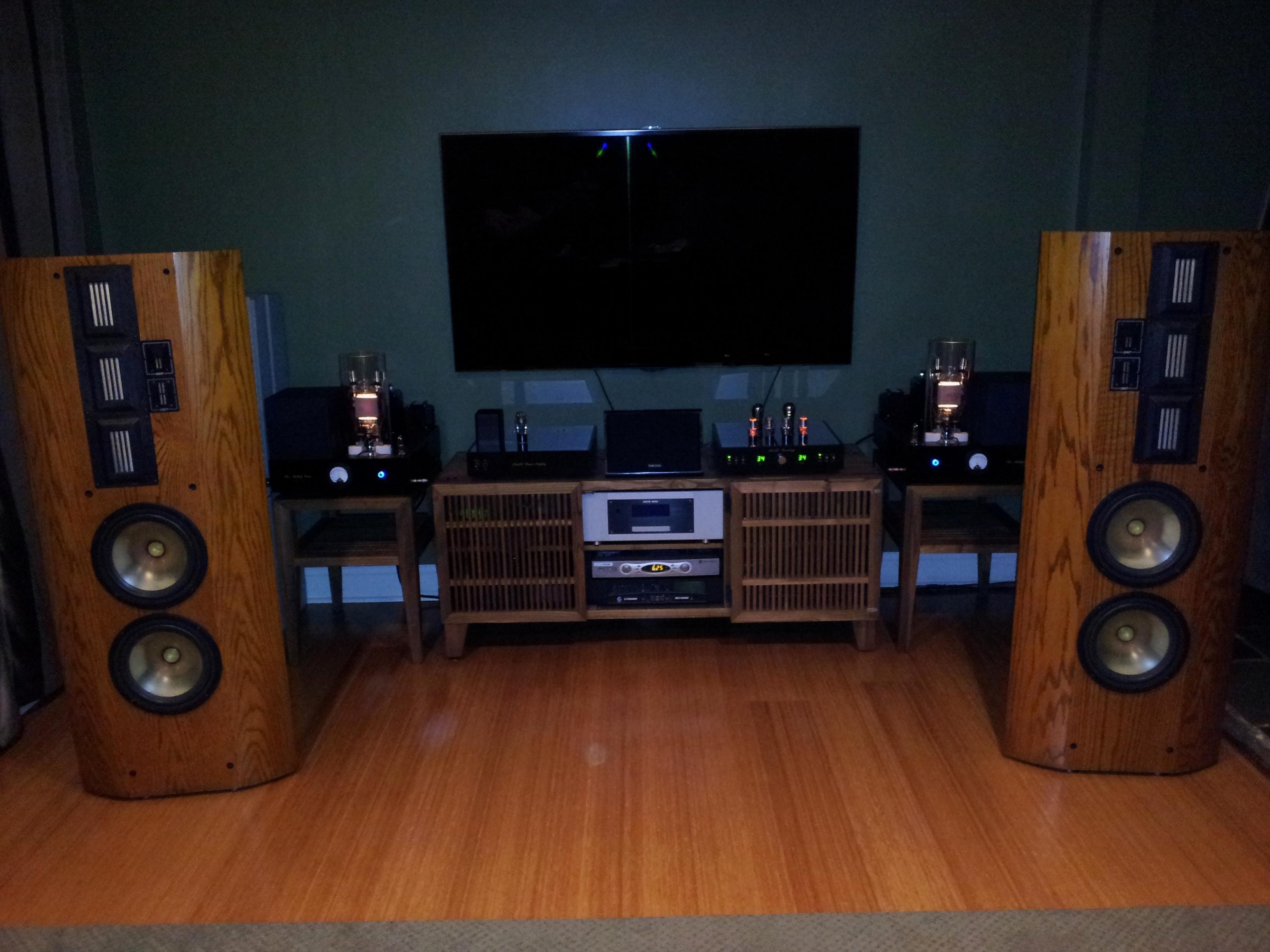

Well, they're in my listening room, making music! See picture.
The speakers are Infinity RSIIb, circa 1985, completely rebuilt. Old big Infinities have a reputation for being hard to drive; no one in their right mind would attempt to drive them with an SET...especially one with no global or local feedback loops.
Well, actually, this combination sounds GREAT!
I'm trying to be objective after spending about a year on this project and manage my expectation bias, but honestly, I've never heard anything as good as this combination, ever. The highs are crystal clear, the midrange is full and round, and the BASS is the biggest shock - these amps kick the crap out of my 500WPC Class D monoblocks in the bass!
Deep, sledgehammer bass, with definition.
Honestly, these amps sound better than I imagined they would at my most hopeful moments. Worth every minute I spent on them, and every dollar, too.
P.S.: And yes, the reflective front wall is actually by intention - I've found these dipolars sound better with the live end of the room behind them. Because from the Beatles Love album is to die for!
