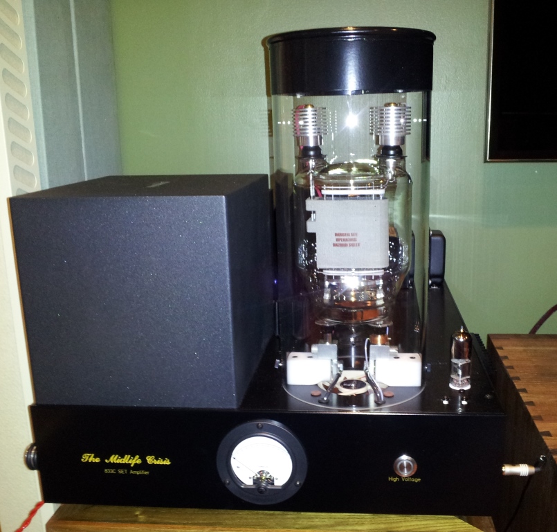

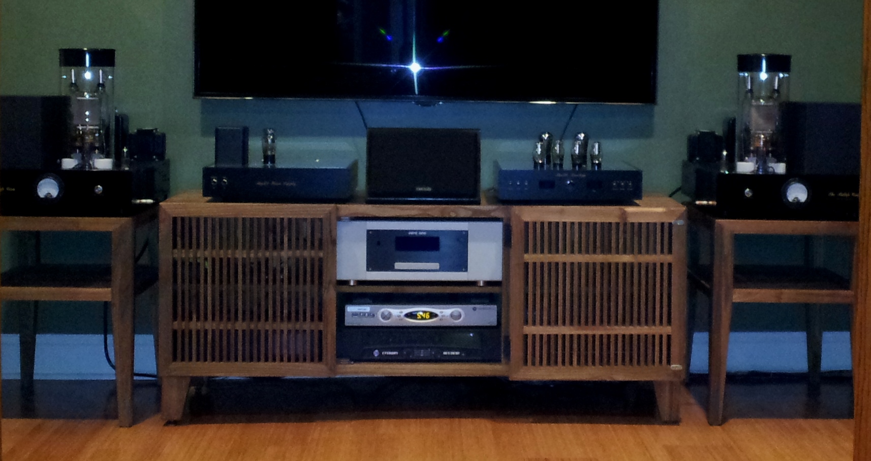

Anode current is rock steady. I was listening for 3 hours last night and after warmup the needles were very steady at 160mA. Temps stabilize at ~57C on the side heat sink (for the shunt reg pass MOSFET and driver MOSFET). I started out at 140mA on the first day to be safe, then went up to 150mA for the second day and am now at 160mA, where it will stay.
Sound is excellent. I'm hearing details and 3-D staging that simply wasn't there before. There is a lot of delicacy to this tube that you wouldn't think by looking at it. The bass is very powerful and deep - I watched There will be Blood Saturday night with the amps as part of my HT system, and when the oil rig exploded it felt like an earthquake under my house.
Fan noise is still a little noticeable between songs, so I will play around with damping the inside of the box to eliminate resonances and reflections, and dialing down the voltage a bit from its present full 12V. I seem to have plenty of airflow for cooling, so I can probably spare some.

The amps use Noctua NF-R8 fans. The fans themselves are very quiet and pretty much inaudible, until the glass cylinder and bottom plate go on, then there are some resonances that are audible. I didn't hear them in my workshop because the background noise level down there is quite a bit higher, and I never listened to BOTH amps at the same time (twice the SPL). I slapped an adhesive Soundcoat Sheet on the bottom panel of each amp and that helped, so next I'll try lining the inside under the fan with some thick felt (next time I have an able-bodied helper available to lift them). I have a screened cap for the cylinder arriving today; I don't think that will do much for the sound but it will keep curious fingers away from the 2300V B+. The noise is not terrible and it's completely inaudible when music is playing, but if I can get it quieter so much the better.

So, I received the covers for the 833 "chimneys" and they fit perfectly - see pics.
Actually, they are simply 6" diameter house eave vent covers that I had powder coated black, and they fit the 150mm glass cylinder like they were made for it!
Best news...the covers reduce the fan noise a LOT! The 1/4" mesh screen must breakup the airflow enough to greatly reduce the relatively high frequency "wind tunnel" noise I was hearing. The amps are now almost silent at the listening position.
I'll probably still glue some felt on the bottom cover opposite the fan the next time I go in there, but it's not urgent now.

Yes, there are two 3" diameter low restriction fan filters on the bottom plate, all the way at the back. I can reach them from the back of the unit, pop them out, and clean/replace the filters as needed with out having to lift the amps.
I'm happy with them, for sure.
...and clean/replace the filters as needed with out having to lift the amps.
at 180 pounds each, that's a nice feature to have.
