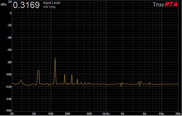

Thought you might be interested in the noise floor measurement for the Midlife Crisis.
Not bad for a one chassis amp with a 10A filament supply, a 450V driver supply, a 2300V 833 supply and a fan all in one box. I'm pleased!
As a sanity check, it is also dead quiet on 89dB speakers.
300 uV on the output is very nice indeed. I generally aim for below 1 mV - preferably well below - for my 87~90 dB efficient speakers.
As you point out, 60, 120, 180 ... Hz (mains harmonics) are the main contributors to the "noise". Unless you shield with mu metal, shielding is not likely to help you. The skin depth at 60 Hz in copper is on the order of 5 mm, so good luck with your shielding... 🙂
What you could do is to measure the ripple+noise on the B+ supply and the amp output with a voltmeter. I bet you'll find that the ratio between these voltages is rather close to the turns ratio of your OPT. This would imply that the residual ripple you have on the output is ripple from the B+ supply through the OPT. The only ways to get rid of that would be better B+ filtering or B+ regulation (good luck).
On the other hand, if the ripple leaks through a bias supply, a cap in the right place may be all that's needed to lower the hum.
But, honestly... It doesn't look like you have a problem, so don't fix it.

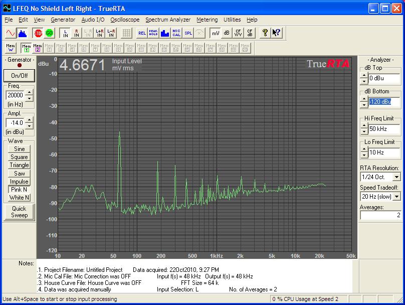

I use TI-Shield when I do shielding. It's a composite with a core of soft iron for magnetic fields, coated on both sides with copper for electrostatic fields. It is effective, for sure, I've used it to filter out mains frequencies in other projects, getting about a 10dB attenuation at 60Hz, and significant attenuation at higher frequencies as well, for a single sheet grounded to the chassis. Best part is, you can bend it and solder it without affecting its shielding properties, unlike mu-metal.
Below are before and after measurements on an equalizer I modified by shielding the power supply.

I don't think so, as I said, I can see the same peaks at 120, 180, 240, etc. with the 833 B+ completely off, only the filament supply and driver supply on. When it's all turned on there are additional peaks added, but the mains ripple peaks stay pretty much the same.
OK, so just to satisfy my curiosity, I did a few experiments.
1) Measured the noise with only the filament and driver circuits on, 833 B+ off (picture 1).
2) Repeated #1 with plate cap disconnected - no change.
3) Placed piece of TI-Shield between filament transformer and outputs, no improvement.
4) Placed piece of TI-Shield between filament chokes and outputs, no improvement.
5) Placed piece of TI-Shield between filament and driver circuits, no improvement.
6) Placed piece of TI-Shield between filament and 833 B+ circuit, no improvement.
Screwed bottom back on amp, turned it upright, and resolved that it was Good Enough!
I think I've just reached the limit of quietness for such an assemblage of parts, and that's plenty good enough. Time to move on to amp #2.

Hi Bob, Looks like good results.
As noted, the most likely source for the remaining spectrum is direct-coupling of magnetic field from the Filament supply transformer/choke to signal-parts or wiring.
Now that you have resolved to build the second channel, there's one test that could confirm the source:
- build the second filament raw dc supply, as before.
- Stand this new supply 1 metre or more from the amp, and connect to the filament regulators, in place of the raw supply built into the chassis.
- Take the spectrum again, and compare.
BTW, for the Eimac 75TLs Gianluca mentioned: the filaments for these can be fed from one of my 6.25A Filament regulators, with temperature-compensation.
Thanks, Rod.
The magnetic field emanating from the filament transformer and chokes is very powerful, with 10A of current going through them they're basically electromagnets! When I moved the TI-Shield near the chokes the field pulled the shield right up against the choke, like a speaker magnet would. Frankly I'm surprised the circuit effect is as small as it is, given that fact. I'm not worried about microvolts of noise for this application, it's plenty quiet as is.
