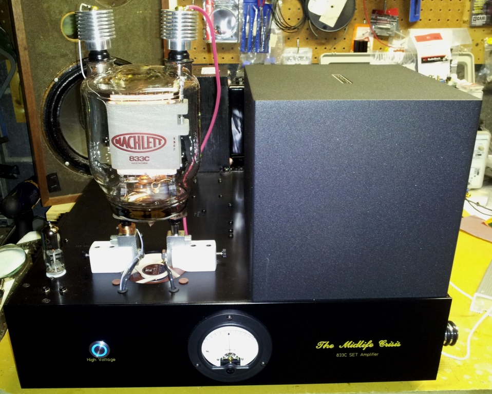

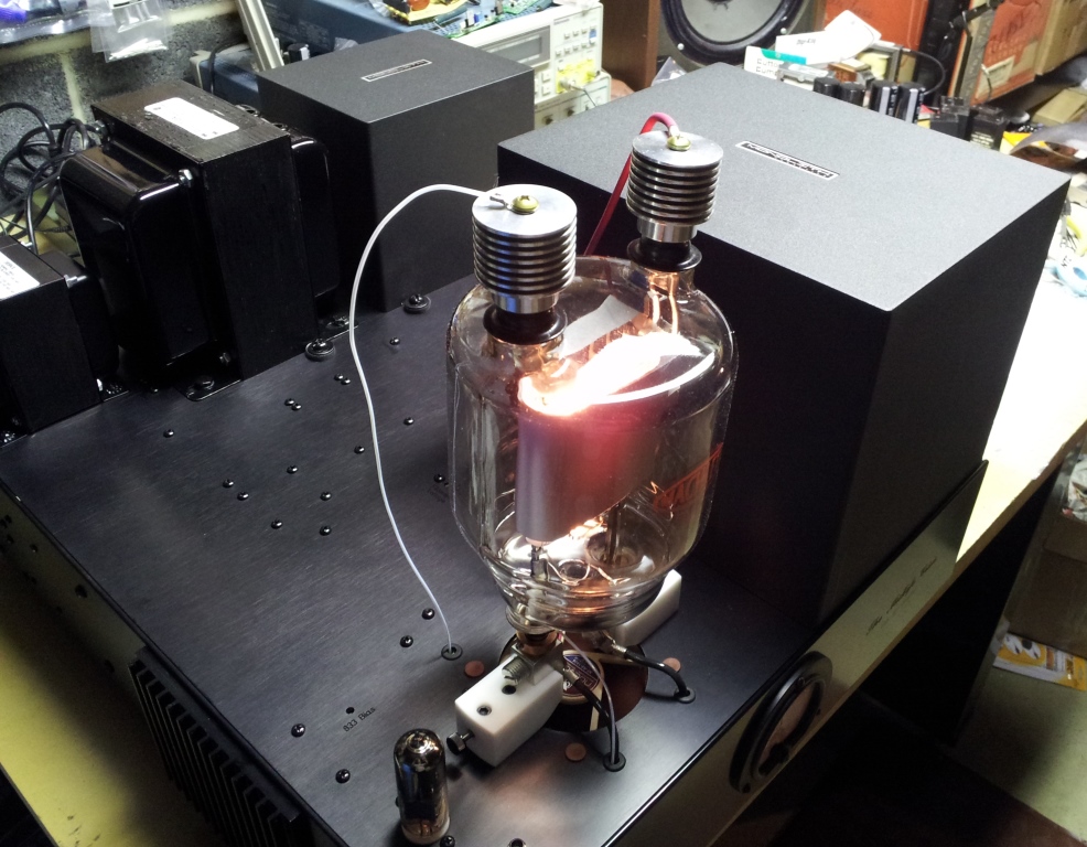

I'm starting the build on the second monoblock so I'll probably not be updating the thread for a while until I get that one complete. Then I'll be back with some impressions of the pair on my main speakers. TTYL.
P.S.: I attached a couple more pictures, a little clearer than the last.

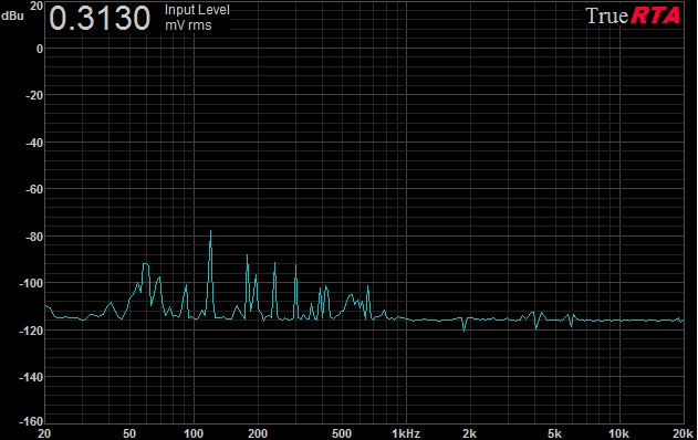

Thought you might be interested in the noise floor measurement for the Midlife Crisis. I measured with input shorted and a 4 ohm dummy load on the output, using my laptop with TrueRTA and a Behringer UCA-202 USB interface.
The picture below shows the noise floor while running at 150mA Ia, baseline subtracted. For some reason, TrueRTA doesn't subtract the mV readings when it does a spectrum subtraction, but the baseline (amp off) gave a level of 0.12mV, so if I subtract that from the 0.31 I get a total noise of ~.19mV. My DMM reads 0.2mV when placed on the amp outputs, so I'm pretty confident in that number.
Not bad for a one chassis amp with a 10A filament supply, a 450V driver supply, a 2300V 833 supply and a fan all in one box. I'm pleased!
As a sanity check, it is also dead quiet on 89dB speakers.
I haven't yet implemented any shielding around the filament supply transformer or chokes (especially the first choke), which would most likely decrease the above noise even further, as the biggest peaks are at 120Hz, 180 Hz, 240 Hz, etc. Interestingly, that same series of peaks is present at approximately the same levels when I only turn on the filament and driver circuits, with the 833 B+ OFF, so I know that's where they are coming from! Since no current is flowing through the OPT in that situation (no 833 B+), I'm thinking that the noise must be picked up by the wiring from the OPT to the output jack, or maybe directly by the measurement system through the chassis. The only shielding in place is around the fan.
My concern is that shielding will compromise the cooling air flow inside the chassis, in return for benefits that are most likely inaudible. That first filament supply choke is being pushed to its limits, and the last thing I want to do is cause it to overheat by shielding insignificant noise. My inner tweaker, however, always wants to push things as far as they will go...
Thoughts?
