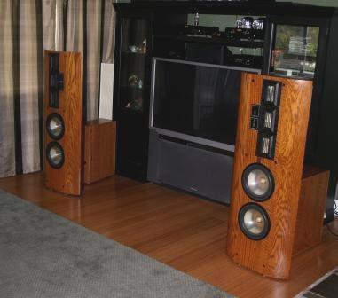

My main speakers are Infinity RSIIb's...see picture below. I completely rebuilt them a couple years ago; the crossovers are now in those oak veneered boxes behind the speakers. Currently they are powered by class D 500WPC monoblocks, it should make for an interesting comparison...
