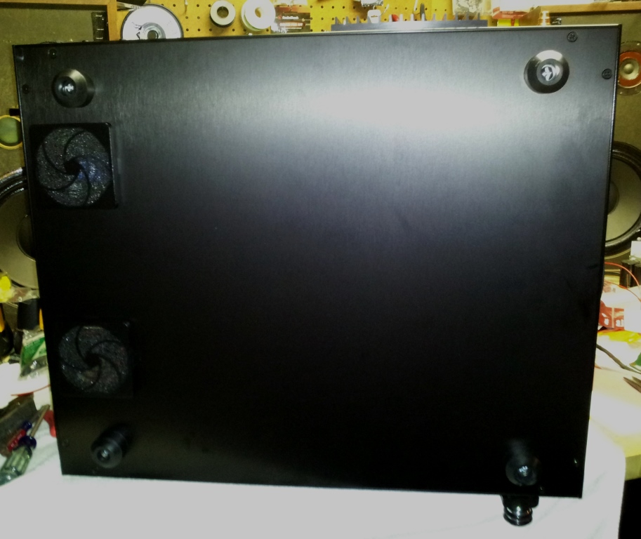

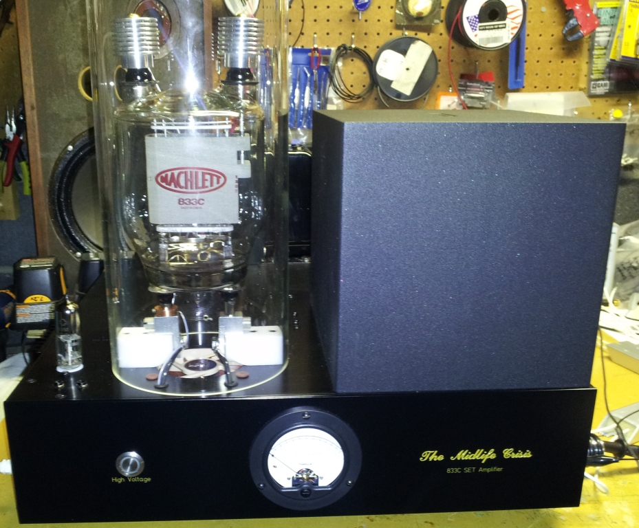

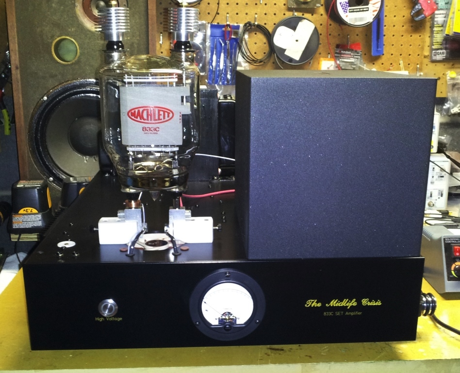

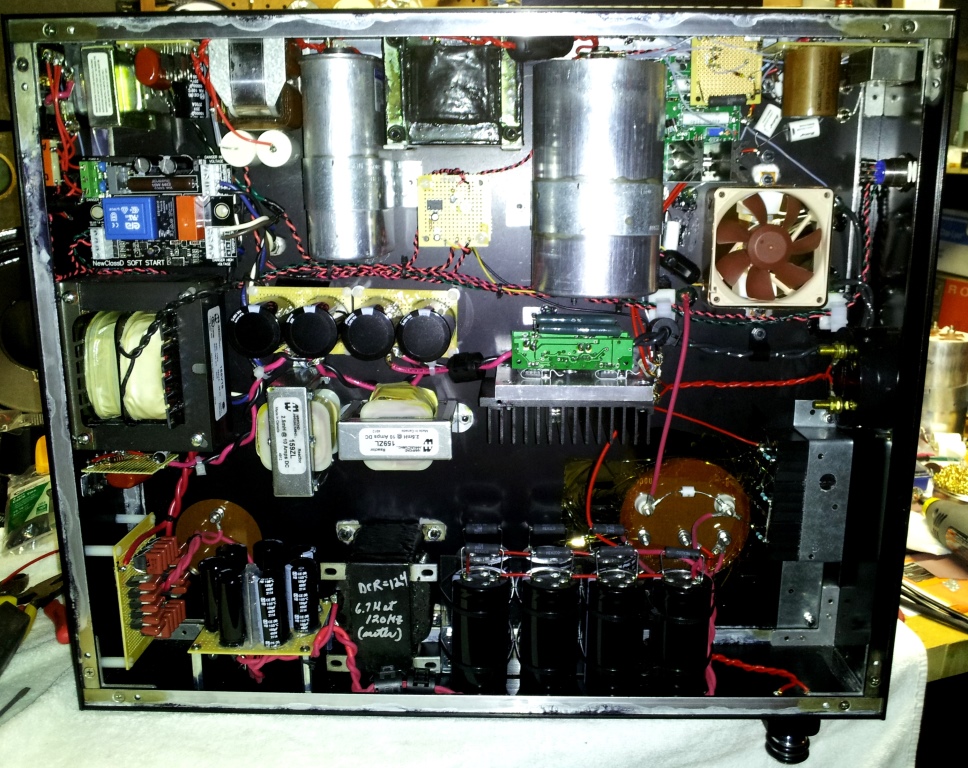

OK, it's Christmas Eve and I'm 99.99% done.
Picture 1 is the final (hopefully!) inside construction.
Picture 2 is the bottom view after I closed it up. The two square items are 3" diameter inlets with low-restriction air filters.
Picture 3 is the amp upright, with 833 mounted. All that's left is to attach the plate and grid wires, slip the Pyrex cylinder on and fire it up!

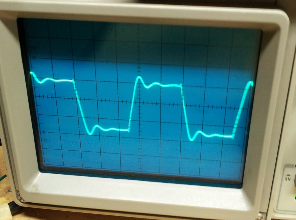

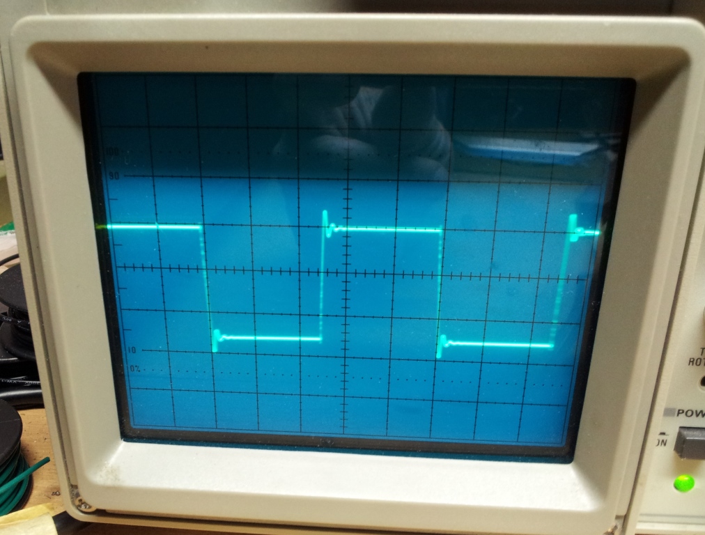

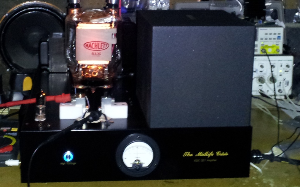

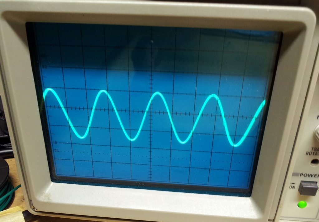

The amp works. Picture 1 is the amp with the 833 at 140mA, glowing away hot, hot, hot...
Picture 2 is a 2kHz sine wave at .05V input.
Picture 3 is a 2kHz square wave, nice and square but with a little bit of overshoot and wiggle on the front.
Picture 4 is a 10kHz square wave.
Picture 5 is the amp with the pyrex glass cylinder installed; I need to make something to cover the top of the cylinder, eventually.

SUCCESS!
