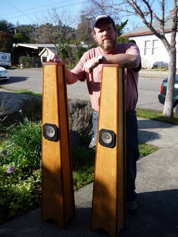

I have built 2 pair, one with the FE167e and the other with FE108E∑. Both pair sound fantastic and I enjoy them every day! Im recovering from back surgery so as soon as i'm able to handle large sheets of material I will begin making and offering them on the website.

Hi Kevin
Those Mets sure have come a long way since my first efforts,
three years ago, down in my dusty old basement.
Good luck with the venture.

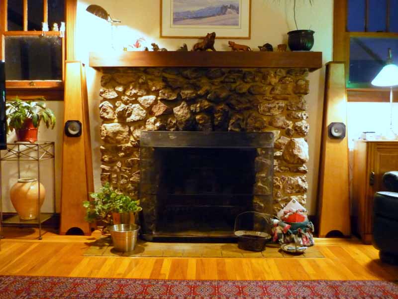

Those are lovely. Took me a while to figure out why the FE127 looked so weird -- you have the available metal grill on them?

How do they sound?
Great!
Only 5 hours on the drivers so far, so things will change.
They are built per the plan, but with a dowel behind the driver rather than a curly brace. 3/4" acoustic foam on 2/3 of the back wall, and the top 1/3 stuffed with fiberfill.
Not a huge amount of bass, its more indicated, rather than present. A little crunchy in the upper mid-range, especially piano transients.
They are being run off of a new Topping TP-21 T-amp and the heaphone out from an iPhone. No zobel, or baffle compensation, and no tone controls on the amp (or being used on the iPhone). Just two wires connected to the drivers.
Very clear and mostly balanced. I'm a happy camper!
