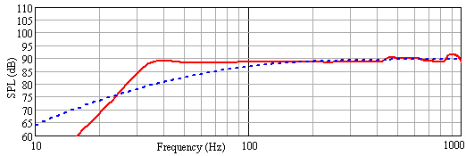

Hello,
I have a pair of Vifa P17 8ohm drivers that have been collecting dust for a couple of years now. I was wondering if anybody has tried this driver with the measurements on the tables here:
The Metronome
Additionally, if not, can somebody give me an idea of what to expect for bottom end and sensitivity using these drivers built to the specs on the table?
I have been looking for an interesting design for these drivers for some time now and these are definitely interesting. Just not too sure if they would be of good use for these drivers....I understand they are very good. I was going to use a simple series crossover with some decent tweeters like Dayton's 1 1/8" tweeters.
This Met would hav ebeen a special request by someone... i can check my archived email and see if i got any reports back...
Attached is the sim... sensitivity will be whatever the sensitivity of a P17 is (less any BSC). F10 in the neighborhood of 35 Hz.
