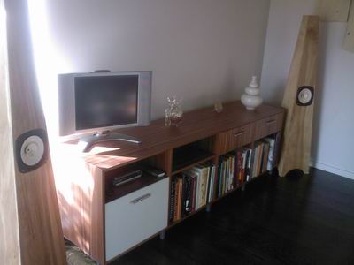

hi everyone,
I just finished building a pair of 126e mets. So far they sound really good high/mids's wise as far as my untrained ear can tell, but they seem to lack mid/low bass naturally. it seems i have to equalize it heavily to get it out; but at least its there when i do so.
Is it because of the weak T-amp that Im running it off of?
Ill get pics up as soon as i get them off my phone. =)
Congrats on the build -- have you changed the input caps on the T-Amp? Stock, they're a bit too small, they do eat bass. Could be it.
Another angle on the same thing: Tripath amps usually have very *good* bass if they aren't constrained - it may be a low wattage amp, but it should translate only into distortion, and then only at the limit - not weaker bass.
You might well just get away with some series resistance
