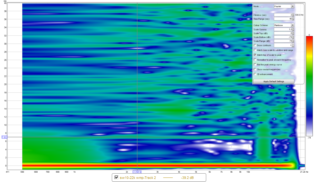

I don't get much out of wavelet view. Spectrogram plot with short window (2ms) shows coherent reflections as continuous horizontal lines. Path length difference to microphone is seen on time axis. Based on known microphone and speaker location and timing of reflections is relatively easy to figure out where reflections are coming from.
With tall array, floor and ceiling reflections most likely smeared into near oblivion. Conversely, horizontal reflections from walls will remain highly coherent.
I guess that your listening position is close to back wall, likely less than 4ft. Such reflections can wreak havoc with imaging depth and width.
Here are spectrogram examples with my Linkwitz Pluto based speaker. Speaker was >5ft from walls, tweeter is 43 inches from floor and 53 inches from ceiling. Microphone is also 43 inches from floor. Floor is wall to wall wool carpet on thin foam padding. Ceiling is thin acoustic tiles attached to sheet-rock. Ceiling has several beams that hang 9 inches below tiles that act as wall/ceiling bondaries at shorter wavelengths. Walls are wood, brick, and lots of big glass windows. Microphone at 9 inches:
Cursor location is about 7ms, the horizontal line is reflection from ceiling/beam combination. Amplitude is -39dB to direct sound. Diffuse blob in lower left of plot is artifact of 2ms windowing. At 9 inches direct/reflected ratio is very high. Listening in stereo with speakers <2ft apart, and sitting quite close, the imaging is pinpoint. Front of phantom image starts just about a foot behind speaker and extends about 8-10 feet back. Image height is short.

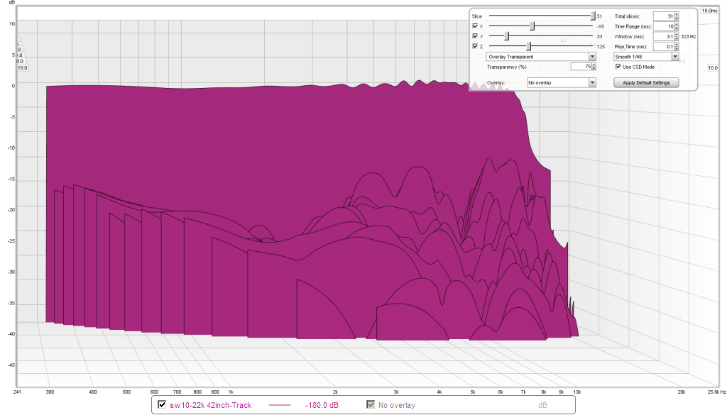

Microphone at 42 inches:
Note the scales of these plots; for 9 inch measurement scale is 0dB to -74dB, and for 42 inch measurement it is 0dB to -42dB. The direct/reflected ratio at 42 inches is much lower than for 9 inch measurement. For 42 inch measurement cursor is at about 5ms, this is ceiling reflection with less ceiling beam influence. This reflection is -12dB to direct sound. Horizontal line at 4ms is floor bounce. Combination of off axis response and carpet attenuate much of floor reflection. Reflection at 12ms is combination of side wall reflections. Listening with speakers placed 4ft-5ft apart at about same distance back the image starts about 4ft behind speakers and extends 20-40 ft deep. Image height is natural sounding; symphonic recordings sound fantastic. From this listening setup if speakers are turned around to point at front wall, placing me behind speakers, image starts at about front wall (12ft from LP) and extends to way outside the house.

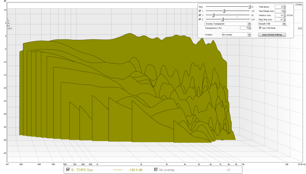

Speaker directivity and placement have impact that can not be underestimated. I built radial array for true omni-directional behavior in horizontal plane specifically to explore this. With radial arrays spaced 5-6ft apart and away from walls imaging has fixed behavior dependent on listening distance. From directly between speakers sound is like giant headphones with lots of sound inside head. As position moves back an image forms directly in front of face. As distance increases, image moves proportionately behind speakers, with proportionally increasing image depth. Image properties become stable beyond listening distance of about 7ft.

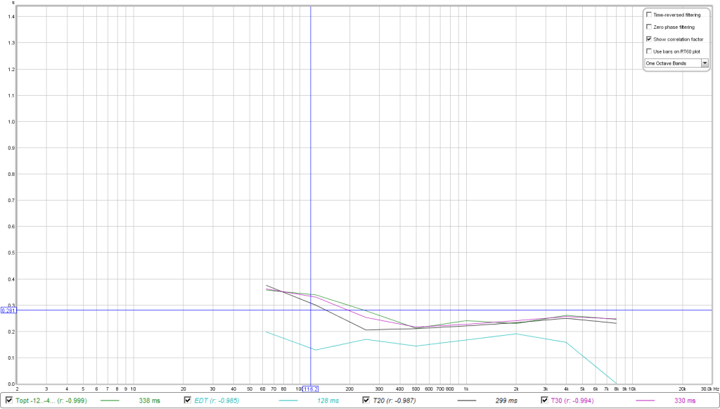

Attached are RT60 and water fall plots comparing 42 inch measurement of Pluto speaker to X's TC9 from early subjective round. These are good to think about in relationship to spectrograms and speaker/room interactions.

I do not have as clear horizontal lines in my spectrogram. I tried to put damping at the first reflection points where applicable.
Here you see the trouble I still have in the high frequencies. Some of it from comb filtering and some are resonances perhaps? Not sure yet. Maybe the baffle needs more damping between baffle and enclosure with butyl like I have between the aluminium.
My waterfall looks a bit cleaner than the one from X's first subjective round (different scale here in favour of mine) though I'm not pleased with the high frequency part yet (not showing it publicly just yet) see the yellow blob in the spectrogram at ~6 - 7 KHz above.

Here are my graphs, all with a 4 cycle window in REW in various stages:
You see viewing it like this ain't that bad. The smoothing is automatic in REW, I would have liked a little less smoothing to really see what's going on.
Next I apply my famous pré EQ:
Notice how soft handed the EQ is? All low q boosts and cuts to get a somewhat flat target. No big changes in the phase. I'd rather use no pré EQ at all but I'm doing this to get the response within a reasonable window for DRC.
After that my FIR recipe comes in:
Subject to change but I'm quite pleased with the result. But we're still looking at smoothed plots. The reality is going to be a bit more ragged.
Here's a plot of the first 20 ms, no cycle gating and smoothed 1/12:
This is the right side, no damping panels near so it is the most rough plot.
Still you see it's reasonable with a lot of phase wrap at higher frequencies. And I assume this is what you were getting at?
I've only seen measurements from one room that didn't have the wraps and I'll never be able to replicate that! But it had a single tweeter and not 25 sound sources. Maybe a horn speaker could stand more chance as it wouldn't illuminate the room like these arrays do.
Still I'm working to better the results, but DRC isn't going to help here. The window used in DRC is much to small to solve that. So it's back to looking at the room and the speakers for the best cure.
I don't know what kind of window is needed at high frequencies to represent what we hear. The first sound it probably going to dominate so I look at the output gated in cycles. But I still look at the first 20ms too to try and improve. The balance between direct sound and reflected sound is also interesting. So I compare
what I get with a 0 to 20 ms window and a 20 to 500 ms window. They are very much alike which I think is a good sign.

I use REW, as many do, the question is what should we look for when measuring 25 or even 50 drivers all playing at the same time?
If it's not the real phase (it isn't when it's smoothed) I'm measuring than isn't it pointless to base a FIR filter upon that? Yet it seems to work. Can you elaborate?
I get it that I'm not measuring a big full range driver here, they are always going to be 25 separate sources. I do treat it as one big source. But in reality it's going to have more peaks and valleys close together where the drivers can't combine due to combing. But I'm not hearing that combing. I do see an advancement in my measurements but are you saying I'm looking for the wrong things? I'd like to learn here so teach me 🙂.
The FIR filter seems to straighten out the measurement, even though it will still be peaks and valleys, just a little more organised. The way I view it is with the smoothing I'm averaging the separate results into something useful that somewhat relates to how we hear. Am I wrong? I wouldn't know how much smoothing is needed exactly to relate to what I hear. The phase wrap origins seem to be traceable to reflections, resonances and other time disturbances. I don't look at the wraps themselves as being real, but try to view where they start and push that further out in time by either treating the room or speaker. In combination with the group delay I try to figure out the cause. Am I doing it wrong?
One thing you could do is also look at the phase with another program, Holmimpulse or ARTA come to mind.
I have lots early reflections; 700-800 ms+ decay for -10dB according to REW RT60 plot. Don't even ask about T30 or Topt 😡
This is where I am getting harsh & confusing high frequencies & low speech intelligibility performance from my arrays, I guess.
The phase plot in REW depends on a lot of factors, thats why mine might be so messed up. I am planning on adding some damping to my room, until then maybe I should not look at the phase plot as I have neglected waterfall data too.
Even if I may have some actual problems with the phase (which I doubt), there is little I can do as I use IIR PEQ. The group delay plot on the other hand, is basically a flat line through out the whole frequency range with a few peaks & dips ( 10ms max) in low & mid range.

I was aiming for sub 500 ms times in RT60 and at least -20 dB in the first 20 ms.
