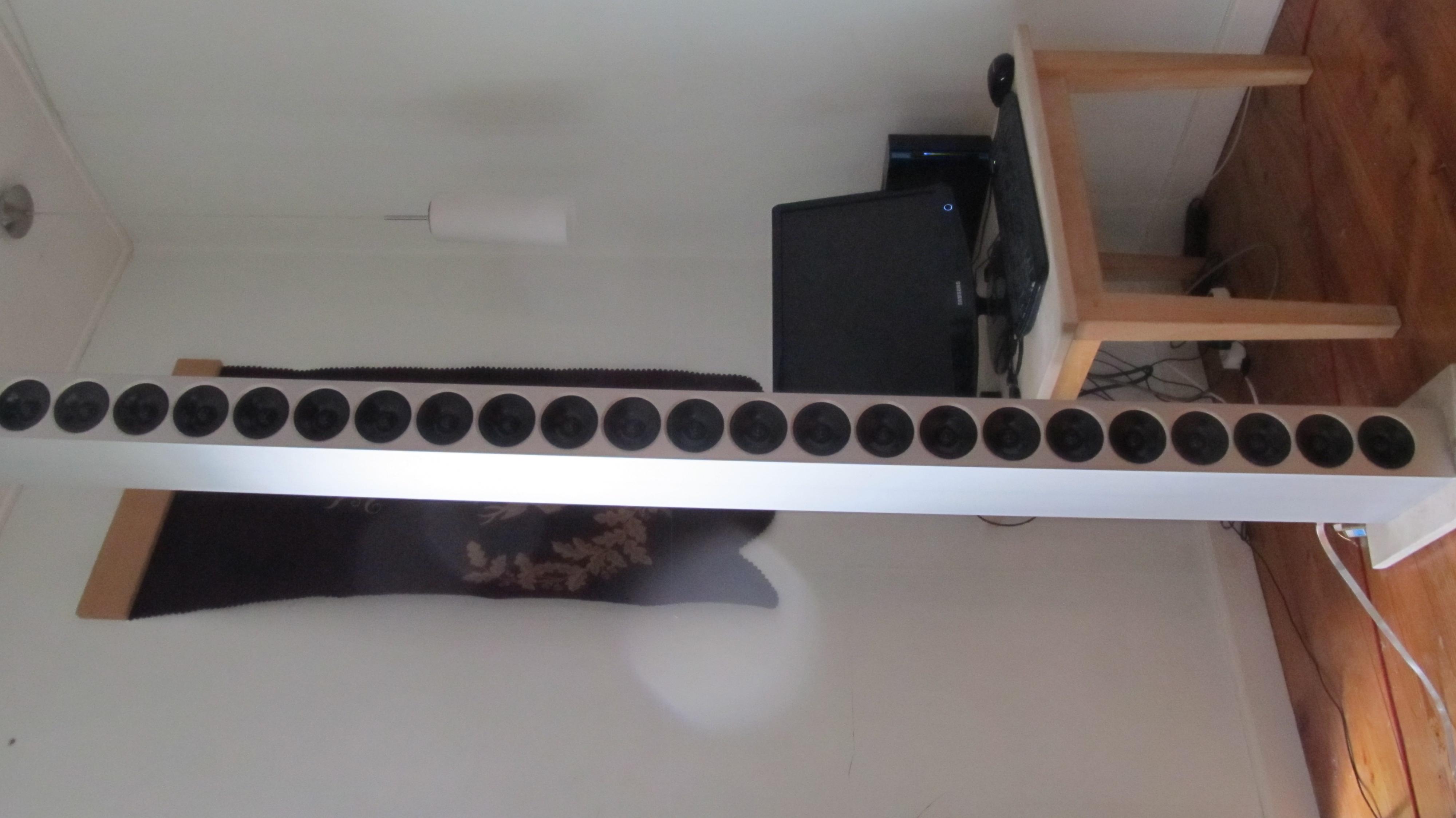

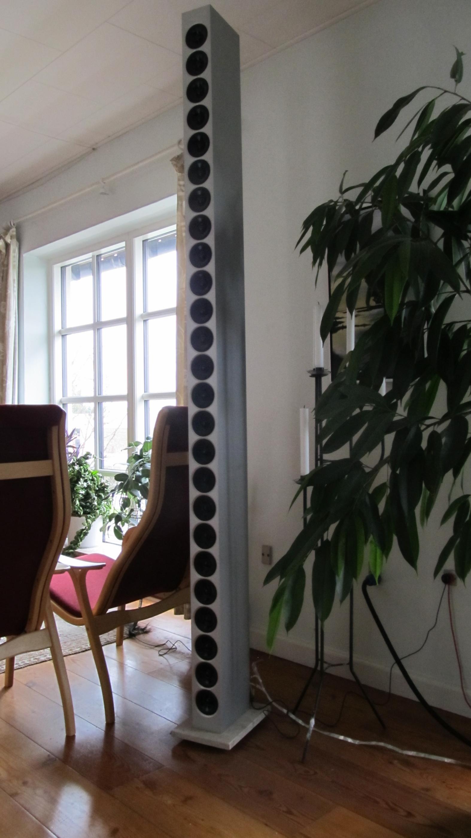

The making of: The Two Towers (a 25 driver Full Range line array)

Here's the curve I ended up with after my last session:
Left and right channels at listening position, 1/3rd octave smoothing (predictions)

Can't mention enough what a big part the room is playing in all this. On one side I need it (for my low end) and on the other side you want to get rid of it as a stamp on all your music. I only softened the effect of the room, by damping panels and the rest with DRC-FIR. I'm under strong advisement from my other half not to add any more damping. Got to work with what you've got... I'm slowly letting her get used to the idea that I'm adding more speakers and another amp. That didn't go all smooth: "Even more speakers? Isn't it good enough the way it is?" "But what if I can get it even better honey?"
Getting closer...
Now am I confident enough this is going to work and paint the enclosures before I test it? :spin:😀

Slippery enclosures, hard to photograph with my phone...
Painted with roller to get the orange peal in satin black. They're still a bit too glossy for me. But for now they'll do.
Edit: it's silk gloss, I guess I want Satin. I toned down the arrays gloss but that was a strong 2K boat paint. These were painted
with the cheapest paint I could find.
