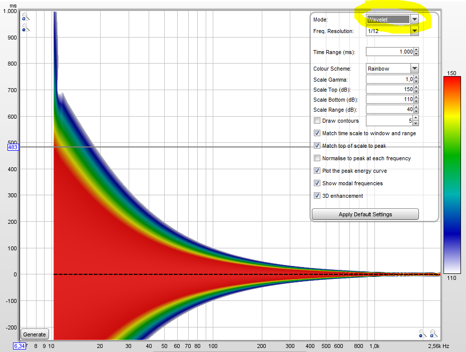

p.s., where do you get this "Wavelet" capability in REW? Is that the same as the spectrogram? Doesn't look the same.
.....p.s., where do you get this "Wavelet" capability in REW? Is that the same as the spectrogram? Doesn't look the same.
Seems "Spectrogram" shift mode Fourier to Wavelet.
Cool! I never knew REW did wavelets - this software keeps getting better and better - always there unbeknownst to me 🙂
