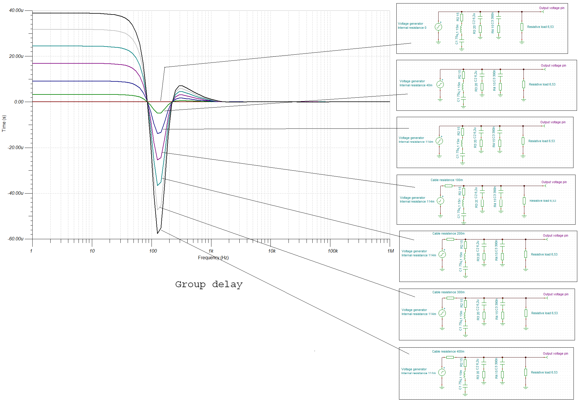

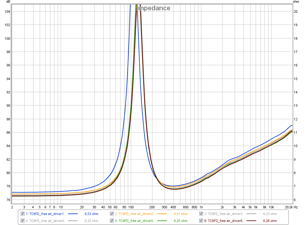

Here's a picture showing the Group Delay tab of the array, the corrected array and 3 different test box configurations with a single speaker. Smoothed 1/3 octave to show general trends...
Nice to see the impedance peak of the array is shifted to the left compared to a stuffed single driver in the test box.
Note: this is the Group Delay within an Impedance measurement...
That is a nice improvement on GD with network. Why does your array have a GD bump at impedance peak? Normally GD just rises above 100Hz for sealed alignments?
This is the group delay plot of an impedance measurement. So it's the delay caused by the internal amp of the laptop soundcard while taking that measurement.
Also note the scale on the Group Delay plot, top is 3 ms, bottom -2 ms.
If you look at the plot(s) BYRTT presented earlier in this thread he was plotting the results of an amplifier and the wiring used on the conjugate network.
It's the correcting network that is simulated here, so the result will be the inverse of the (red) graph above:
You see the same shapes, though inverted as presented above. I have no plot of my actual amplifier, it could behave entirely different from the laptop I used for these impedance measurements. It will most probably have less GD than the laptop soundcard more in line with the graph from BYRTT. But I don't want to risk frying the laptop soundcard input by leading the output trough the amplifier to the arrays. (Also take note of the scale on the graph BYRTT posted)
The delay is dependant on the resistance of the wiring and the amplifier's damping factor if I am not mistaken. An "ideal" amplifier would have no delay as plotted as a straight line in the graph from BYRTT.
With an accurate conjugate network in place every amplifier would plot like the "ideal" amplifier. The blue line in my plot shows it's pretty close but not perfect.
So I still don't know how big of a difference this all makes with my actual amplifier. It probably is a very small magnitude. Just trying to get some perspective on this whole concept by presenting what I noticed on these impedance graphs and maybe we can actually come up with a reason for perceiving an audible advantage
with a conjugate network in place.

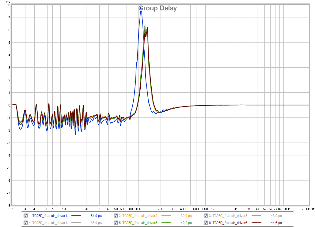

Haven't had the chance to do new measurements yet but I can say this: any difference that's there is going to be very small after processing. I managed to put 3 different configurations side by side in REW. Even though the processing settings aren't exactly the same it was obvious the differences were very small.
Not saying it wouldn't make any difference. But I do think the Vifa is behaving quite well with it's shorting rings on its own.
Even with a 10 Ohm series resistor and the conjugation network in line the output was nearly identical after SPL had been corrected. The series resistor might have an advantage in distortion. Still have to run some new tests. But I always fight with the distortion measurements and outside noise here. So it's hard to tell.
One thing I do wonder about is the rising impedance at higher frequencies. It seems counter intuitive to correct for the rising impedance if you want more output up high.
Especially when using series resistance. With the conjugation network in place I had no rise of high frequency level compared to just using the conjugation network.
If I don't correct the rising impedance and use series resistance I might see higher output at those frequencies.
There is a difference in the GD plot between the array without correction and with the conjugate network. The higher in frequency you get, the wider the spread is with the network in place.
The extra damping of the baffle had the opposite effect. Possibly it has to do with the less than optimal amplifying using a laptop for that test though. But it does make me wonder.
A series resistor damps that behaviour while a parallel resistor exaggerates it.
I guess pictures will show more clearly what I'm talking about;
Group delay tap of an impedance measurement of the standard array with Butyl damped baffle:
Same part with conjugate network:
A wider spread at high frequencies is obvious...
Conjugate with a parallel resistor:
Conjugate with a series resistor:
Before adding Butyl instead of mass loaded vinyl it looked more like the spread conjugate network. I did "feel" like the butyl helped clean up the higher frequencies.
So with that in mind, would no correction up top and 10 ohm series resistance give the most benefit? Hard to be sure because the 10 ohm series resistance is also going to limit the power to the array, which will be part of the result, but not all of it. There's no level change in adding the parallel resistor, yet the pattern gets a bit wider with it in use. Same goes for the conjugate network which also puts resistance in parallel with the driver without effecting SPL.
So the series resistance seems to act as a damping mechanism. Made obvious on the laptop measurement. Here's the single driver in the test enclosure with fibreglass insulation filling to compare:
So what would be the ideal situation to choose!

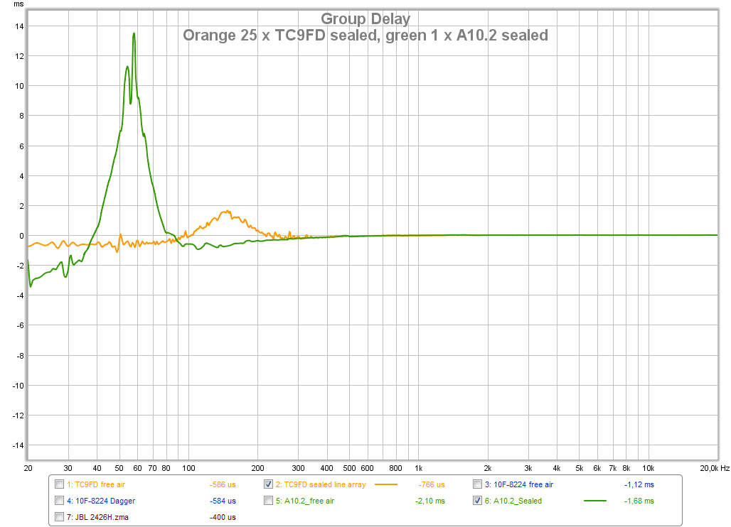

Mine network clearly changed percieved sound, amp PSU did run colder too and clearly visible was motion when cone oscillate was braked considerly. But clearly below plot green color show more resonance my setup compared to line arrays orange and therby more to come for, driver was A10.2 full range speaker without XO. Speaker cables was solid core 0,5mm and their lenght have series resistance around 0,5 ohm.

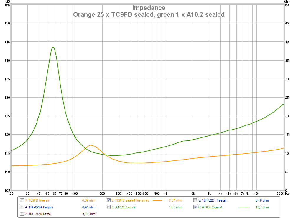

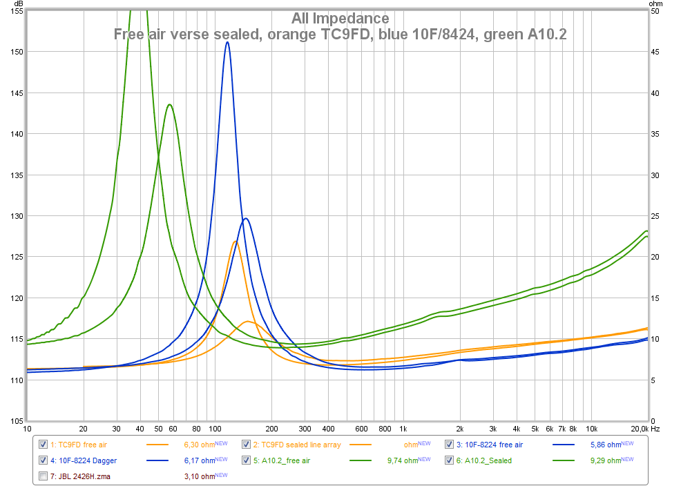

Seems TC9FD have fair flat resonance compared other drivers and then less to correct, here compared 10F/8424 and A10.2.
Orange = TC9FD in free air verse wesayso's right line array.
Blue = 10F/8424 in free air verse xrk971 sealed Dagger.
Green = A10.2 in free air verse sealed relative low Q box.

Good to see the GD plot of the A10.2 impulse compared to my array. Now I know it's not just my measurement setup showing results like that in the time domain.
If I want to see this as an exercise to "perfection" of the time domain response, correction up to ~500 HZ would take care of that.

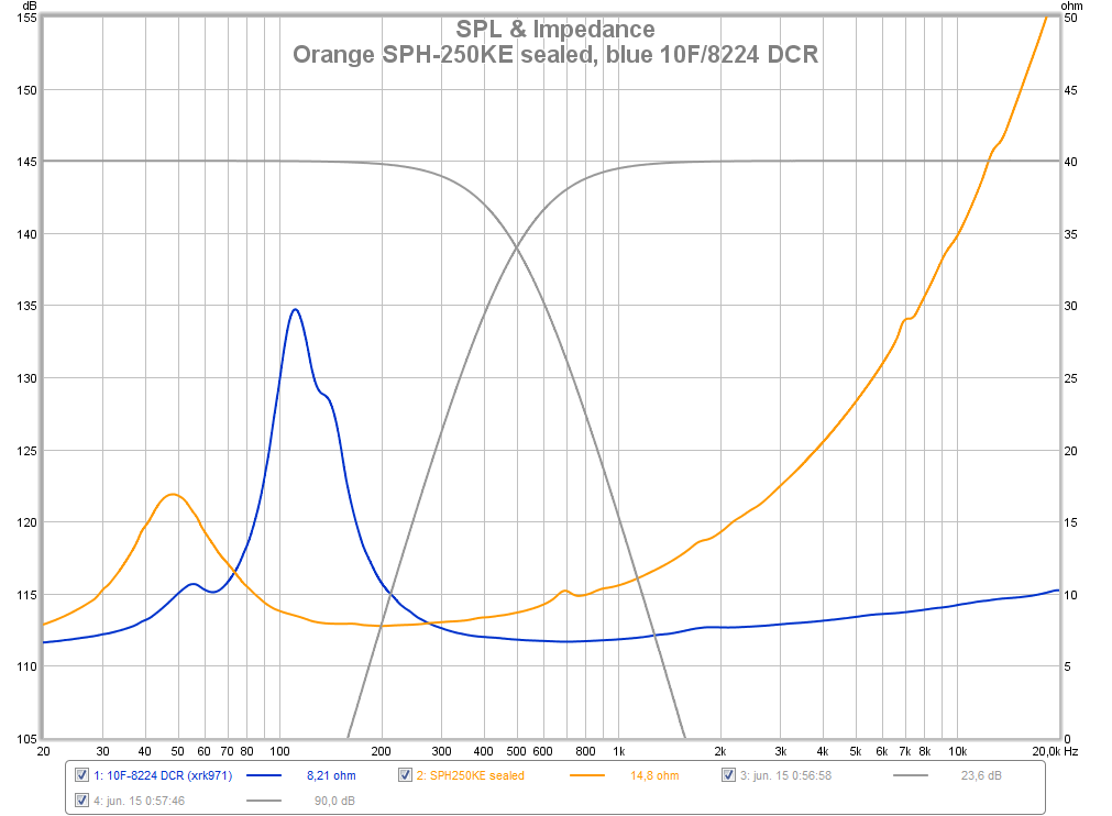

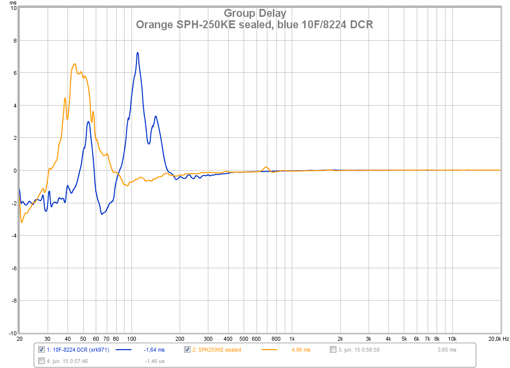

Welcome and thank you too sharing so we have a chance get wiser : )
If you add series resistance to amp wire before the network which should be mounted as close to drivers as possible then into modeling software it shows the network to be more worth it, so therefor in a way hope you find other improvements with series resistance.
I plan on add it to 10F too and will post findings, but because that speaker is setup as FAST and relative hard XO at 500Hz LR4 (FIR linear phase 🙂 inspired by Barleywater) don't expect it to be very audio able because 10F resonance is mostly cut by XO point, will more expect the RLC/RC network on the woofer will be audio able in that resonance is clearly inside woofers passband (E string on normal 4-string bass guitar sits inside resonance).
Attached is 10F and 250KE Z/GD plots added 500Hz LR4 slopes, don't laugh at 10F strange double resonance curve its because its mounted in a xrk971 DCR box original made and meant for TC9FD, boxes is just for exercises but think good enough to learn from and actual sound pretty good. Picture the setup is here http://www.diyaudio.com/forums/full...3in-5in-drivers-round-2-a-46.html#post4397112.
.....Did you use a laptop/PC for that impulse? Still wondering about different type of amps giving different results in the time domain when presented with reactive loads.
Sorry forgot answer that in the above post.
For posted measurements DATS v1 hardware with software package upgraded to v2 is used for A10.2 free air and sealed, free air 10F/8424 and TC9FD. Last two measurements are one is your own 25 x TC9FD array laptop/PC measurement and last one is 10F/8424 in Dagger made by xrk971 with his DATS v2 hardware which include v2 software package. Because this hardware is intended for use to this task and one can calibrate/compare/measure to a reference R/L/C i trust it and compare to reference values always confirm this, including it measures down to 1Hz.
Haven't tried REW to this task because i have that DATS device, think ARTA have a LIMP package to add this function and seen it is praised by many.
Below is 6 x TC9FD Z-files, first two a batch from Intertechnik and last four a later batch from Europe-Audio, those are measured by DATS device you could import them and compare to your own measured by laptop/PC 🙂. Actual i have 8 x TC9 because later i got two more from US sitting in DCR box created by foam core master himself, they measure in free air exact close to no 2-6, i just only have their in-box files saved and forgot to save their free air files.
