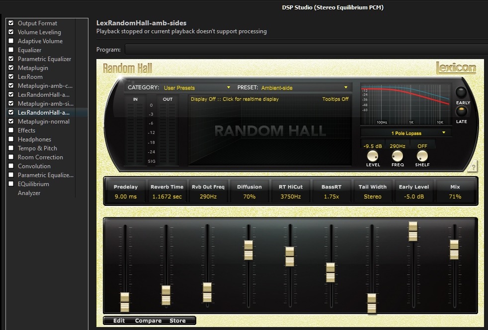

I think I can find a way to use the Lexicon plugins by using multiple Metaplugin instances to reroute the audio, so I can temporary swap places between ambience and left/right channels etc. All insterted plugins in metaplugin only work on the left/right channel, so I need to swap channels often.
I remember @BYRTT saying that if you copy and rename a plugin dll, you can run more instances.
(I do miss BYRTT as an active participant on this forum, and some others too)
Reactions: krivium
Lots of re-routing but so far it does seem to work...
Using 4x Metaplugin to get there (lol).
Reactions: fluid
For anyone following my Reverb exercises and thinking: didn't get get the Relab plugin to take care of that? True, but the one thing that I had less of a success with is that "shuffler" part. That's what worked very well with the Lexicon (LexRoom) plugin. The Room settings in Relab can't really compare for this use.
The backdrop: Let's just say that I have way more time and familiarity with the Lexicon plugins. Their Random Hall isn't similar to the Random Hall in the Relab plugin. But there's enough ways around that (using different settings) to make it comparable and maybe even more than that. I do plan to find out which one is my most preferred solution and it will be fun to see where I end up. I still love that Lexicon sound, both of them. 🙂

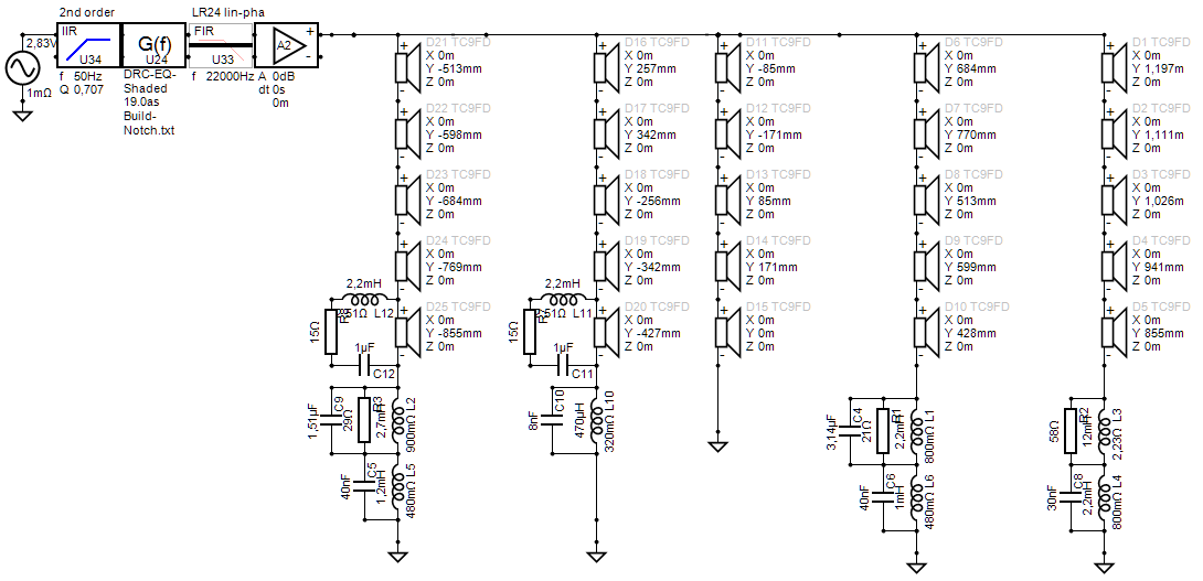

It still is 5x5 series-parallel, but with a few coils, resistors and capacitors here and there 😀.

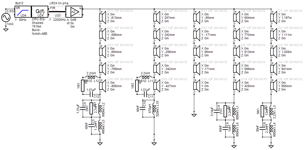

The drivers have since been changed to Scan Speak's 10F 8414G10. As these drivers are quite close relatives, it did not change much for the working of it all.
The only required change was on the top end, where some capacitor values were increased due to the difference in driver impedance:
The biggest change for me was an empty wallet 😀. (just kidding)
I've found that all off this isn't without it's own drawbacks. The multiple re-routes cause some stutter in JRiver when the next track gets loaded.
I have been in contact with Metaplugin to see if they can resolve the problem. Fingers crossed that it will work out...
In the mean time I'm trying to have one instance as a direct JRiver VST plugin and run the 2 other instances (ambience) of the Lexicon as convolved IR's.
Not completely satisfied with it, as it's still a little more sensitive to slight stutter, even though I increased the buffer size for the Xonos from 50 to 500!
(it still involves 2 instances of Metaplugin)
Following up on the above, I've made some changes. I now run 1x Metaplugin and 1x Plogue Bidule. Bidule is a similar routing program as Metaplugin, allowing you to load VST and VST3 and do routing of the audio streams. I did try to do it all in Bidule, but that got me a DSP overload.
Right now it works as the host for my Lexicon VST's and neatly keeps the settings right. So one half, with my EQ plugins is handled by Metaplugin and the other half, with the Lexicon plugins is handled by Plogue Bidule. Not exactly what I wanted and I still hope Metaplugin can fix the incompatibility with the Lexicon plugs. However, as the sound works out well with these two working together, I can at least go on with fine tuning. Finally.

An update about my plugins and their use in the 64 bit environment of JRiver. I've mentioned that I had troubles with the Lexicon PCM plugins, which were losing their settings after a program restart. I investigated the use of the Relab LX480 plugin, and even got myself a rent-to-own license on it.
After getting Plogue Bidule into the mix, as a possible host for the Lexicon plugins, they (the Lexicon plugins) haven't missed a beat. The trouble was in using Metaplugin as the host for the Lexicon plugins. Hosting the plugin directly within JRiver did teach me that.
As I could not host all of the plugins I use in Bidule without running into its limits, I still run some of them in Metaplugin and the Lexicon plugins inside Bidule. It took me a while to find a stable mix, but I think I've found it now. All sessions that I have ran recently have been satisfying, so satisfying that I've canceled my rent-to-own license for the LX480.
I still prefer the Lexicon PCM Native Reverb Plugins in a direct comparison for what I want to do.

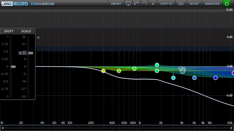

On another note: I'm still quite satisfied with the Equilibrium EQ. It remains perfectly transparent when used in linear phase. A worthy 64 bit EQ plugin in my book.

Maybe I should make clear that this band-passes anti-crosstalk signal is applied to the phantom center (summed) signal. There's always a bit of side information in there but it's pretty similar to applying the reverb on that phantom sum (in graphs) yet it does sound different.
No echo removal in place here.
I absorb side wall reflections. The crosstalk cancelation is aimed at the sound of the left speaker reaching the right ear and vice versa.
Loosely based on some pré work from Prof. Choueiri that he further developed into his Bacch solution.
I use 3 different "tools" together to soften up the effects of crosstalk in the absence of early reflections.
  • Mid/side EQ to fight the imbalance perceived when side reflections are low
  • crosstalk cancelation that basically does the same as the above, but reacts differently when moving out of the exact center, hence the combination
  • added virtual reflections on phantom center at very low levels (and with a 7ms delay), increases intelligibility and creates depth and a sense of reality (giving some back of what I stole from the room)
