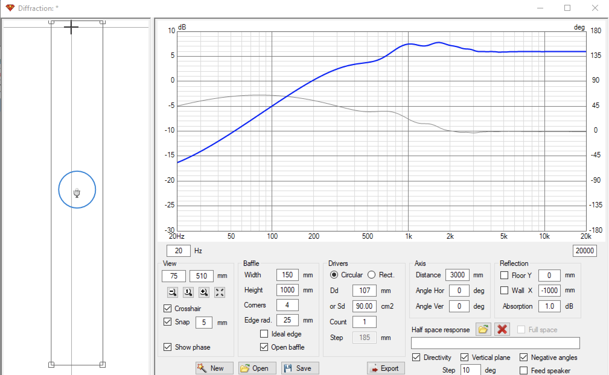

Then I'll explain more specifically what I'm describing. On a rectangular front baffle, like a standard MDF front baffle, the driver's physical location on the baffle changes the frequency response. I'm really just asking how or, now if this even applies to your build, given the way you've chosen to construct it with individual enclosures, mounted in a CLD style baffle you've described. In VCAD, I use this tool:
But I suspect based on what you've told me this doesn't apply to your design at all-- which is very cool, if that's true. That insight will probably influence my own designs going forward.

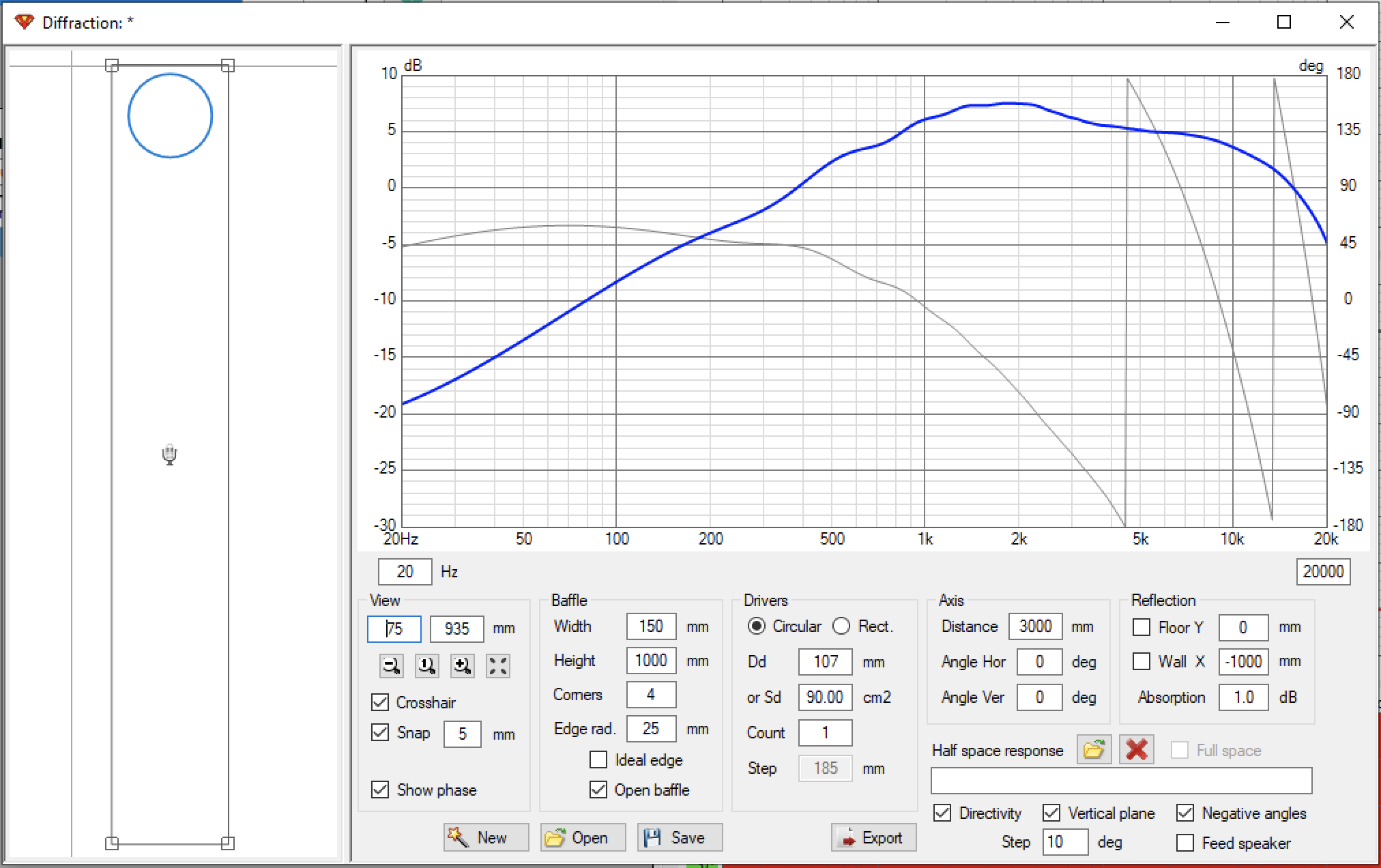

I see, these effects change with baffle size etc, but you could try and increase the edge radius and see if that smooths the horizontal output.
The upper driver which is closer to the edge suffers even more from these effects. However in a full line like mine, we don't expect to use the full range of the top and/or bottom driver anyway. In my case it's filtered with a low pass.
The results of my baffle diffraction are as follows:
With a rectangular shaped baffle, the horizontal variance would look like this:
With my rounded enclosure shape, plus the fillet I put in front of the driver, it looks like this:
In this case, the on-axis output has been EQ-ed flat, but what's the key factor to get out of this is that the enclosure shape does have a large influence on the horizontal pattern we can achieve.
The enclosure shape combined with the baffle design made it act much like a waveguide, it shapes the output up to about 4 KHz and its still a lot smoother going up higher in frequency. That 'should' result in a good balance between the direct sound and the indirect sound coming back from the room. The resultant DI of the total speaker reflects that by looking like a smooth, line gradually increasing with frequency.

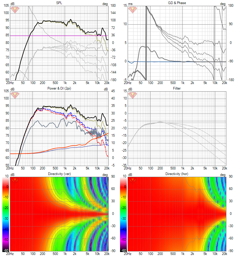

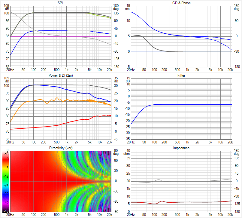

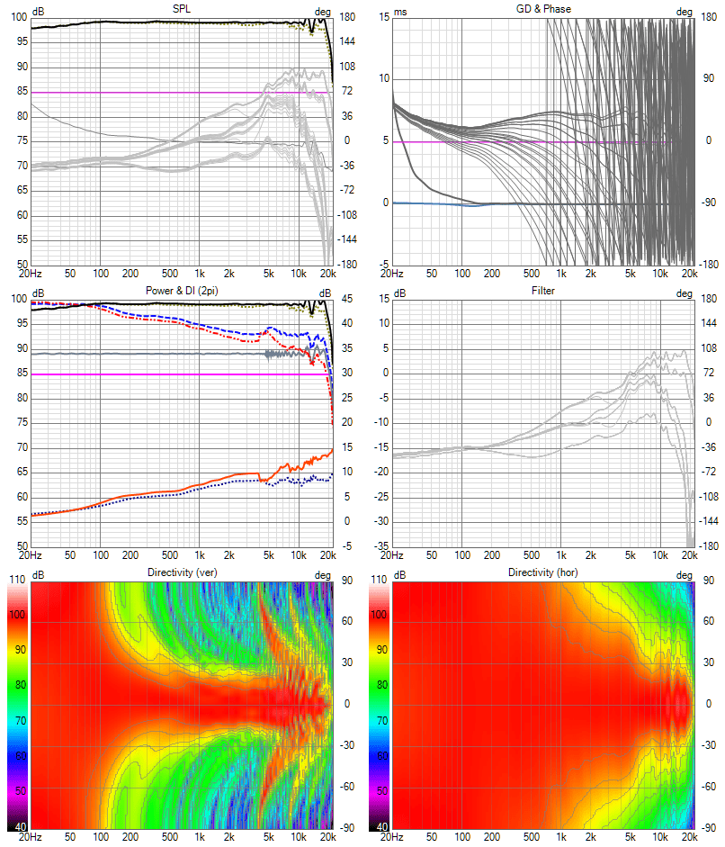

Hi @Rigbaby, short arrays can be very directional at higher frequencies over it's length side, while being wide in the other direction.
Unless you use some type of shading.
See this example of an 8 driver TC9 array:
Sorry, didn't have a shorter array example ready. But it's easy to spot the differences in horizontal/vertical directions.
If you could use that behavior to your advantage, it might not be a bad idea.
Edit: I found one with 4 drivers:
See how it almost acts like a needle at higher frequencies? That makes it hard to be practical. Unless you shade them or use a Bessel type array.
(horizontal it will act the same as the one above it)

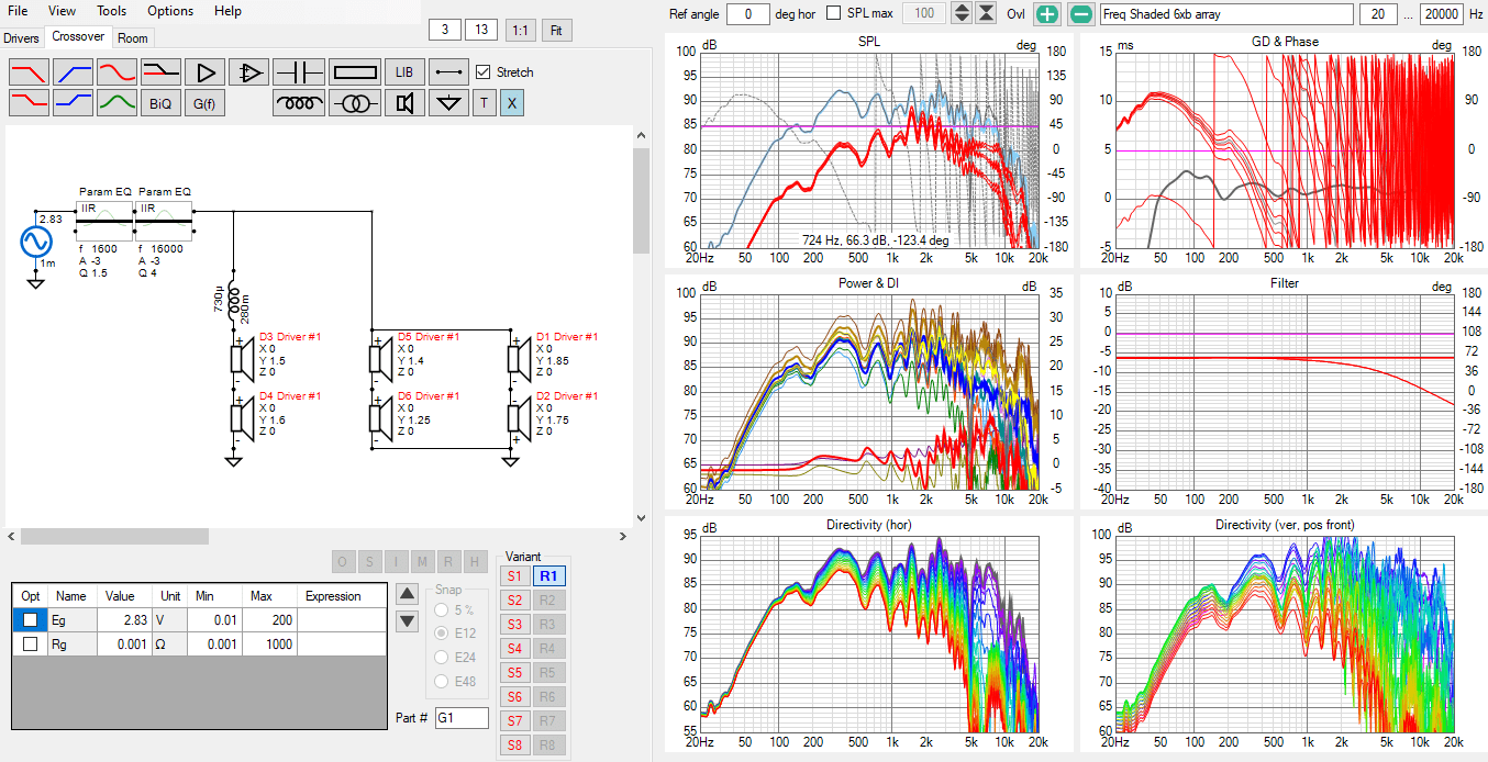

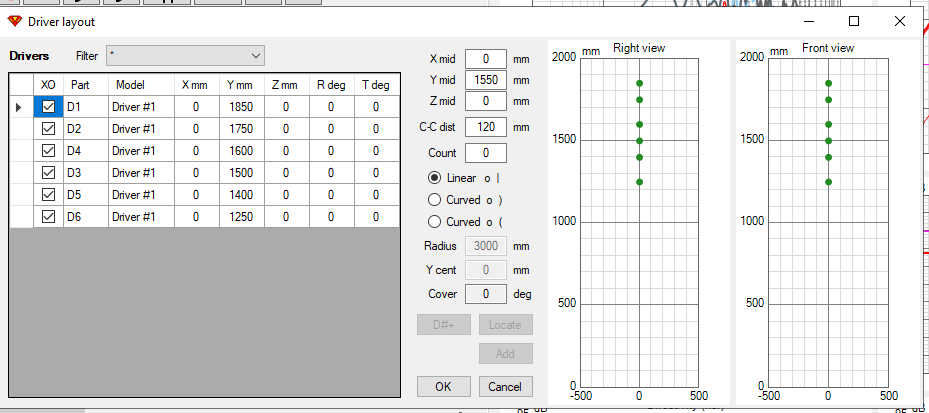

Thanks for the response, I really appreciate your help and info! I recently picked up 12 of the TC9FD's on a pretty good deal and plan on getting another set as time and deals allow. I used your template to try a 6x arrangement that looked okay, but wasn't sure if it would be a wasted effort at that length. The limitations you referenced for the directivity is something you have mentioned in prior posts and it got me to thinking about a 5.2 mid height atmos setup where the line limitations might be used to 'shape' the height channels.
Here's a screenshot of the 6x, super new to the program so feel free to chime in if this isn't headed in the right direction 🙂
Thanks!!
Thanks!!

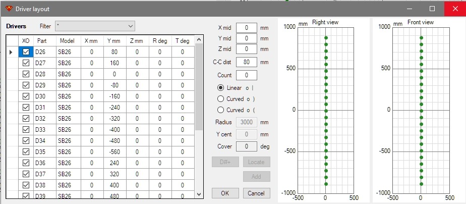

What's the dimensions, in inches? If it's in mm then the drivers wouldn't fit the baffle 🙂.
(if you right click in the schematic window you can choose: driver layout)
Can't quite figure out why driver D2 is connected in opposite polarity.
Here's an example of a driver layout with 80mm center to center spacing. (made for another thread)
You'd need about 84 or 85 mm center to center for the TC9 to make them fit.
Sure thing - I went with 100mm to 150mm spacing for the drivers (3.93", 5.90"), and tried to move them up to where they might be placed on the wall using the driver layout tool. The driver polarity was something I picked up in another thread here (Patrick was looking at bessel array's and the effect of a polarity flip on the vertical and horizontal responses).
Here is the layout:
Here is the layout:
So it was a Bessel after all, except at low frequencies, well, aside from the inverted driver.
