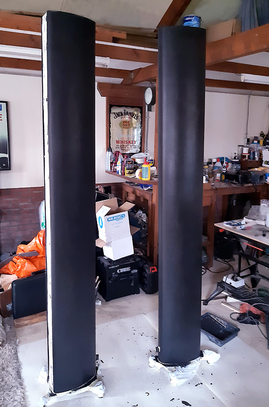

First batch is just a clean (but colored, black) coat applied with a brush. Did not take any pictures of that, it looks ugly.
The second coat is applied with a roller to get that textured look. I added micro balloons (about 15%) for just that bit of added drama.
Yes it looks kinda like Duratex coating but I couldn't get that locally.

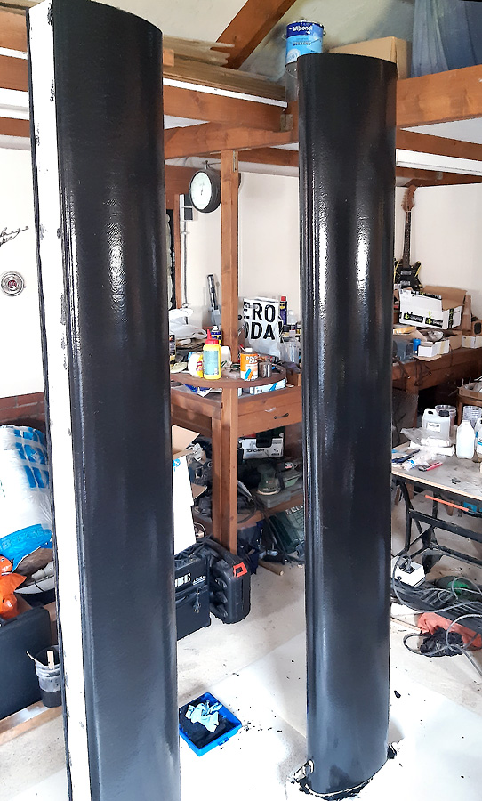

Hard to see due to the shiny appearance, but I'm not quite done yet. I will do at least one more cover of epoxy. The coats are quite thin as is, I'll add a bit more micro balloons and do one more coat. (not unlike what I did with the subs in hindsight)
I have plenty of epoxy left, but I'll have to sand this coat before I can lay on another. Almost there, but not quite yet.

Not being satisfied resulted in hard work after my regular job. I had to pick up a few items from the store, sanded down both enclosures, gave them a good rub down to clean them with acetone.
Next I mixed the epoxy with 20% micro balloons, making it much thicker overall. The end result seems to be much better, will have to wait how it cures, as that is where the previous coat sagged a bit, showing the irregularities underneath.

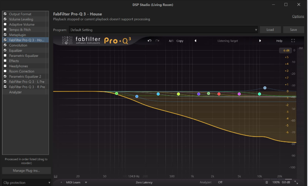

A bit OT maybe but... if you have ended up with a really linear FR but now you would like to att a tilt... say from 100 Hz all the way up and + 3dB at the top... how to go about that?
Thanks! I did try that. I see a bit of a wavy response for that but I suppose its the best option!!
but not the only option. you could use REW auto-eq to a target curve that you customize with RePhase

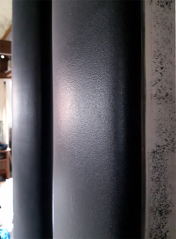

Here are the pictures of the coat from last night.
That's what I wanted to achieve. I can be happy with this result.
All it took was using more micro balloons to better hold the shape.
I've used something similar, just not the auto-EQ part. I can always get a better result by choosing manual EQ.
It's not part of my FIR filter, I use an (P)EQ bank in JRiver to shape the room curve.

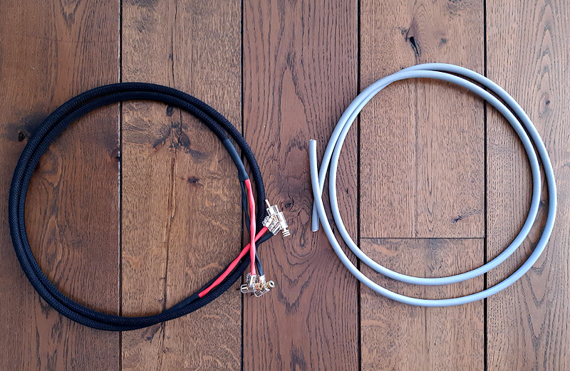

I'll start on getting the newly ordered Canare 4s11 wiring into shape. Also get the other baffle in order and some other small stuff. Still lots to do before I can call it finished, at least I'm getting closer. Another test of my patience 🙂. I do know I'll get there, some day.

If you use a number of shelving filters spaced an octave part set to a Q of 0.7 then the gain will set the rate of db/oct tilt you desire. I do this as part of my processing. Image below, I added an extra couple of filters and changed the Q in the bass to get a different slope but it would have been a straight line without that.A bit OT maybe but... if you have ended up with a really linear FR but now you would like to att a tilt... say from 100 Hz all the way up and + 3dB at the top... how to go about that?
