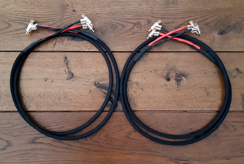

I never went past the "cable I had on hand" so I figured with all the upgrading I'm doing it is about time to dress up that part as well.
Personally, I wouldn't be surprised if cables "could" make a difference in a setup when reading the old Nelson Pass paper, but discussing it always seems to lead nowhere.
As demonstrated I had some cables ready to go until I figured out all my connectors are of the gold plated variety. So the tin plated cables in combination with gold plated contacts did not make sense (to me). That made me go with the star quad type of cabling, as it would give an opportunity to see/hear the difference between them (if there is any) and the old figure 8 zip cord.
I'll have a pretty full schedule of things I want to try, once the speakers are back in action. The test of cables wouldn't be high on my list of things to try. However I do remember koldby being fond of coax type cabling, which would have an even lower inductance. He has proven it to me to be right about the fact that amps do sound (appreciably) different, so I have no reason to doubt him in this matter.
If we can keep it civil, I am open to hear opinions on that matter. I just don't want to derail things as wire debates often seen to trigger. I'm interested non the less, as the figures shown in the Pass Labs paper left me pondering without coming to any useful conclusion.

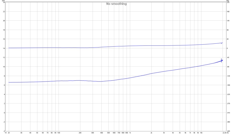

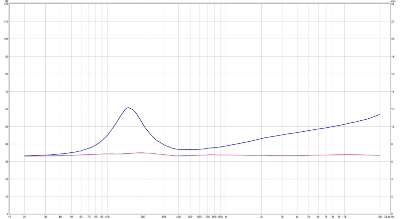

As I've had a full conjugate network, rendering my speakers impedance flat, and hearing the difference with the high end compensation and without it (rising impedance on top) I could never come up with a good explanation of why I preferred not to compensate the rising top end. I definitely heard a difference. I kind of expected to prefer the compensated top end, but didn't. So much for bias.
attachment.php
Comparison of uncorrected an corrected impedance
attachment.php
Top end compensation removed, as I have been running for years
** Listening impressions with full compensation were as if the top end was overly damped. Not as lively. Restrained would be a word to describe it. Both situations, with and without compensation were measured and corrected with FIR to have the exact same FR response. **
Is it risky or could we talk about this in a civil way 🙂. I know/realize its controversial. I should not have heard a difference with the full conjugate network or without. Unless the amplifier wasn't doing what it should be doing. This was with the Pioneer. I never repeated it as I had removed the top compensation and left the rest in place.
With the extra filters added to my arrays, I need to find out if I want to re-adjust the conjugate that is left or just leave it out completely.

May I suggest that you define your parameters before you ask for opinions or comments on wire?
Otherwise you are getting into the "tunable" cables and biased electrical field cables and such, which I am sure would not add much to the intended discussion.
True... it isn't my intention to go there. My cables are 2.2 meter, and it makes me wonder if there would be (enough appreciable) differences in the more elaborate wire constructions that lower inductance even further while keeping the capacitance in check.
I also wonder if I should rebuild the impedance correction circuit, as much has changed (with the addition of sub-woofers). I think I'll start without and try and modify my existing correction if I get curious enough. If I do seem to have a preference for the impedance correction, I'll build an updated new version that I can place out of sight behind the arrays.
If you say no good for the top end, the KK 8PR, what was it that didn't suit your needs? They seem to have lower than usual inductance (due to the braiding) while keeping capacitance at reasonable numbers. (link).
KK 8PR - 90pF/ft - .041uH/ft - 11 AWG
Canare 4S11 - 16,7 pF/ft - 0.10uH/ft - 11 AWG (link) The capacitance figure seems off...
or
According to this measurement. Canare states 45 pF/ft which seems about right compared to the Kimber numbers, Kimber gets roughly double the capacitance, half the inductance due to construction of the cable.
"If you say no good for the top end, the KK 8PR, what was it that didn't suit your needs?"
Comparing 20 ft runs on each side (when I had central amps and long speaker leads) myself and a friend listened to KK 8PR and 8TC. For whatever reason, which I won't pretend to know, the TC line tfpe insulated cable sounded more life like.
Then we switched it out with KK bi-focal cable and it was night and day difference. But at 5-10 times the price it better be.
Again, law of diminishing returns.
Better to have long pre-amp leads than speaker leads.
Canare's quadstar mic cable works fabulous for the money. Can't state that enough. But again I tended to prefer the twisted, 22ga., three conductor, tfpe insulated, Silver plated copper with overall screen(shield) cable.

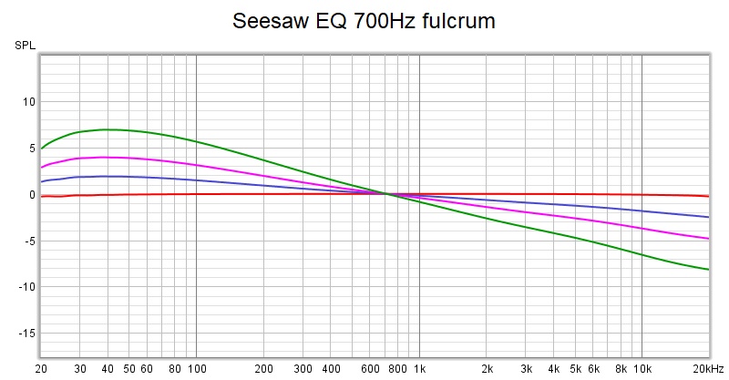

If you use a number of shelving filters spaced an octave part set to a Q of 0.7 then the gain will set the rate of db/oct tilt you desire. I do this as part of my processing. Image below, I added an extra couple of filters and changed the Q in the bass to get a different slope but it would have been a straight line without that.
Cool Fluid,
I do the same thing, and have also found a Q of 0.7, works for a series of shelving filters spaced an octave or two apart.
I used to do this in rephase with linear phase shelving imbedded into the FIR file. But that of course has the downside of locking in a fixed tilt.
When I finally noticed how little effect an IIR shelving series has on phase, I moved to an IIR series on the input, that effects everything pre-xovers, and allows easy real time adjustment.
Maybe the only thing i might be doing different, is i like a seesaw-type tilt that hinges on a fulcrum close to middle of audio spectrum.
Below are measured processor traces of varying tilt, fulcrum around 700Hz.
What i really like about the current setup is that the displayed curves and any tilts in between, are continuously available from twisting a single knob.

For me IIR/minimum phase is the right choice, I want the phase to change with the magnitude for this.
That is probably due to the level, I tried a flat to 1K and tilt after that and it sounded better the louder it was. Mitch uses something like this along with Jriver's dynamic EQ to boost low frequencies when listening at a lower level. The pink trace in your graph looks pretty close to what I use.

The flat to 1k then diving response is what i use too. Was first introduced to it after reading some B.Katz post about it. Worked great to me. I use a 0,5db/octave attenuation and 'straight' line attenuation ( thanks to Mesa eq in Dolby Lake). From Katz's explanation it mimics the behavior of air/instrument interaction iirc. For my own preference it is the most natural sounding correction with my mains and rooms they where in. Could be different with different room and loudspeakers. Second best is B&K curves to me.

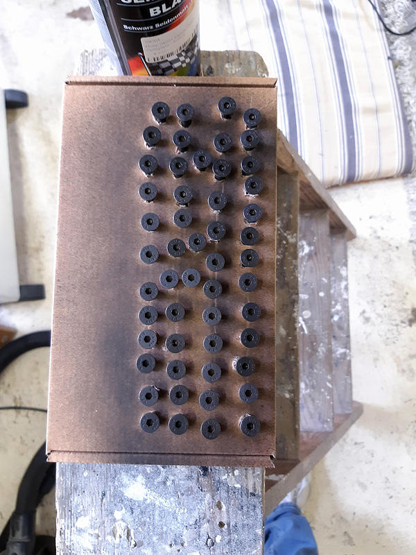

A little make-up on the bolts, this is a very light coat of primer...
attachment.php
First sanded them with an abrasive pad, a light coat or two of paint will follow.
Just some light make-up, can't have too much paint in the key hole.
(just the amount of bolts in one speaker shown here)
