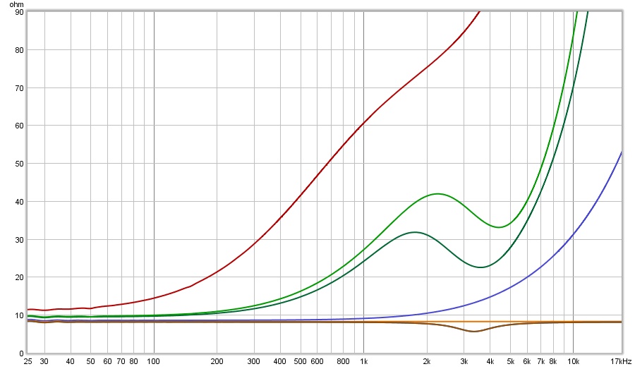

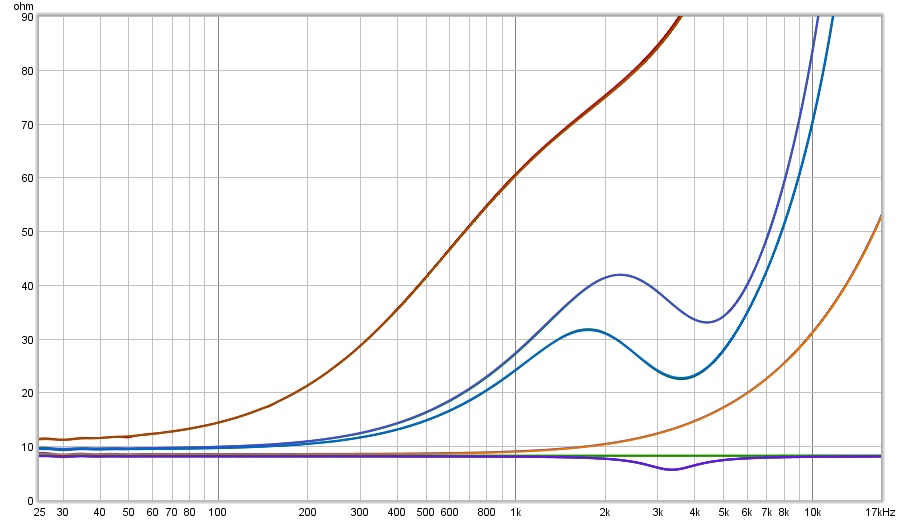

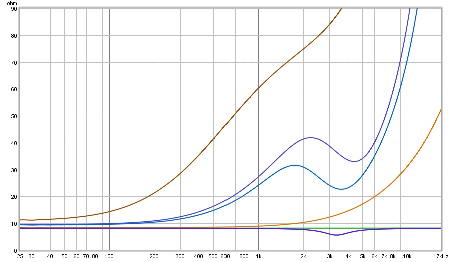

All boards are in, here's the graphs separately:
attachment.php
First array
attachment.php
Second array
Overlayed:
attachment.php
Close enough to call it a matched set...

These are the filters connected with a series resistor used as a control measurement.
(By shorting the driver groups in the array where the driver is supposed to go)
This test shows me I've wired it all up correctly, as it included moving around driver positions within the array to create a superior listening axis.
I have compared them to the same filter modeled in X-Sim to know I have build them accurately.
As the speakers aren't finished yet, I do not have anything other than Vituixcad sims.
On the top graph (first array) the red plot is the 5 top drivers,
The dark green is the second group from the top,
Dark blue is a split group, 2 above and 3 drivers below the central (listening height) driver group,
Yellow is the central group of drivers, no crossover there,
Light green is the bottom group of 5 drivers.
The two measurements with the dip are alterations of the bottom most driver of the 2 bottom groups, making them act more like the top end (a balancing act to create a wider vertical).
Here you can see the impedance plot of the drivers in the array with filters mounted. That's about as far as I am right now. Second one is ready to be closed and checked like that, but I ran out of time.Will have to wait till next weekend.

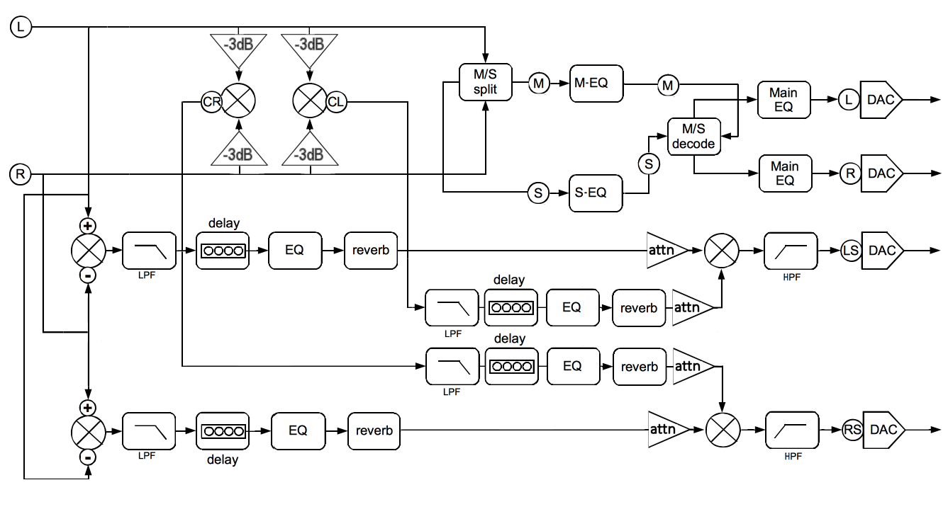

isn't the X in circle symbol used for a (RF) mixer? I guess it should be just an additive mixer, so a plus sign in a circle?
like this:
The circled x does mean multiplication. in these diagrams for audio usually it is used for multiplication by a constant. If the multiplicand were time varying (i.e. a sinusoid) the process would generate IM-like distortion products. In RF, the sum or difference product is desired.
