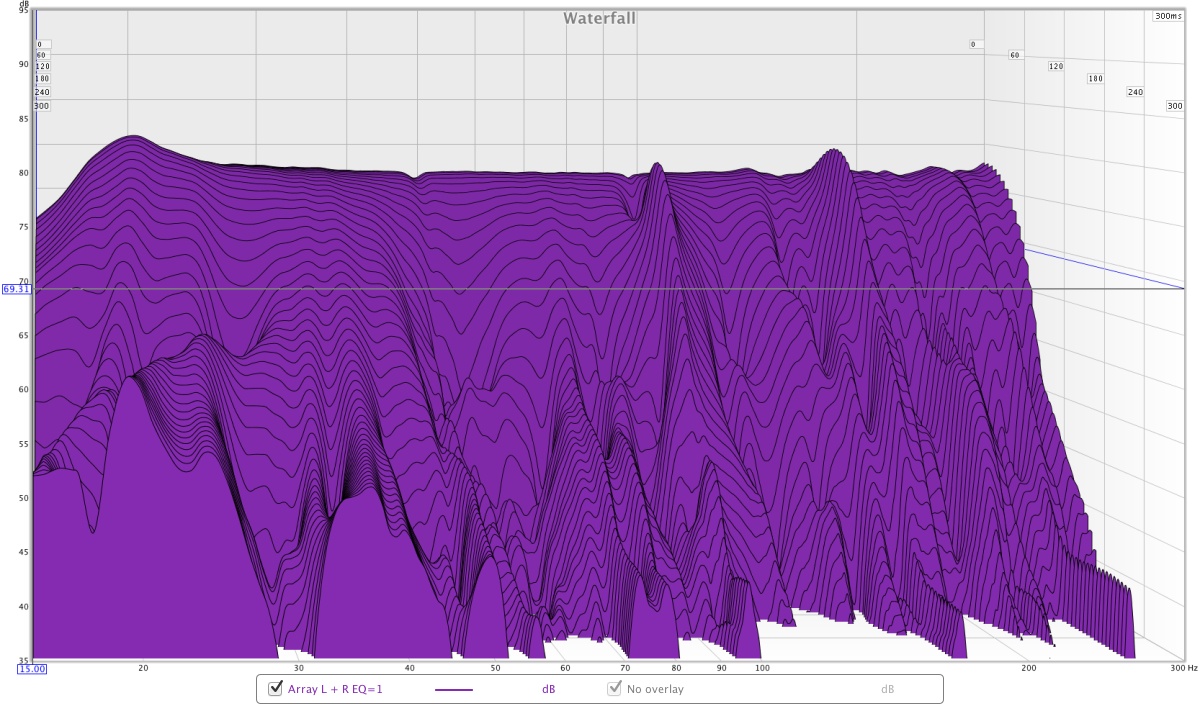

I run mine all the way down to 20hz which they do with relative ease, at the expense of reduced max SPL obviously. However they can be preeeettyyyy loud still 😱 😀 (freq. sweep of mine are attached, Wesayso´s should extend even further having 5 more drivers per side than mine does)
