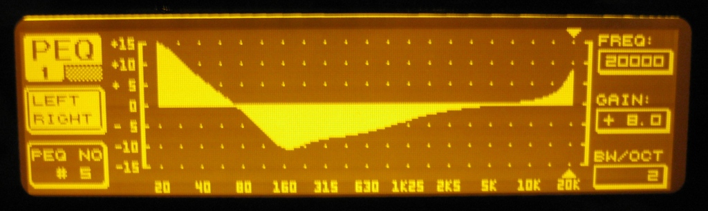

One of my worries with DRC-fir is how to get it to cut the midrange (lots of energy in the ~155 Hz and boost the low end and top end. It needs a lot of EQ to resemble something "looking" flat. Would I have to use a target that is configured/ aimed at lower SPL to get the midrange down or do I need to look into the variables that define the average SPL.
My current EQ curve is based on the published EQ curve of the line arrays from member OPC (link):
It clearly shows what I mean. Excessive energy available in the 155 Hz area and cut there with about 9 to 10 dB. But a 15 dB boost at 20 Hz ( I have max boost, almost 14 dB, at 30 Hz right now and cut off like a HPF below that). I believe the standard parameters in DRC calculate average SPL in the 100 to 10000 Hz? That would not give a good number in my case. I need to get the target (whatever the target might be, that's not the main thing yet) to slice the graph somewhere between 70-80 Hz and 5 KHz. Cutting the middle and boosting both other ends. In Audiolense one can move the target visually over the measured response. Not sure how to do that with DRC. The raw line array is a very different animal from normal speakers before EQ.

With Sbragion's DRC, there is no need to worry about any of that - the filter will boost and cut whatever frequencies it needs to. If you want a response that measures flat in the typical way, bypass the psychoacoustic target stage, and if you want a response that sounds flat, leave it engaged.
The peak limiting start and end frequencies in the DRC config files are 100 and 10000 by default and I think for your system you could change those to 64 and 8192 (they're supposed to be about an octave short of the low and high freq limits of the system).
The real issue for you is the sheer amount of eq boost/cut that needs to be performed. You could do it all with DRC by cranking up the peak limiting max gain to its highest value of 4. The drawback here is that you will be sacrificing 4 bits of resolution just to level the Line Array playing field (not necessarily the end of the world). The other option would be to invest in a professional analog stereo constant-q graphic equalizer, dial in your Line Array compensation curve, and consider it to be part of the speaker system. You would be starting out with a fairly well behaved system before you even run your measurement sweeps.

That last bit of advise would be similar to what I was originally planning to do. EQ first (I'd still like to do it digitally from within JRiver or a plugin within JRiver) and then let DRC sort the rest out. If that works out I could experiment with the different curves or config's. Only need to figure out how to run the sweeps trough JRiver or do that manually with REW or Audiolense. If I have the time I'll do it both ways. I can run Audiolense in Demo and convert 90 sec of audio to get a feeling what that would sound like.
Lot's to experiment with. I'm set on measuring afterwards with filters engaged to see the differences in results anyway. It seems like a fun learning experience. I just looked into the erb config files, one of the main difference is the different frequency dependant windows. Seems short though at 20 Hz. Normal config has a 500 ms window (10 cycles) at 20 Hz comparable to the Audiolense settings Bob Katz went for, while the ERB has a very short 65 ms window at that same frequency. Hardly more than one cycle at 20 Hz.
