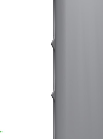

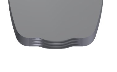

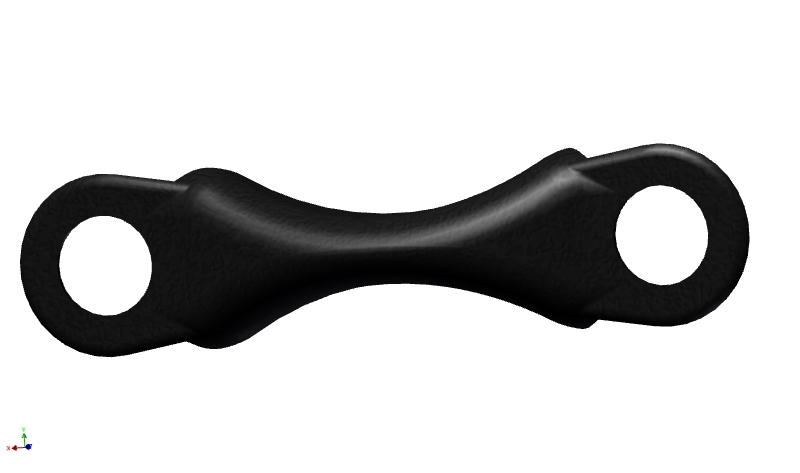

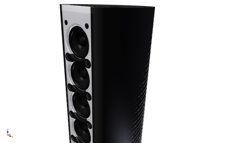

Did you see the effect at 4 KHZ of that measly 6mm chamfer in front of the baffle?
This is another 6mm on top of that, creating a steeper angle.
I wouldn't want to bet on it, without testing...
But first I have to see if I could fabricate it as an add-on:
attachment.php
attachment.php
attachment.php
An not make it look out of place...
It is at 4 KHz and above where I want it to have an influence.

Uploaded as a printable object online it is about 10 euro a piece 😱.
For that money it should better work wonders! No doubt testing it could be done with easier and cheaper with filament printers, but they won't have the resolution and versatility of SLS printers or Multi Jet Fusion.
But for that kind of money I could make entirely new front baffles.

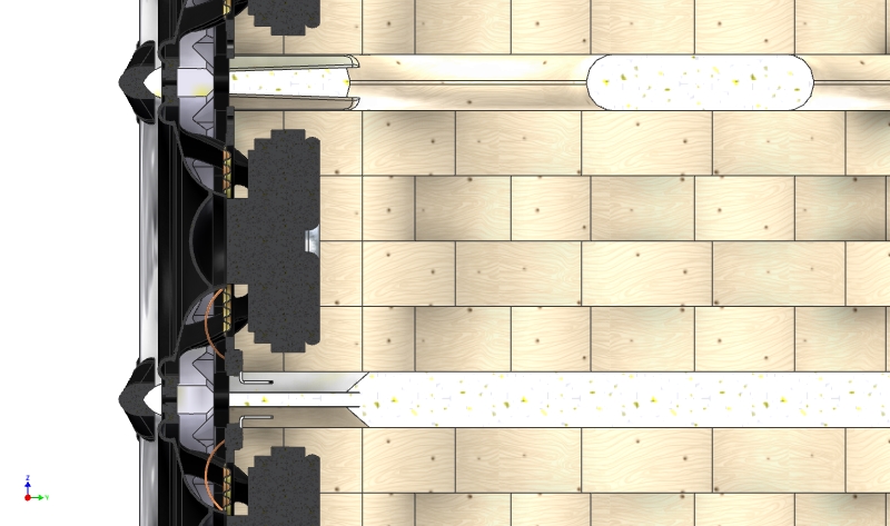

OK then, one more view:
attachment.php
To show the differences in dimension.

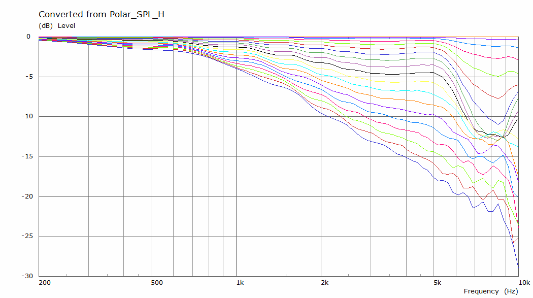

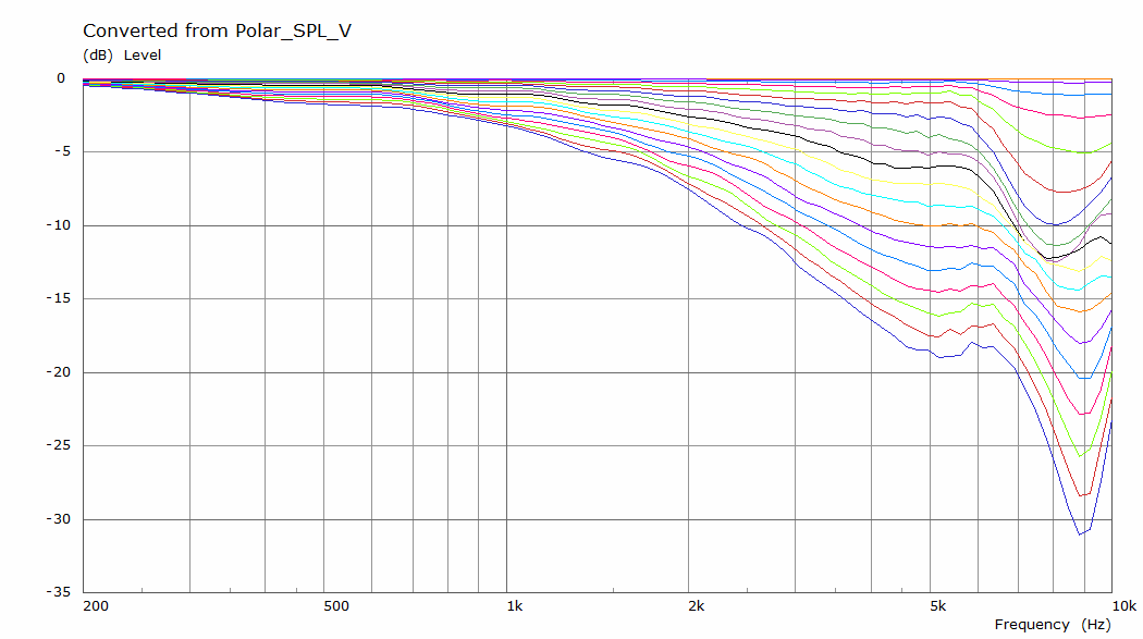

Above 4K this tweak is only meant to limit vertical dispersion (bring off axis down in the vertical direction). I don't see how we could improve the dispersion of the top end, as a full range driver will have gone to non pistonic behavior there anyway. And it isn't that bad at angles of interest to cover the listening area. I did think of a circular phase plug like compression driver has, you know, similar to what Geddes developed quite a while ago. But that would be a real long shot (lol).

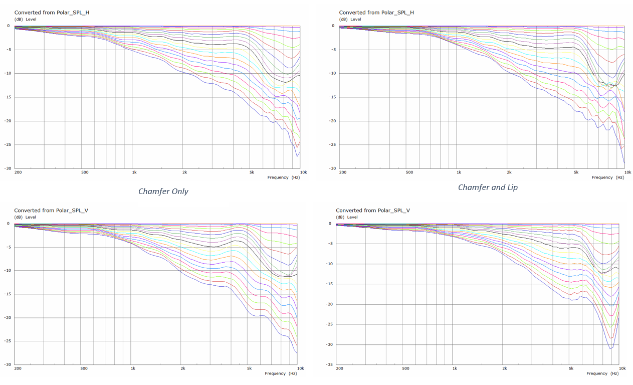

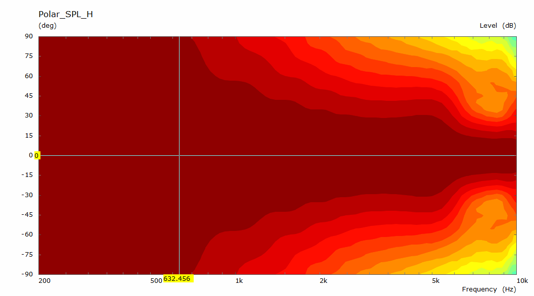

Here are the simulation results for wesayso's lip idea. I think it has some merit. It has made the vertical more similar to the horizontal removing the big bulge at 5K which may have been partly responsible for the ceiling splash horns seen in the vituix sims. It has made the Horizontal slightly worse off axis above 5K.
Comparison included below to make seeing the effect easier.

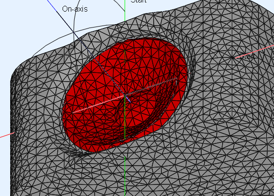

Thanks for running the sim, fluid. Kind of cool to see it working as expected.
A bit sad to see the influence on the horizontal dispersion from this tweak, though it isn't worlds apart.
The trend in off axis response in vertical direction works for almost all of the off axis energy around 4K (a reduction even in the widest of angles), so it might be worth it to be able to reduce the floor/ceiling spray. At 5K and above it does not seem to hold this up though.
I guess I'll have to find some CNC power if I want to create a baffle like that. That would be next to impossible for me to make/create manually with simple tools.
Some optimization might be possible, I guess I really do need to learn to do this myself with ABEC. 🙂.
I don't think it is the lip that is causing the change in horizontal directivity, I think it is the small step that is in this simulation but not the other. When I edited your CAD file I made the chamfer flush to the surround, in this one that you made (that matches your own baffle) the step is there.
If you want to test that then I can rerun the sim if you send me a new quartered step file with the surround flush to the chamfer.

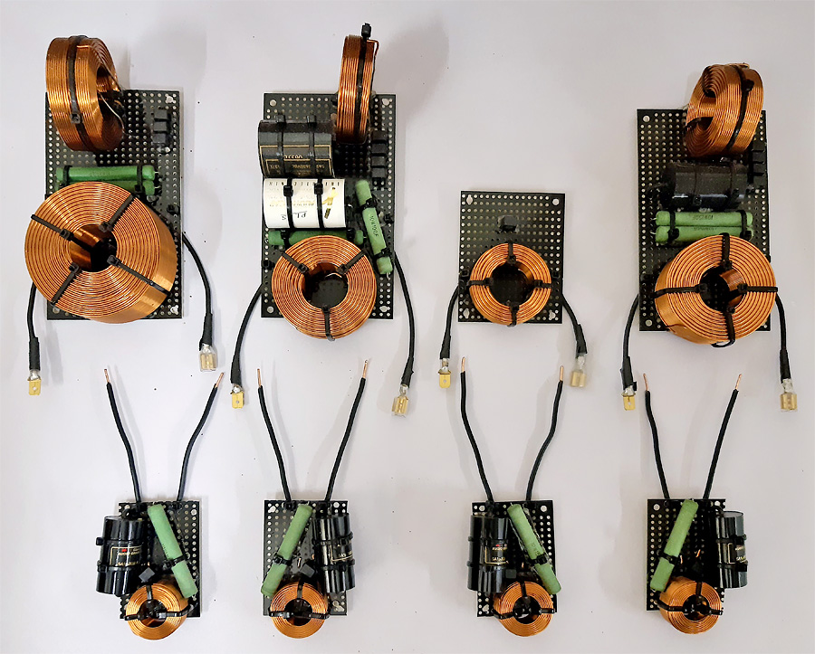

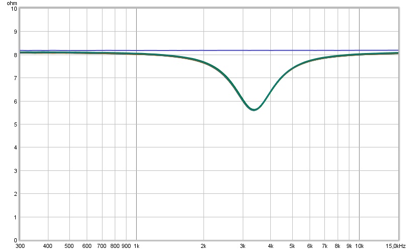

Finally some good weather over here, so I could pick up some work in the garage again. The bad thing is that the extensive break had me going nuts with extra simulations, so I made up a few extra filters, as mentioned earlier in this thread. A few bypass filters that go in parallel with only one driver in a string of 5. So instead of finally closing up the first array I was actually making more filters...
The 4 extra filters (2 per array), below the first set of filters for the second array:
attachment.php
and their impedance measurements against an 8 ohm resistor:
attachment.php
(that's all 4 of them + the resistor, good enough quality control I'd say)

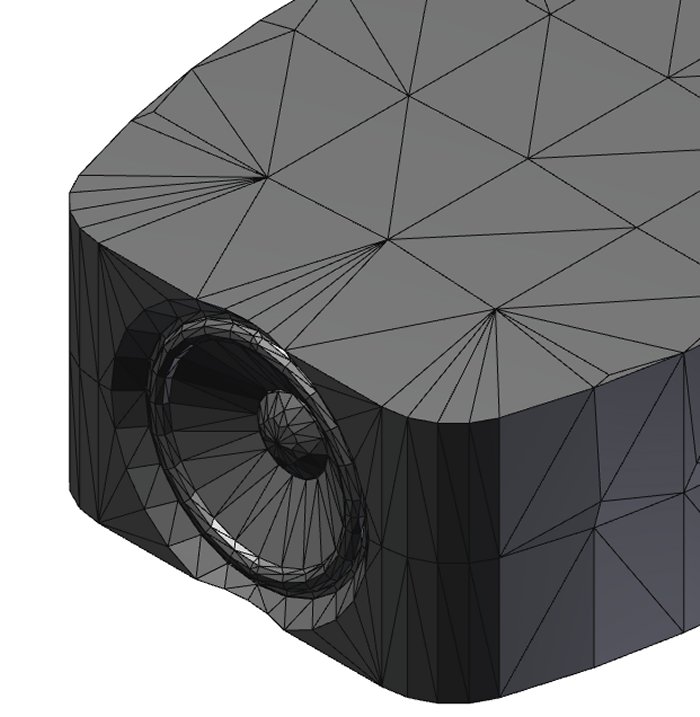

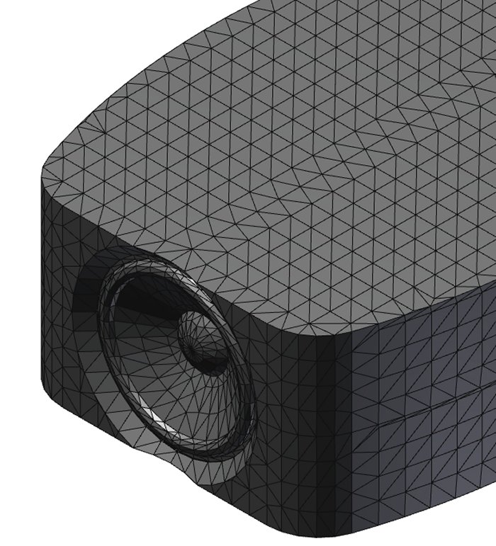

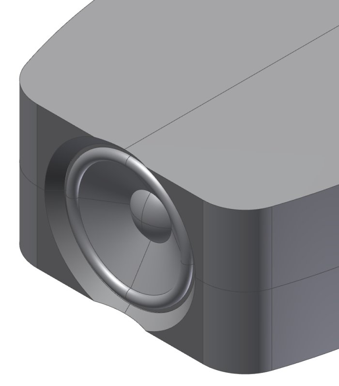

Question for fluid,

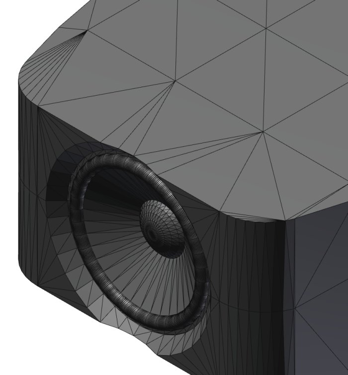

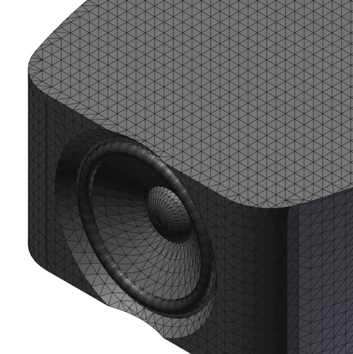

I read a lot about the meshing of objects and ABEC can read stl.
Depending on a couple of variables I can let Inventor decide where the triangles should go. I won't have total control, but it seems smart enough not to divide the larger area's into smal triangles.
Here's a more standard way to mesh as stl:
attachment.php
mesh size set to ~5mm edge length, the deviation (another variable) determines the number of slices to use for more complex shapes.

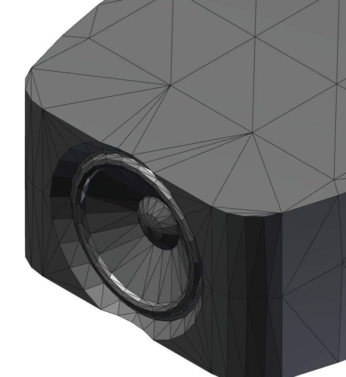

So even if I set the edge length to something like 50mm:
attachment.php
Due to the surface deviation allowed, it will divide large flat faces into big pieces, and only use smaller ones to be true to the original shape.
This deviation setting is limited though. it varies from 0.003595 to 0.3595.
There are two other variables left that also determine the end outcome, but I'd have to guess what it is they do.
Would this help? I see a lot less triangles in the second example, except where it counts to stay true to the original shape.
Edit: just played with the "normal deviation variable, this one allows to create even simpler shapes decreasing the triangle count further.
attachment.php
All of them are sliders, though with limited choices.
The first one will work the best but there is way too many triangles for the surround to deal with the curvature, for a one off you could let that run and it would give good results but it would take a while.
The third one is about right for the surround but the main panels have quite large triangles.
The edge length needs to be kept below 20mm and ideally 10mm for the front baffle in order to have valid results up to 12 to 15K. Beyond the front it matters much less. Sometimes you can mesh it in two different densities and save them separately and only call specific faces at high or low resolution. That only works for square corners or rectangular surfaces of which you have none where it might work.
